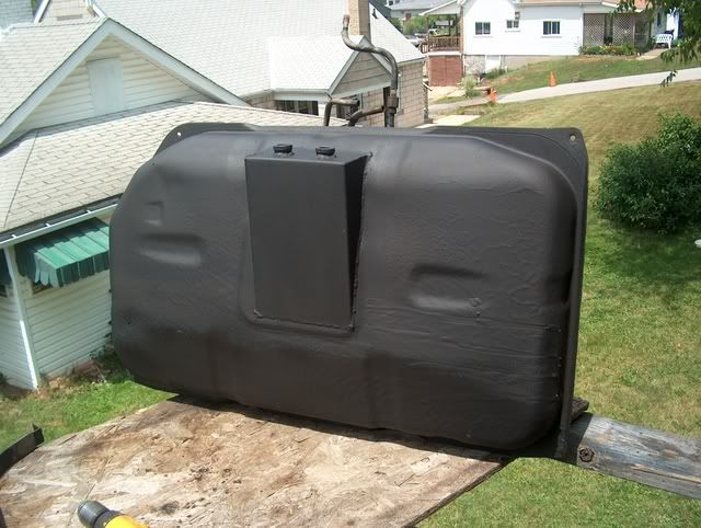

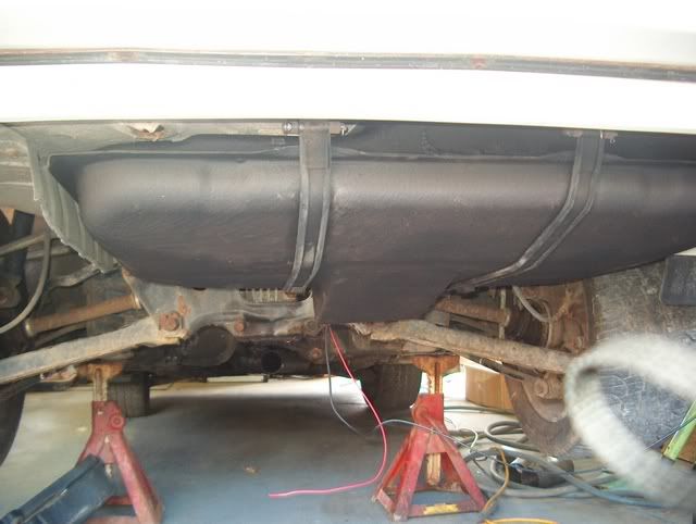

Today i cleaned my gas tank and put it all back together then primed it ,Then i sprayed it with 3M undercoating.
After it dried i put all the rubber bumpers back on it.
Then i installed it.

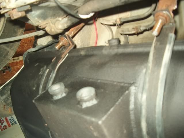

This pic is for reign maker (Jake) i got plenty of room for my top of tank return.

OH, ok, now I see... You put the sump facing forward... That's pretty cool, you should be fine, just dont let your tank get less than 1/4... Remember, when you take off, that gas will slosh back, so keep enough in there... If your fuel line goes dry, it will kill your pump... Speakin of pumps, which pump are you goin with? Where are ya gunna mount it?

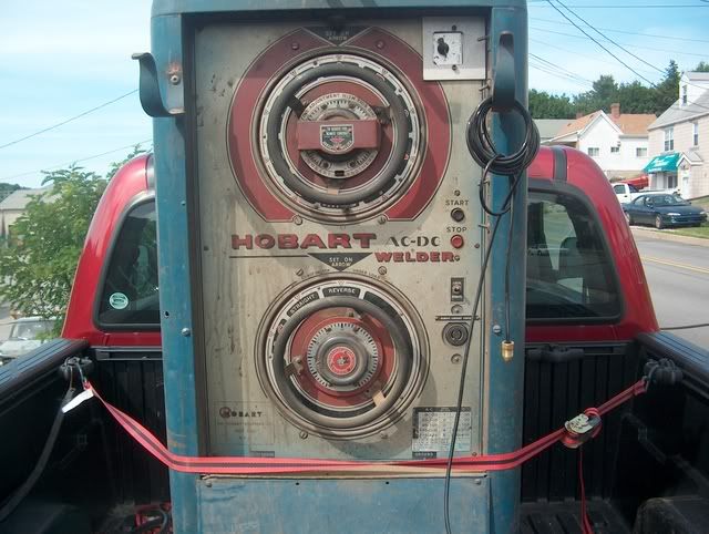

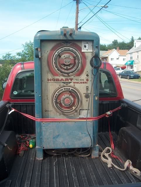

Well i bought a 300 amp tig welder on ebay and i think i got a great deal, ( $299.00)Today i went to pick it up 5 hours away and the guy showed me how it worked , Now i can do alum, stainless, arc. I love to buy tools this is my 4th welder lol, I have a mig ,ac arc, dc trailered with 6 cyl. ford engine, and now this tig welder.
