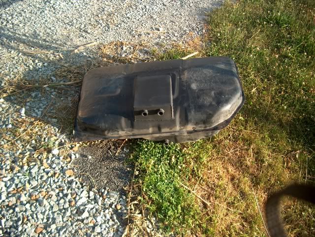

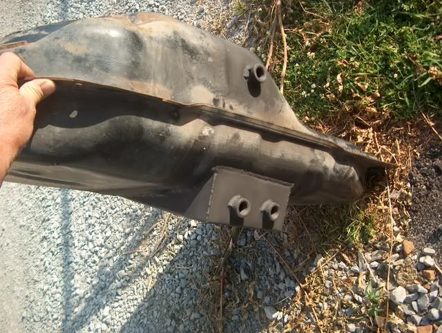

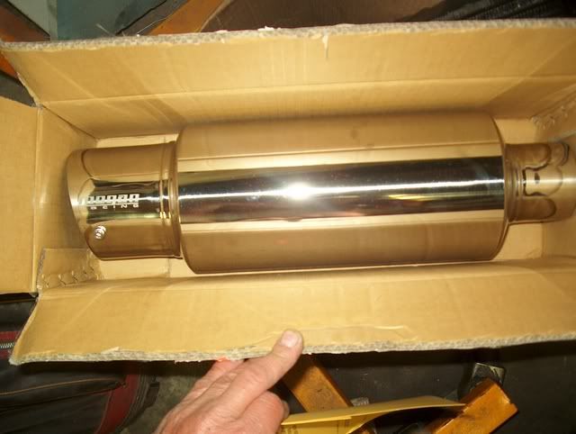

Well i got some shit to add to the Money pit.LOL
I got a sump welded into my fuel tank.
And i needed this too .:icon_razz
Plus i thought my neighbors would like this.
And the f--king state wants this .LOL

Sump looks good man... Im a little concerned about the return location, I hope you have no trouble plumbing that... *with the space for the AN fitting* I just used my stock return inlet... Are you doing a dual feed?
suprahooked
Built 7M
Jun 20, 2006
1,160
pa
Thats is why i had him put the extra bung in (duel feed, drain, or return)
I would like to have the return in the top of the tank but not sure if the plumbing will work.
mk3forme
1,022
Lexington KY

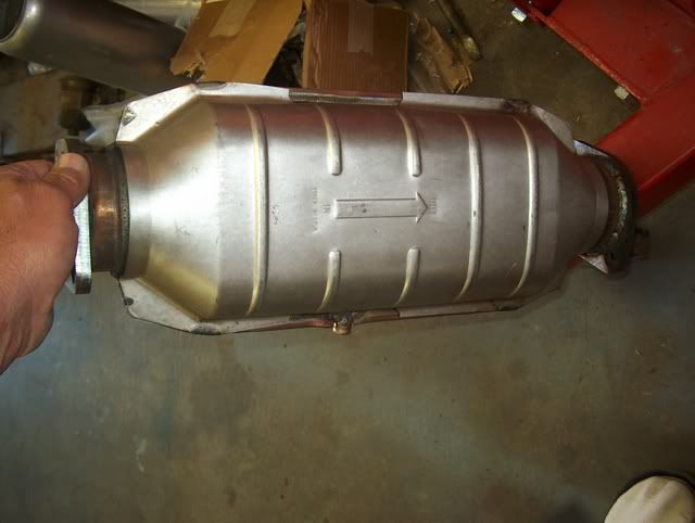

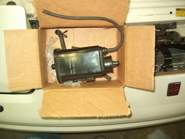

Looks good John. Im assuming that is a high flow cat? Where did you get it and how much. I have seen several on ebay but none with the bolt flanges like yours. They all had to be clamped or welded. Also what is that black thing the state chooses you to have?
