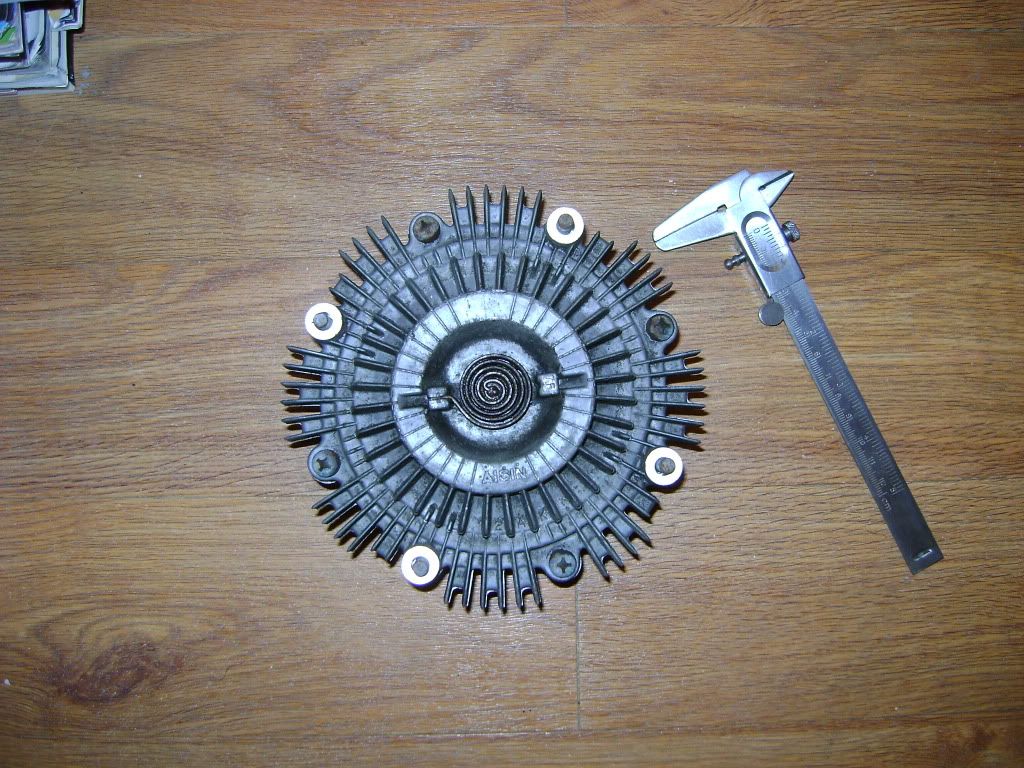

I recently picked up a used Turbo Fan Clutch to rebuild. My question is I've heard that Turbo fan clutches are supposed to be bigger is size compared to N/A fan clutches. However from the pile of fan clutches I had to choose from I compared the turbo fan clutch I got to a N/A clutch and noted no differences what so ever. Other than the 10 blade vs 7 blade and the colour on the mounting portion being different (blue for non turbo and orange for turbo) I noted no size difference or any difference at all as a matter of fact. What I did find though was a few other turbo supra owners I was with at TX2K10 who had purchased new Toyota fan clutches. Those clutches they bought were bigger in size and had more fins on it than the turbo fan clutch I had. Did Toyota redesign the fan clutch for the turbo supra? Mind you I went through a pile of about 5-6 fan clutches and I found N/A and turbo other than the colour they weren't different.

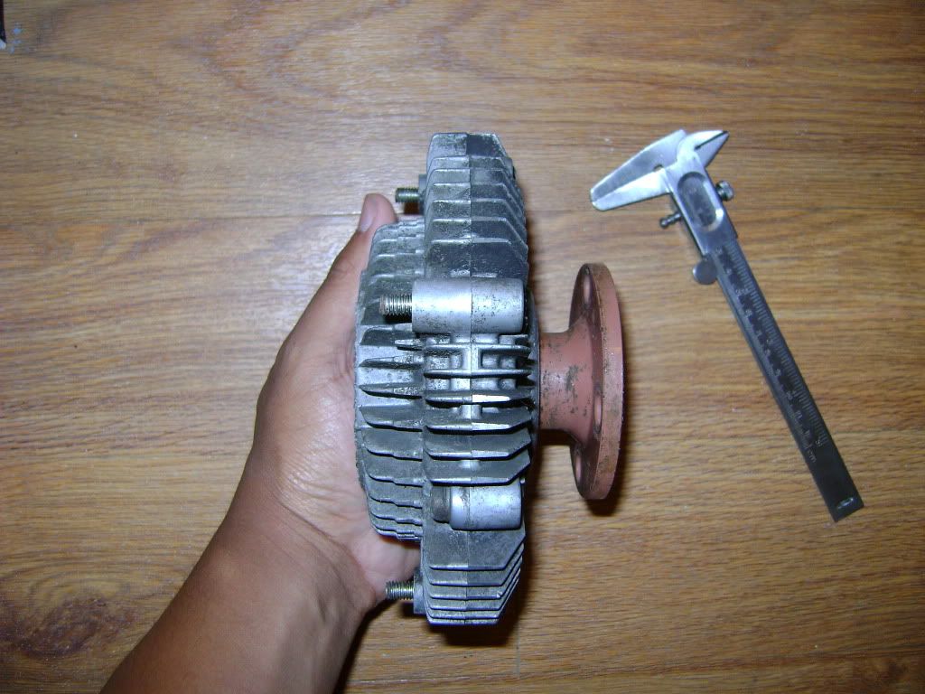

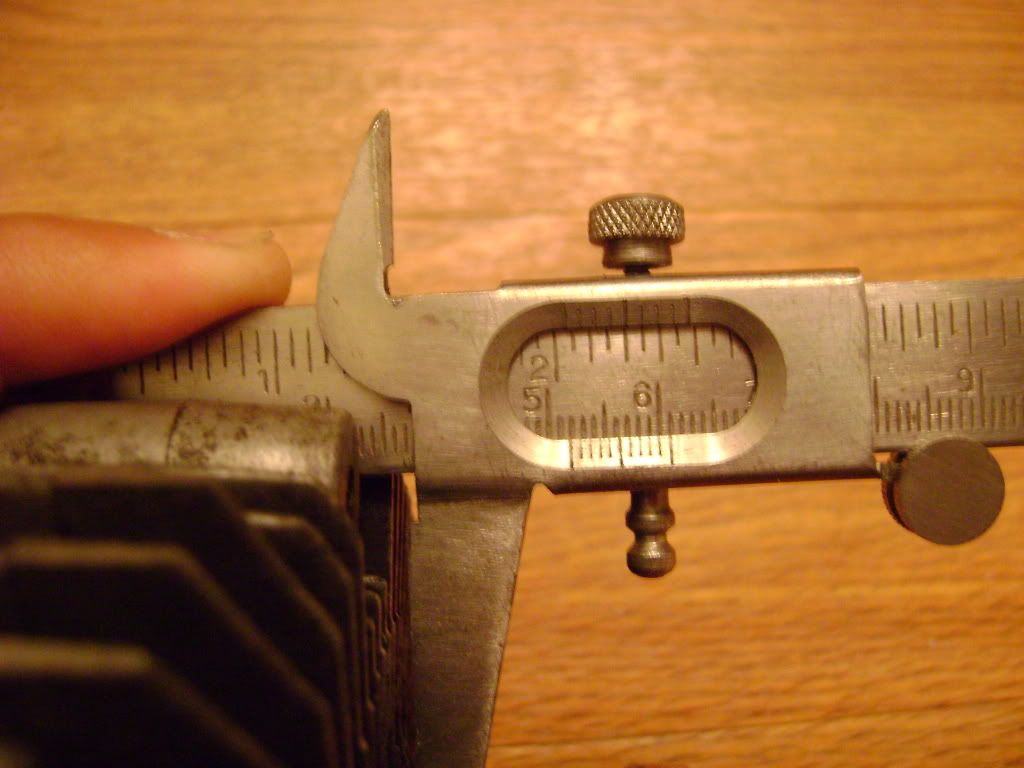

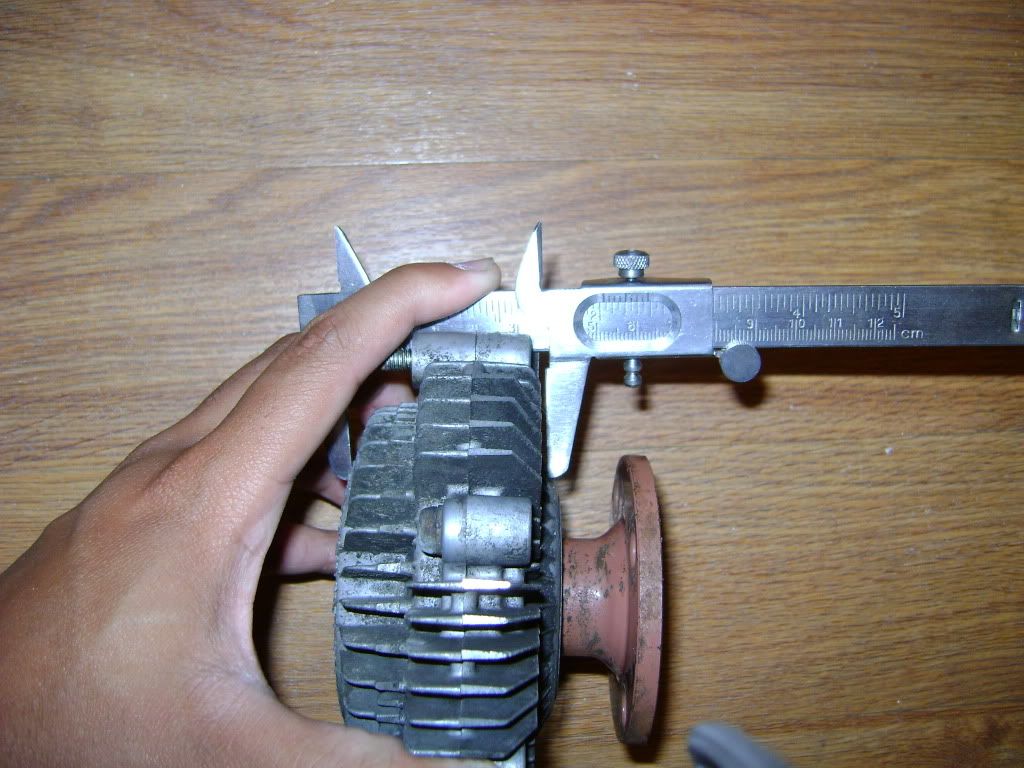

I got pics of my Fan Clutch i got off the 7MGTE you can see it has the orange part.
For the second measurement its 160mm across

My Autozone replacement thats on my car right now is smaller than this clutch in the pictures. I was looking at every Supra Turbo at TX2K10 and they all had the same clutch posted in the pics. Except for the ones that bought a brand new clutch from Toyota. Like i said those were noticibly different. I am curious though if Toyota did redesign the clutch or listed a bigger clutch under its P/N?
