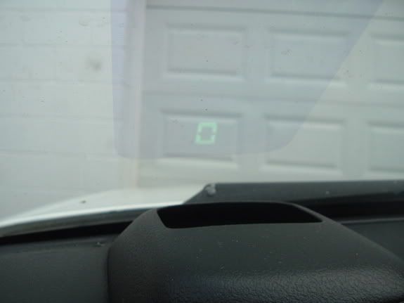

Just read this whole thread, very pimp. Quality work by both of you. I wonder if you could get the HUD from an S13 to work with it.
No problem, just would need wiring diagrams from the s13 hu. What does one look like anyway?

Two quick pics I found.

That s13 display unit looks wicked! I would want the whole hump it is shrouded by. I feel it would be simple, just a splice job into the wires for the digital speedo on the cluster and bam! It would read out to that unit also.
From a Nissan 240sx.
Hmm..
s13 display ??
Where can you buy this one? And then again the question about the wiring diagrams ..
I am degree to use other Nissan parts...anyway

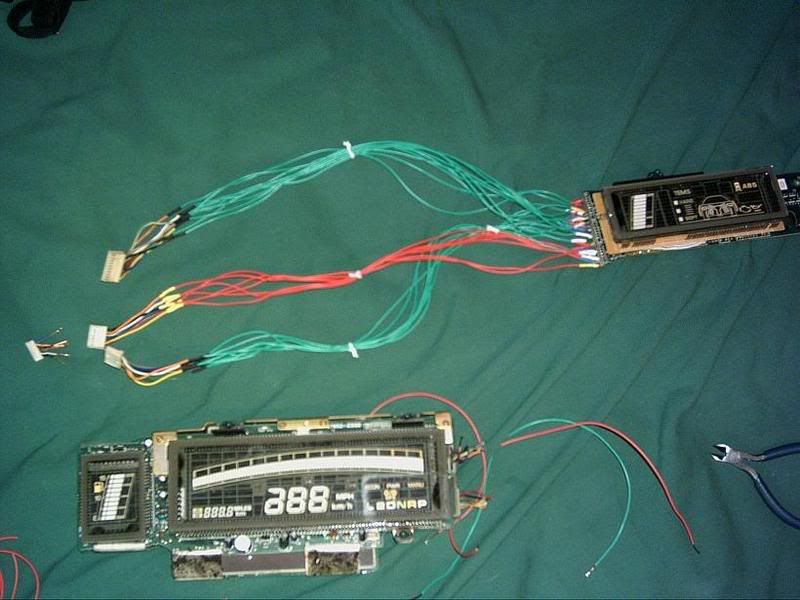

That's the hardest part, keeping it looking pretty much stock. I almost hate it :p I did a tiny bit of work on it just now bwfore work, I have to do the face plates that go over the digital units and that hold the dark acrylic over them. I also have to fiberglass the signal strip into the bottom of my cover plate, the strip with the signals, seatbelt sign, etc... It's not something I look forward to as the pieces are only fitting somewhat well heh, not everything lines up perfectly but that's not a big deal.

I am missing some display module as my cluster only came with 3 sets of bar displays, however, I do have a boost display in one of those 3 there :p I know because on the clear acrylic it says boost. I do believe it is the one on the tems unit. Also, in that pic you selected, there is one missing which is just a small board with one bar display module on it so that could be it also. My other pics show this one I speak of.

Yeah, Ihad discovered I was missing the oil pressure display unit a little while ago, and it was somewhat of a dissapointment :( I would have to do some more re-wiring to get that display unit to work and i don't feel like it right now tho hehehe. Maybe at a later date i will include it but for now I'm fine without.
