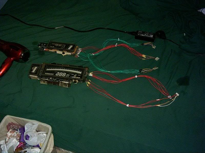

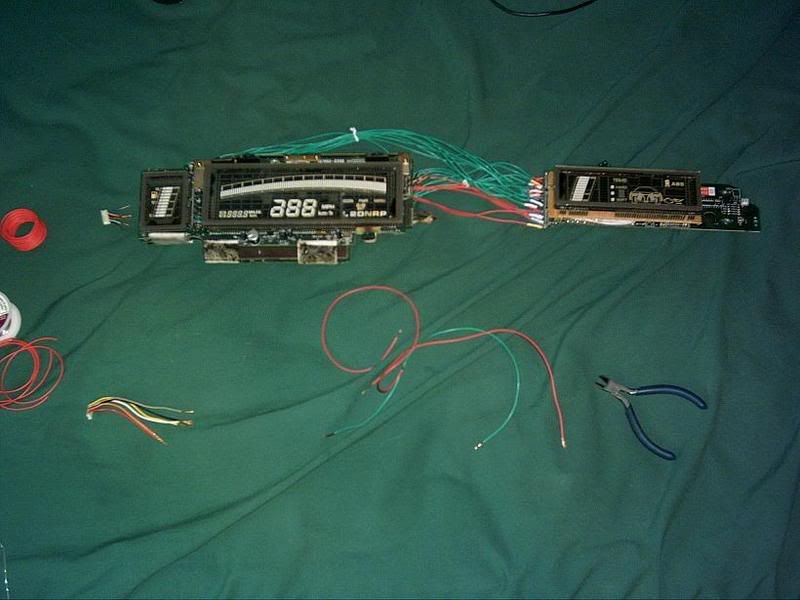

I worked ALL DAY doing the wiring for my cluster, what a journey. My fingers are rough and tired hehee. On with the pics.
Done 3 of the 5 wire clusters yes!

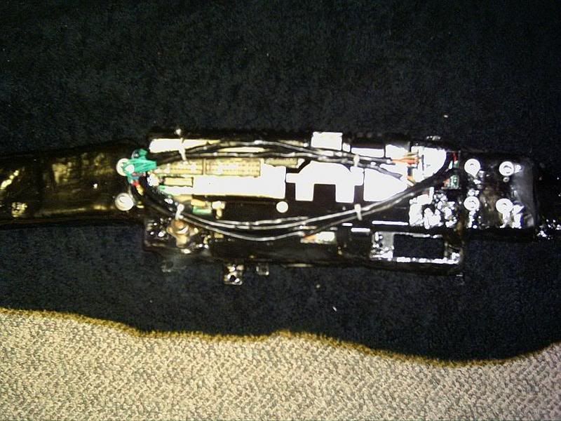

Here is how it will fit when arranged into the cluster. The wires will probably go around back of the entire cluster casing and be on the outside.

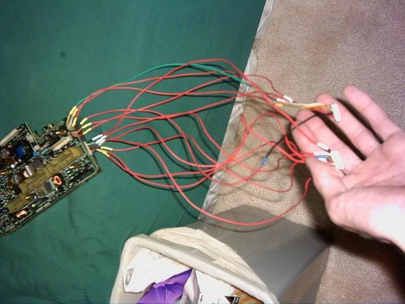

Just finished 20 mins ago roughly! The last 2 wire clusters!!!

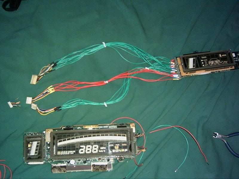

All of my hard day's work layed out for your viewing pleasure!
I have much respect for anyone who has personally extended their 1JZ wiring harness with the 120+ connections in it.

Finished the wiring this morning. I had to make it shorter as my extensions were too long heh. I wrapped them too and zip-tied them.

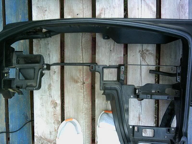

Stock dash no modifications.
Stock dash modified to fit the deeper digicluster.

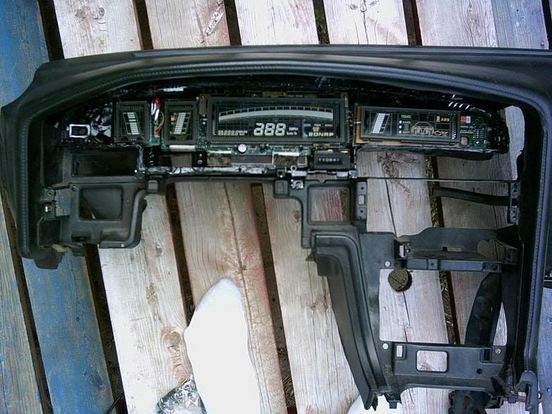

Digicluster dropped in approximately how it will sit once in the vehicle. I need to get bigger screws to hold it properly, maybe make some extra support for it as it is heavy.
