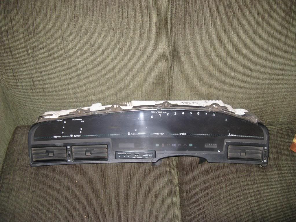

Micro update for anyone curious:
I'm still finishing my male mould. I used a silicone to seal a hole but it wasn't drying so I have to use another kind I used previously to do the job; waste of $5 and time. With midterms this week I've had little time to do much.
This came in the mail today though :)
It has the oil pressure gauge on the far left side which my other one does not. I have been trying to get this cluster for a looong time ;).
