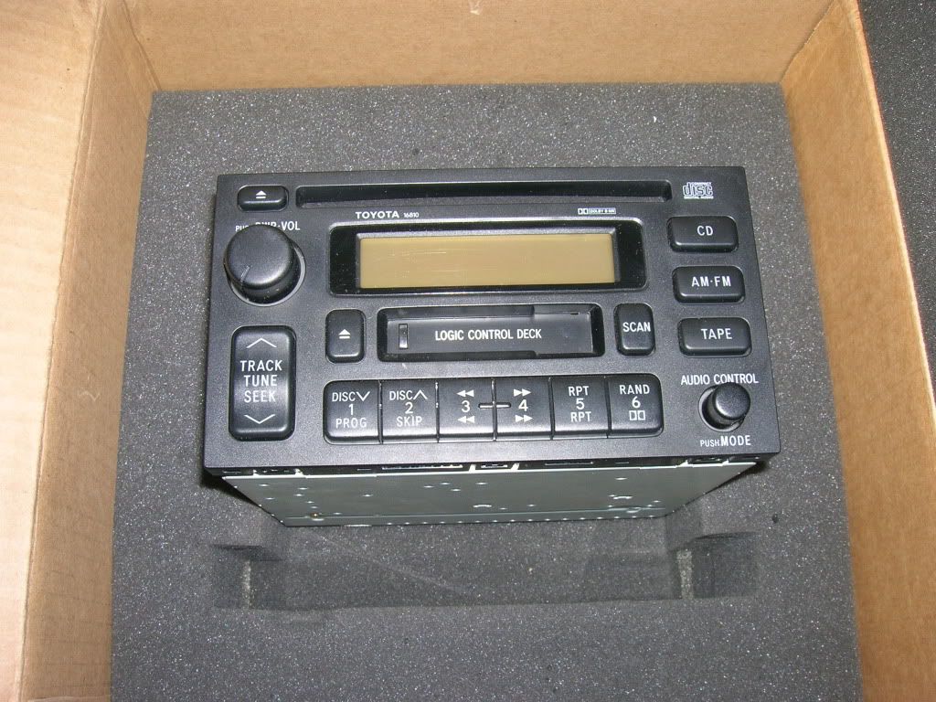

Hey, Christmas came early this year when I was cleaning out the New Old Stock shelves in parts! I scored a BRAND NEW Toyota Radio/Tape/CD player for uber cheap! Been on the shelf for 6 years! Don't know if it works, but if it doesn't I'm not out any cash. However, if it does, I got a freakin sweet stereo for next to nothing! WOOT!
Oh yeah, the car still runs, but it's cold and snowy outside and I don't want to add to the rust I already have. But anyways, It's sitting happily in the garage waiting for new parts!
toyotanos
What will we break today?
Nov 29, 2008
2,844
Coon Rapids, MN
Alrighty then, It's time for an update...kinda
The radio went in well and I think it looks great. Sounds good, and it even brought my passenger rear speaker back to life!

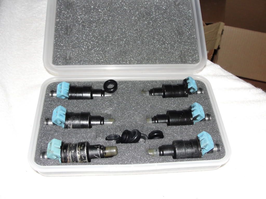

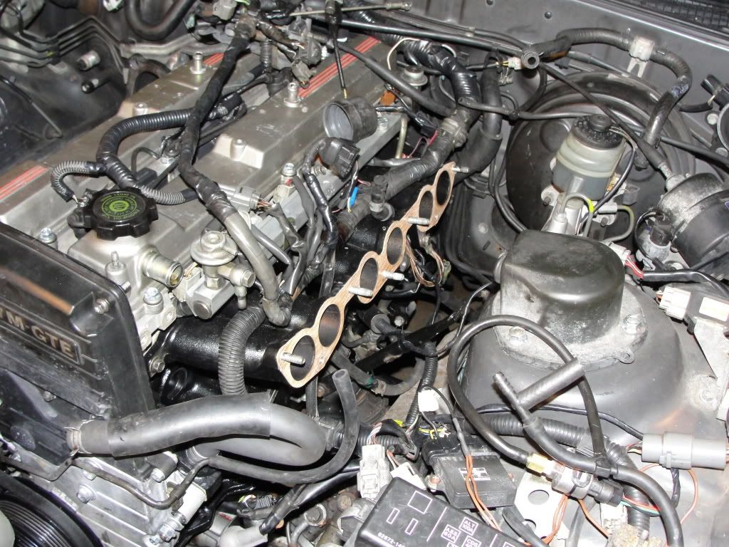

Just got my front facing intake manifold in the mail (Thanks Jesse!) and it looks great! It's not finished, but that's a good thing, because it lets me choose where everything goes. I also got a polished fuel rail from Funky_monkey58, complete with 2 AN type fittings to try to get me hooked on them, and they do look nice...
So the car hasn't moved since snow fell, but things will be getting done soon, here. I'm going to order a new fuel pump (mk4 TT denso) and find some 680/720 injectors first, and then get some extra stuff to go with them (afpr, braided fuel lines, etc). Then I'm going to have to make up my mind on the turbo and get to ordering that too. Here's some new pictures!

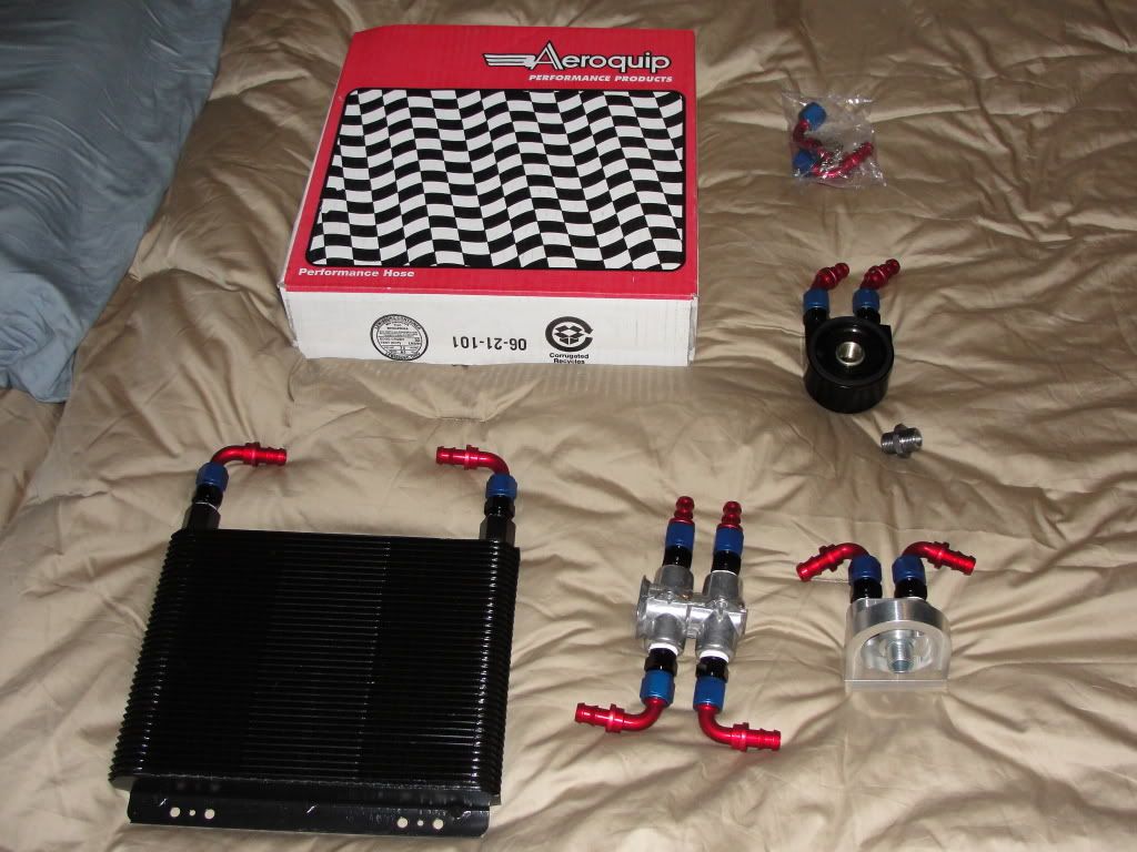

And the building resumes... Got my oil system in today!
Side note: I believe the canton adapter was mis-boxed from the factory, as the threads are too big- see pictures, Pic 1 has the NA oil filter stud upside-down, pic 2 has it right side up! ()% sure this is not 3/4-16, rather, I think it's 13/16-16 :(
[THUMB]http://i432.photobucket.com/albums/qq47/toyotanos/1991%20Toyota%20Supra/DSC00106.jpg[/THUMB]
[THUMB]http://i432.photobucket.com/albums/qq47/toyotanos/1991%20Toyota%20Supra/DSC00107.jpg[/THUMB]
Looks like I'll be busy this weekend!
64
They use the same body for a lot of applications Steve just changing the bolt (my LSx one is identical)
You might have been sent the wrong one or someone mispacked it at the factory.

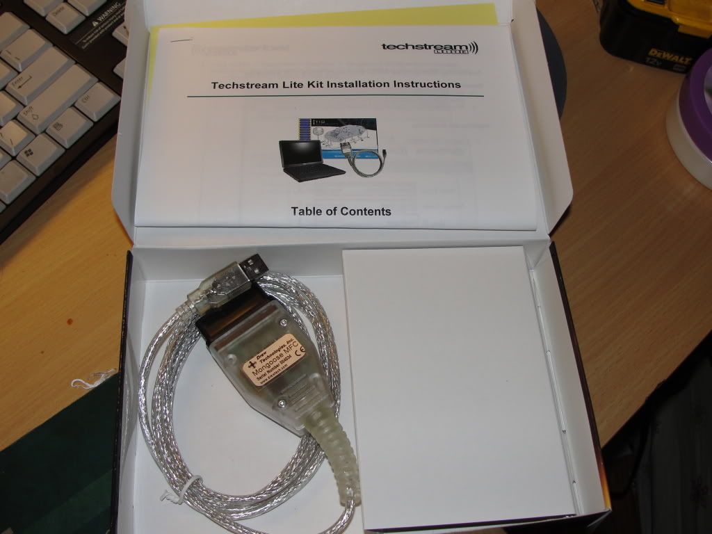

New canton adapter is on its way, and I got a new toy from work today!
Not many will know what this is, but it's really a full-function Toyota Scan tool adapter. I will never again have to wait for a Techstream scan tool ever again! Only the Masters got them, so I'm feeling better about getting all those ASE's out of the way...

leecheater;1528775 said:
Steve, it sure looks pretty. I am wanting to do the same on mine. Any advantage to the oil coolers with fans?
Dan
The only real advance is with fans you will have better cooling from 0-20 (or so) MPH. Other wise at speeds above town driving you will get more CFM's with air flowing threw it naturally. That is unless you mount the cooler in a place that doesn't get air flow. IIRC IJ used fans on his cooler but his MoTeC turned them off at a certain speed.
I see your part of the "order the Canton adapter twice " too.
