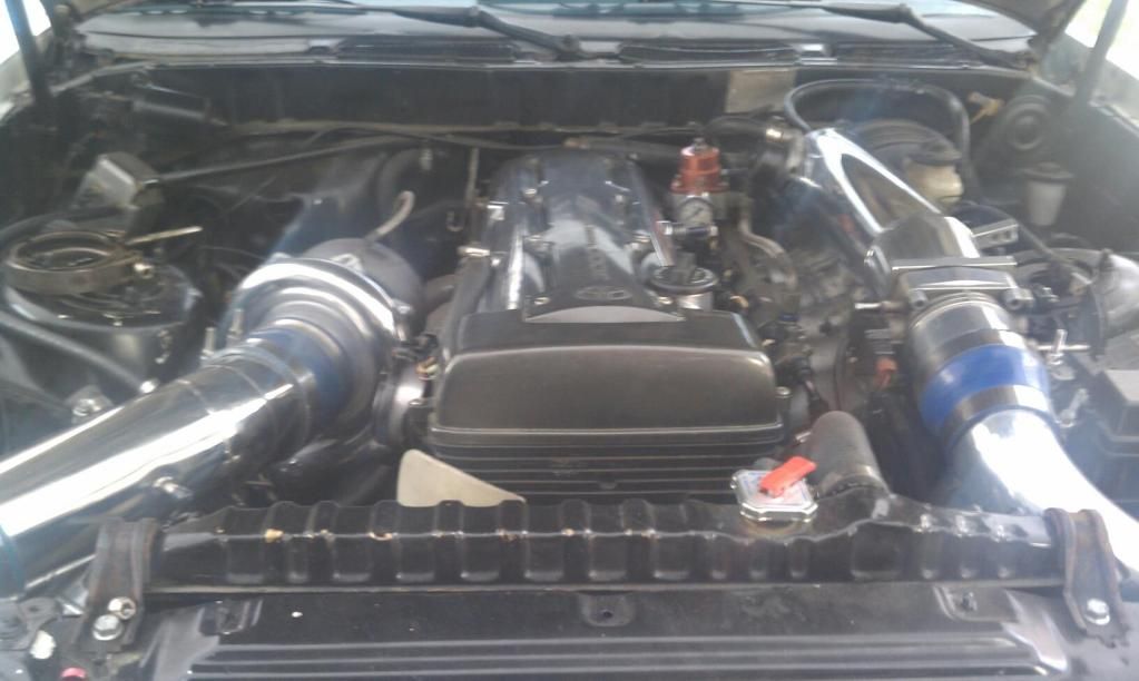

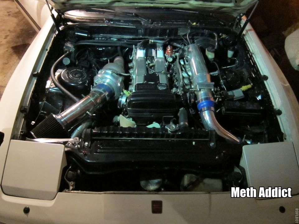

The engine looked like this...
But I ordered chrome JZ tops from Majestic motorsports $450 shipped, and another $150 for the valley cover, $600 was well worth it, as the new look shows.

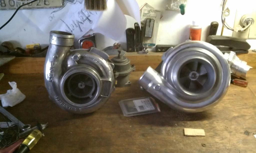

The GT40 was traded for a T76
This is temp, as I am saving for a GT4088R, which will really suit this setup!
