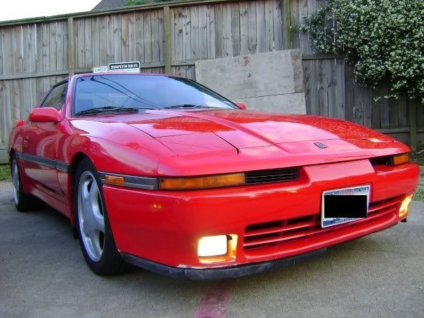

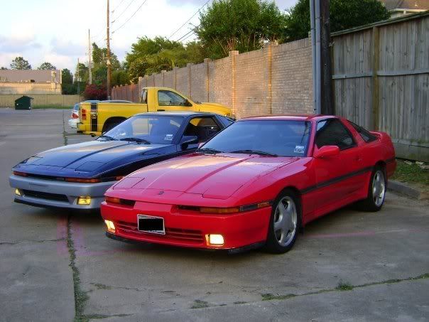

In the 3 years following the last post I made, I drove the Supra around on the RSRs for a while, until they finally settled. And with me not having replaced the rubber parts at the top of the coil, the front end was WAY too low for houston roads and I bought a ebay coilover set (maxspeed or w.e, the red/gold ones). After that I managed to break one of my wheels, and I then replaced all 4 with MKIV TT wheels. Heres what it looked like with the ebay coilovers and MKIV wheels.
Thats JDMMA70's car behind mine. The RSR setup with the messed up top hats was about 1-1.5" lower than this setup. I drove it around for a while with this (coilover) setup.

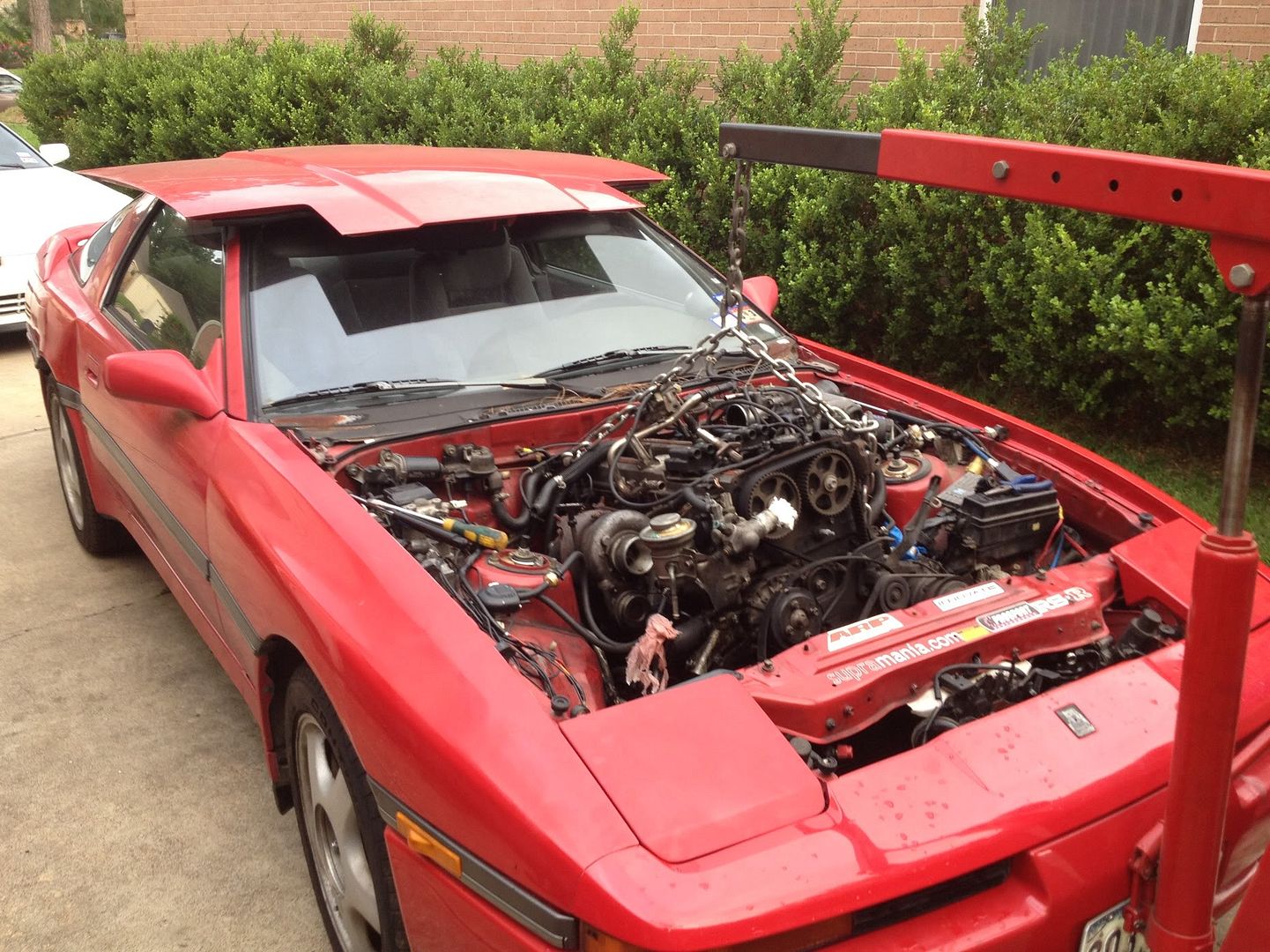

- Took car to TX2k12, car overheated while friend driving it, 0psi on most cylinders.
- 1jz Swap Begins!

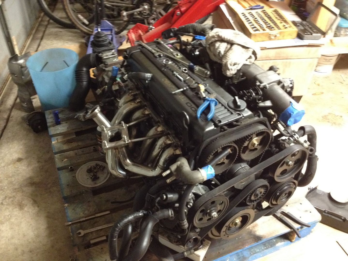

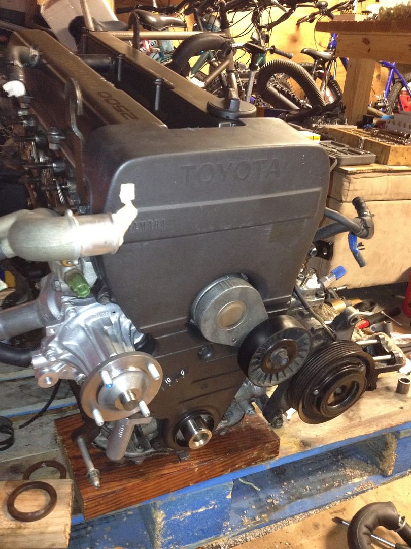

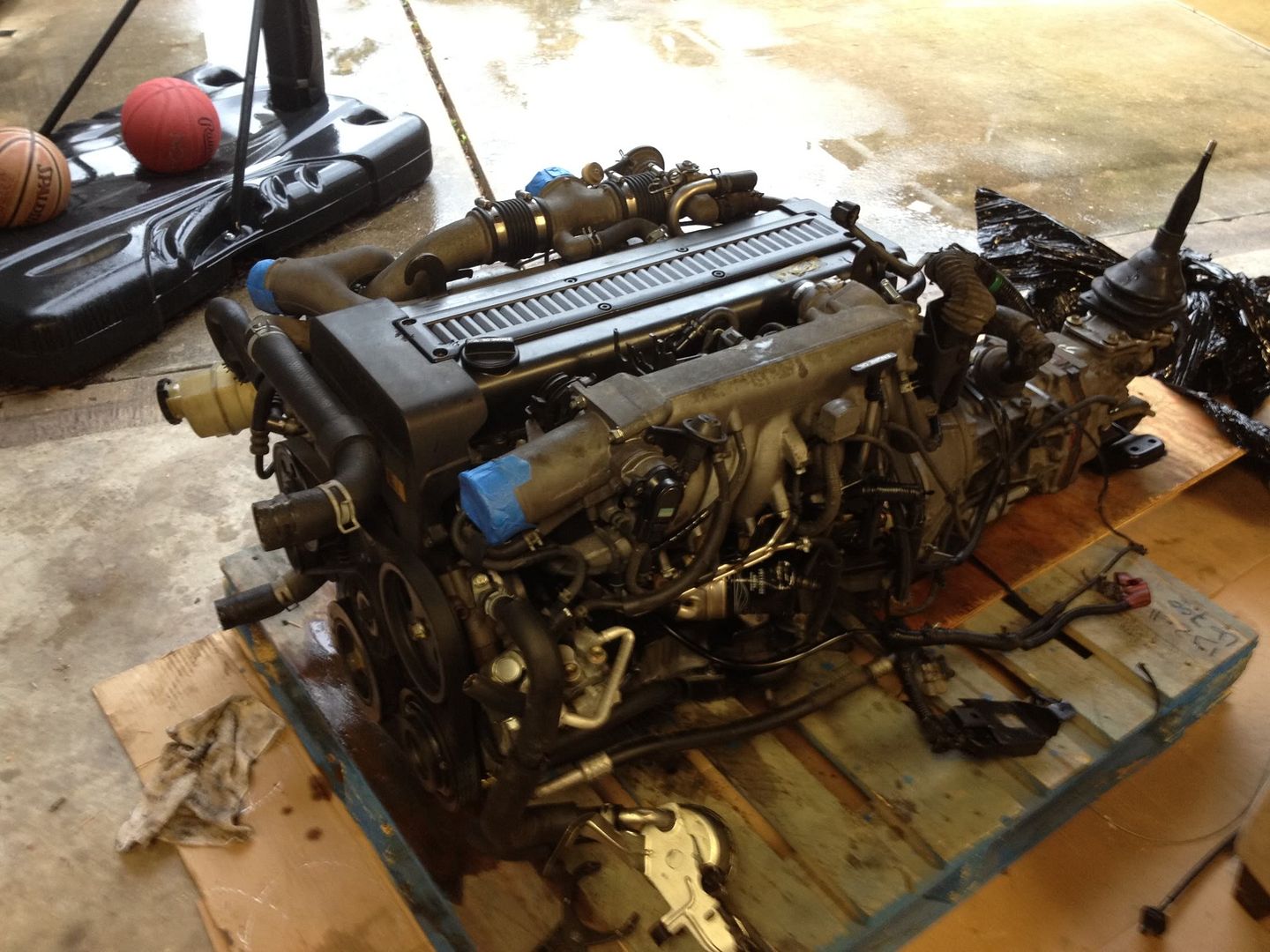

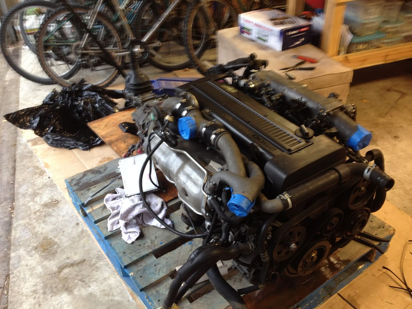

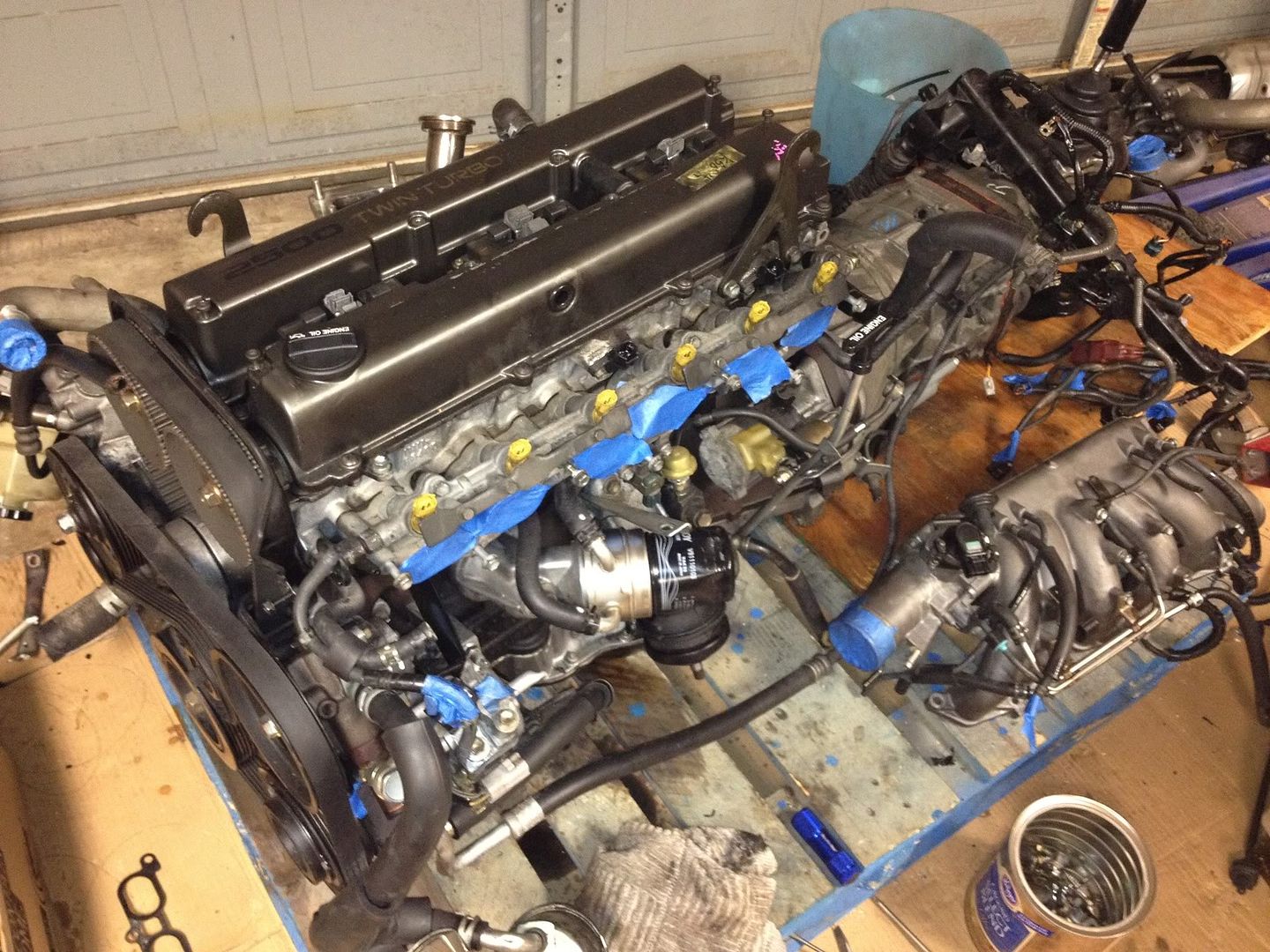

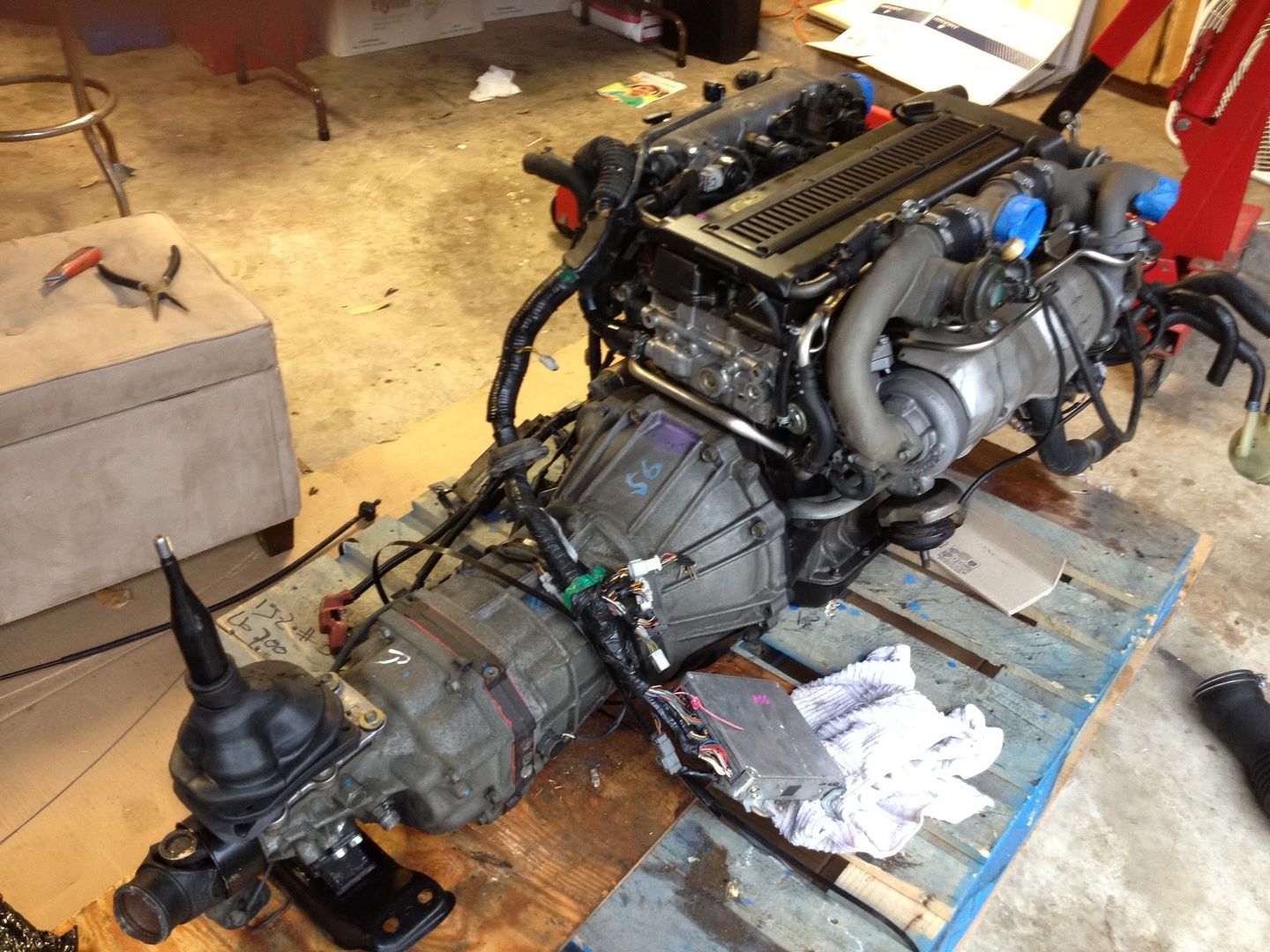

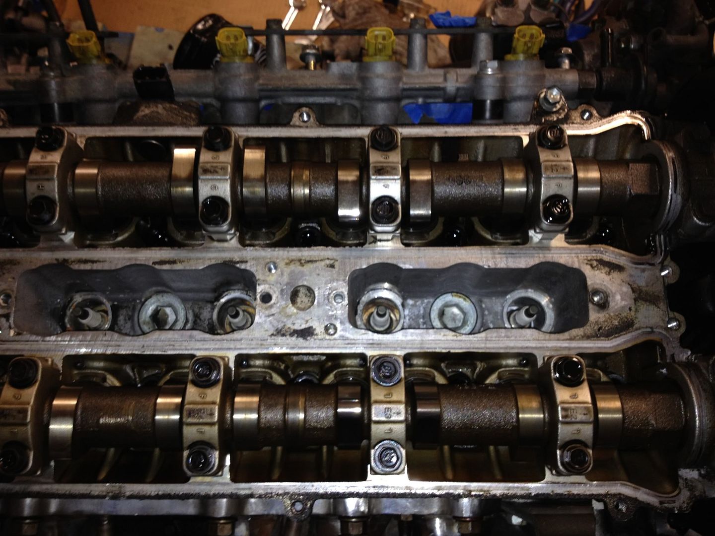

Alright some updates, with just pics in order. Dont feel like commenting much. =p

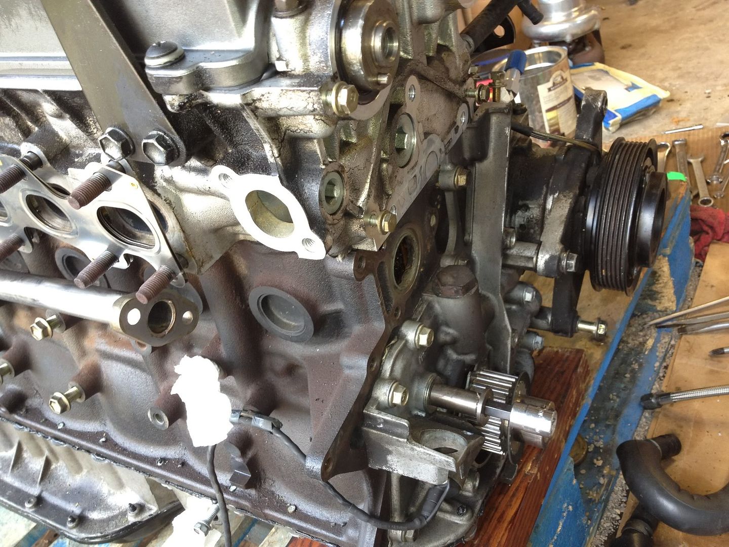

So this is what the motor looked like when I got it. It was actually completely wrapped in black plastic and strapped down with steel straps. It was very well secured to the pallet, but one of the straps kinda broke a lil bit off of one of the injector clips, but its no big deal it still clips on.

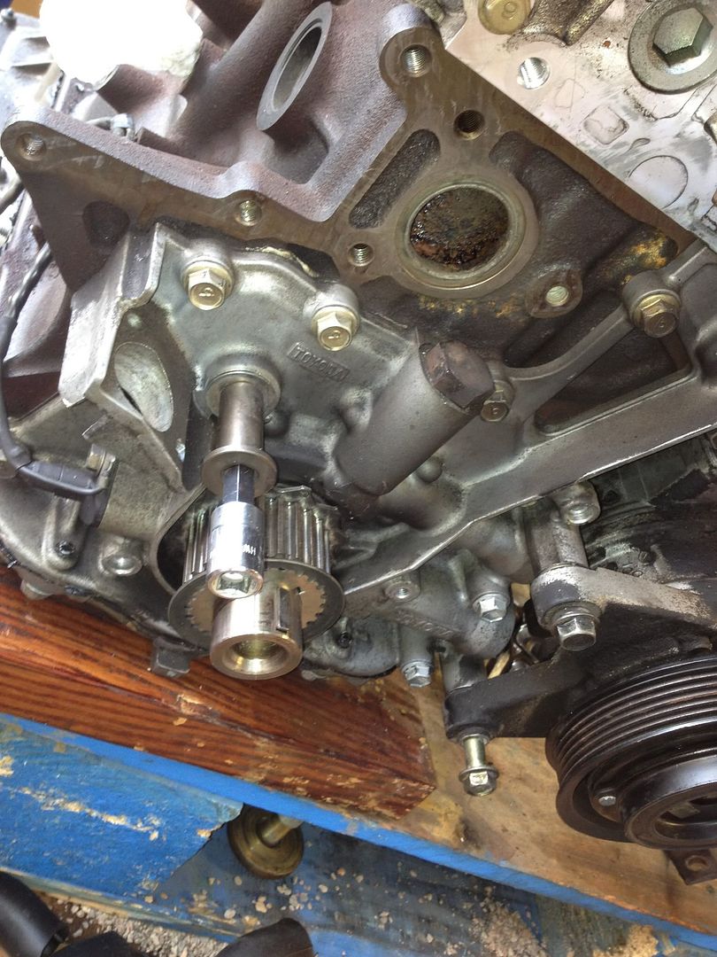

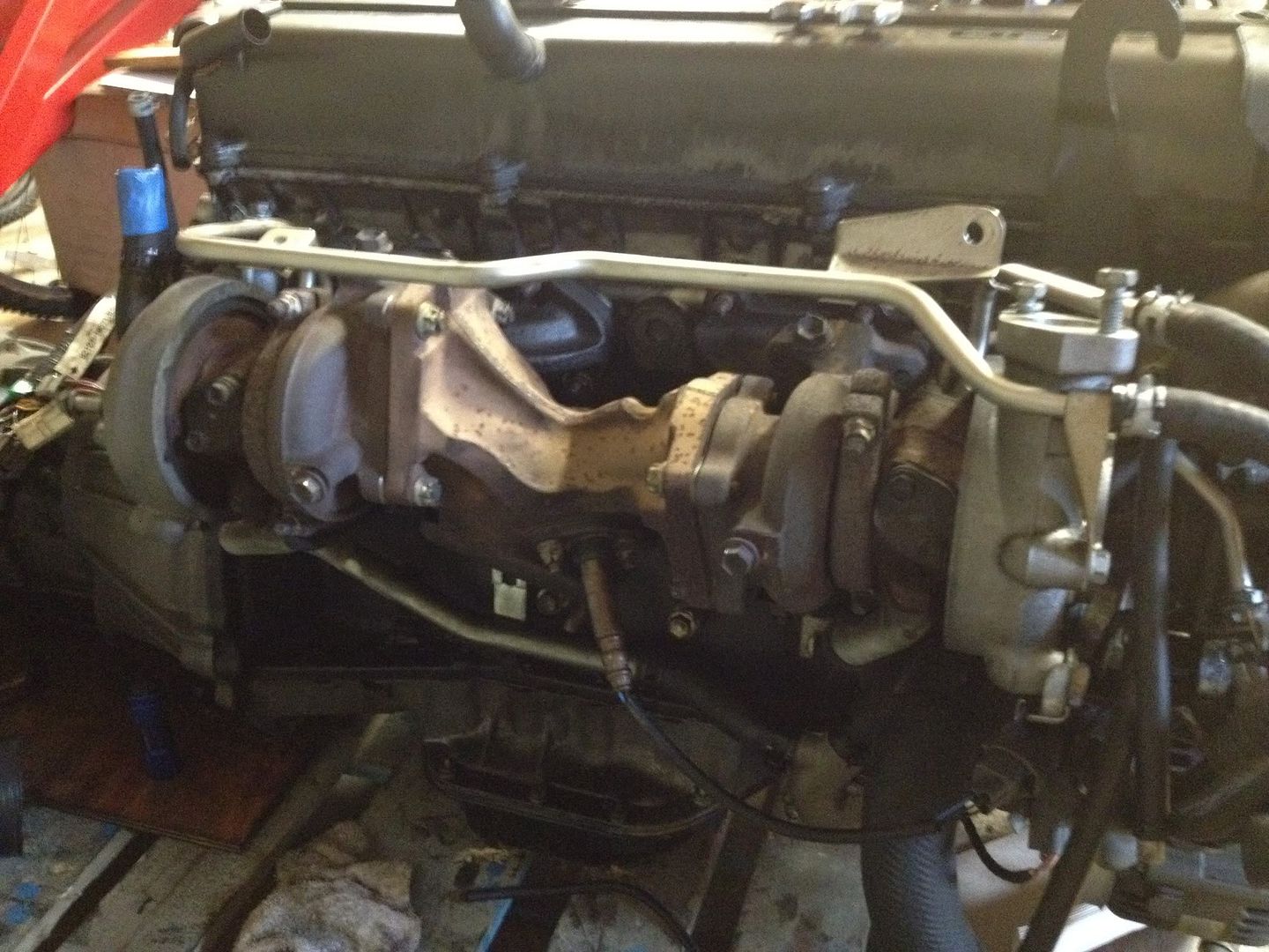

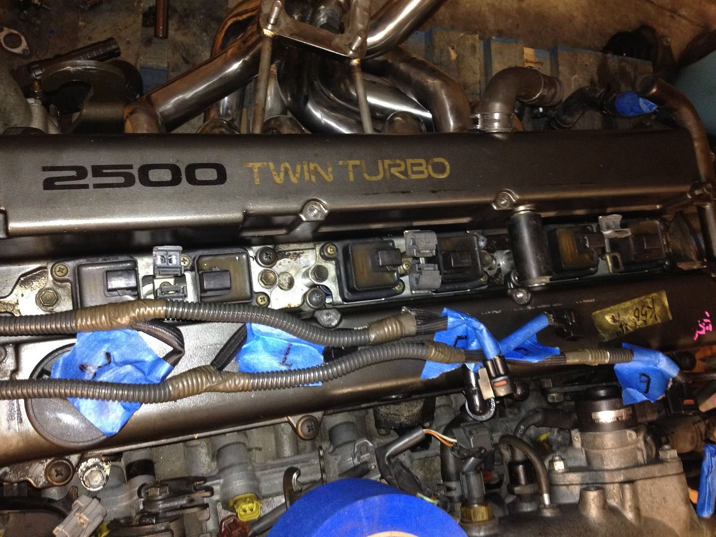

So after staring at the 1jz for a few minutes after helping the driver unload the engine and get it up my driveway.. I get to work taking the twins off! Dont have any twin disassembly pictures, but heres one after doing a good bit of it.
It still took me a while to take them off even with the engine out of the car and seeing as ive never done it before. Probably spent about 2-3 hours but with taking my time so I don't mess up anything.

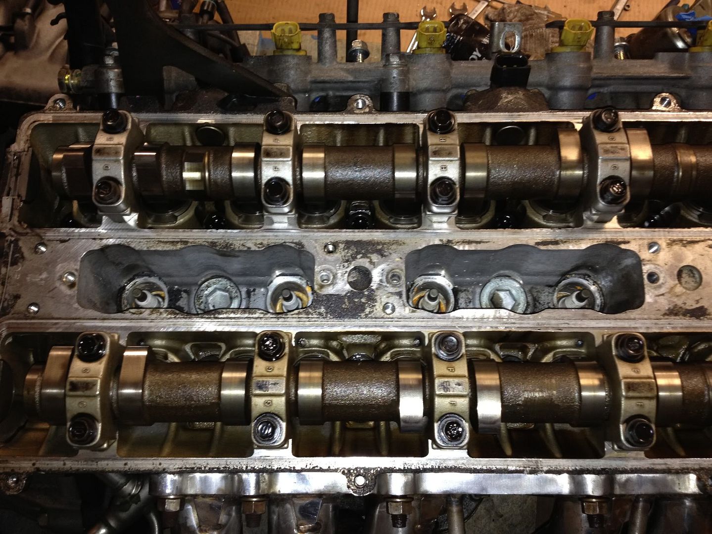

That engine looks insanely clean and super low mileage judging by the look of the camshafts.
$2900 well spent if you ask me. Good luck with the 1jz, I gave up on the 7M before I even bought my car hahaha.

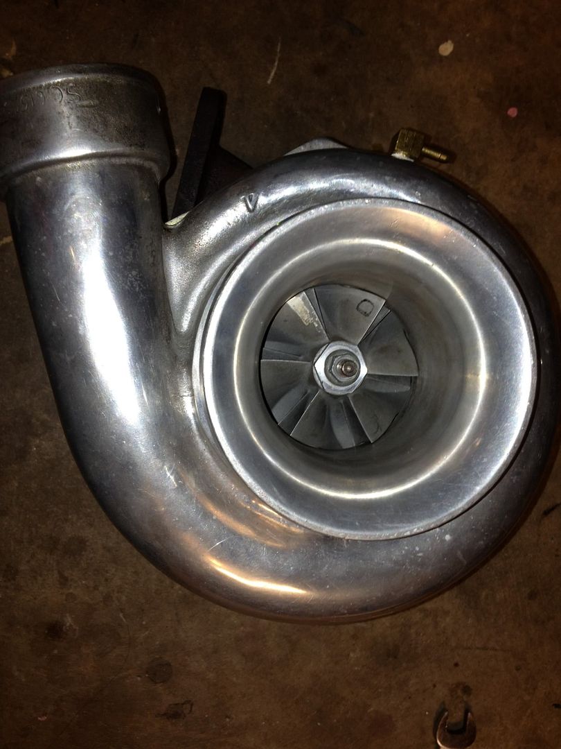

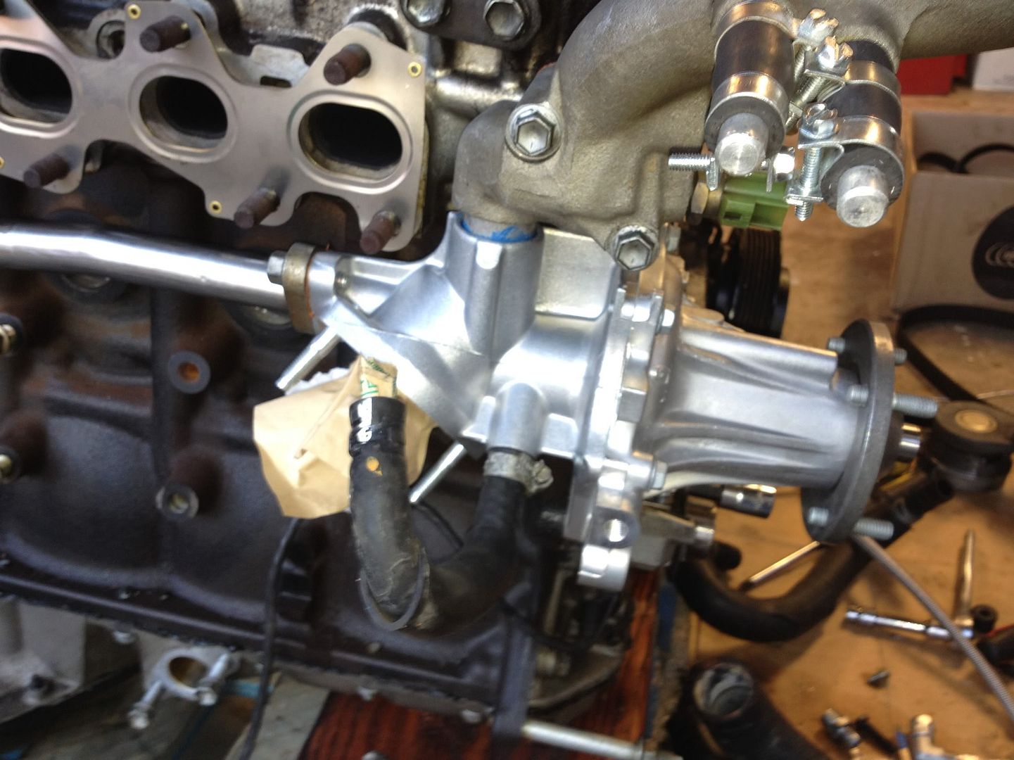

Sorry for the lack of updates, ive just been working at it. Throwing parts at it whenever I can/get them. I have some more things I need to get started on so ill get some pics similar to the current ones of that as well. =p Everything has been budgeted out and all/most parts are already here or are about to get here. Plan to drop it in on sunday!

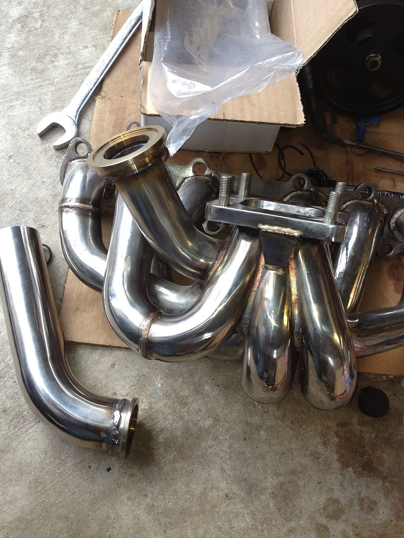

But anyways, the turbo is a Precision SC6152. Its supposed to be similar to a GT35, atleast thats what I read on a couple forums. I really just wanted something that spools later than stock twins (so i can stay out of boost for DD) and kicks hard once spooled.
And I appreciate it Salvy.. I may have to take you up on a MKIV Supra Turbo Thermostat, I had a Gates one on the way from Rock Auto but it seems to be stuck in Ohio. Haha

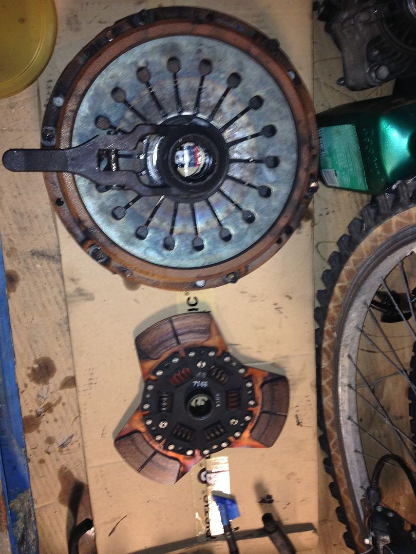

Also pretty happy that I got a TRD clutch with the engine! :)

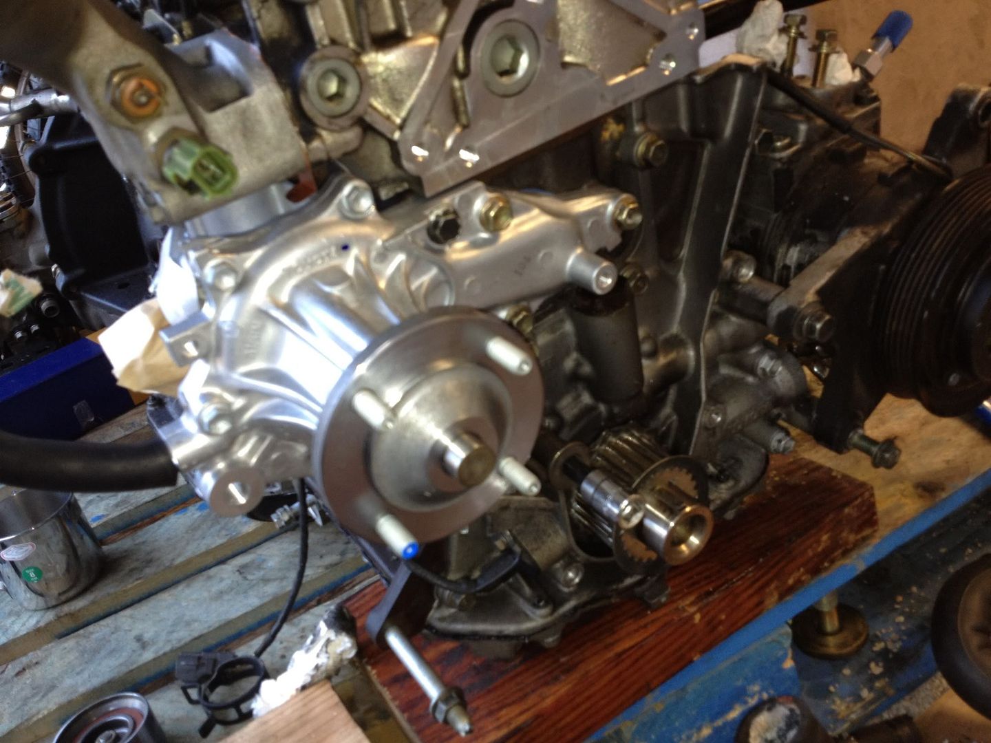

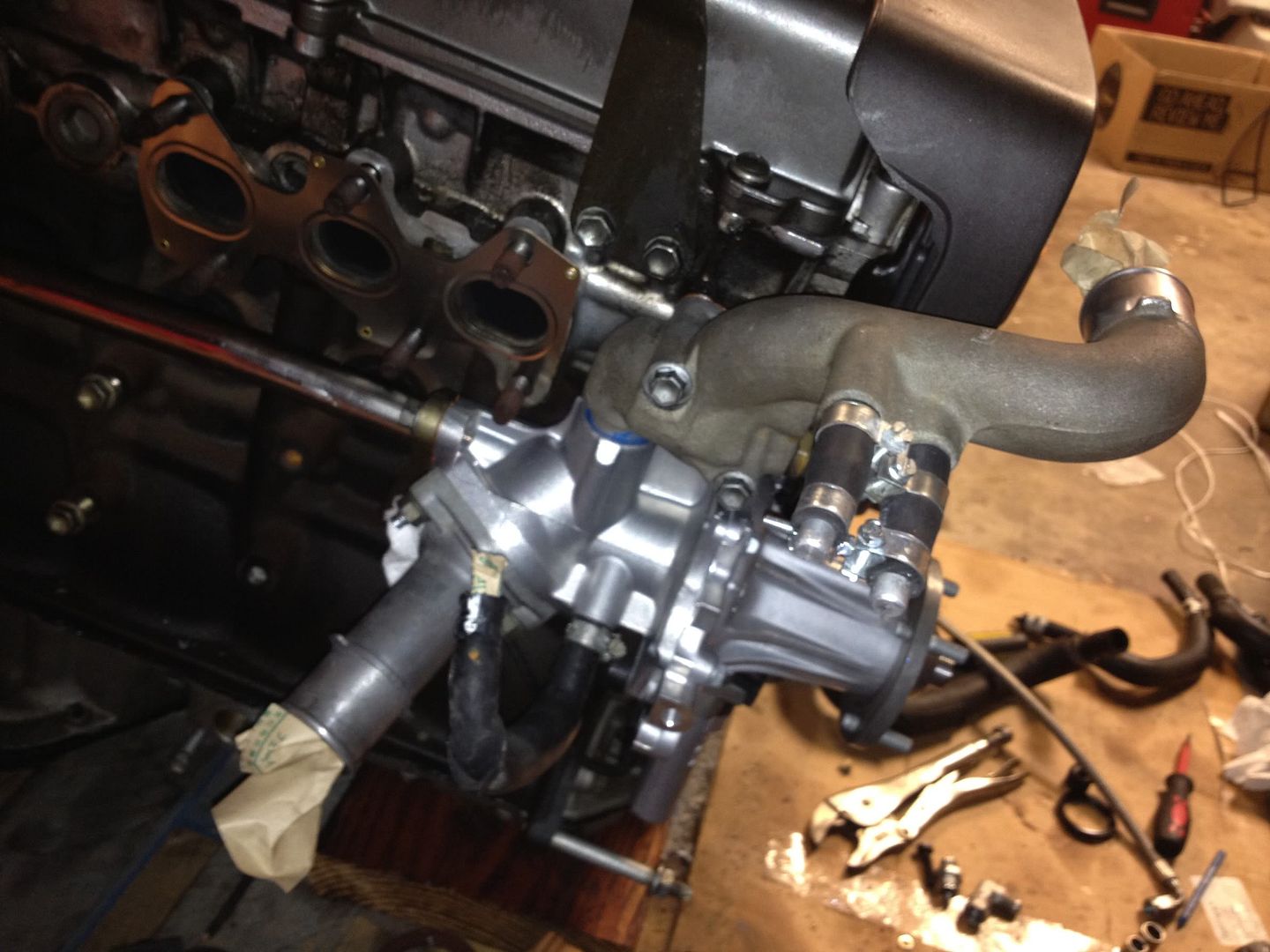

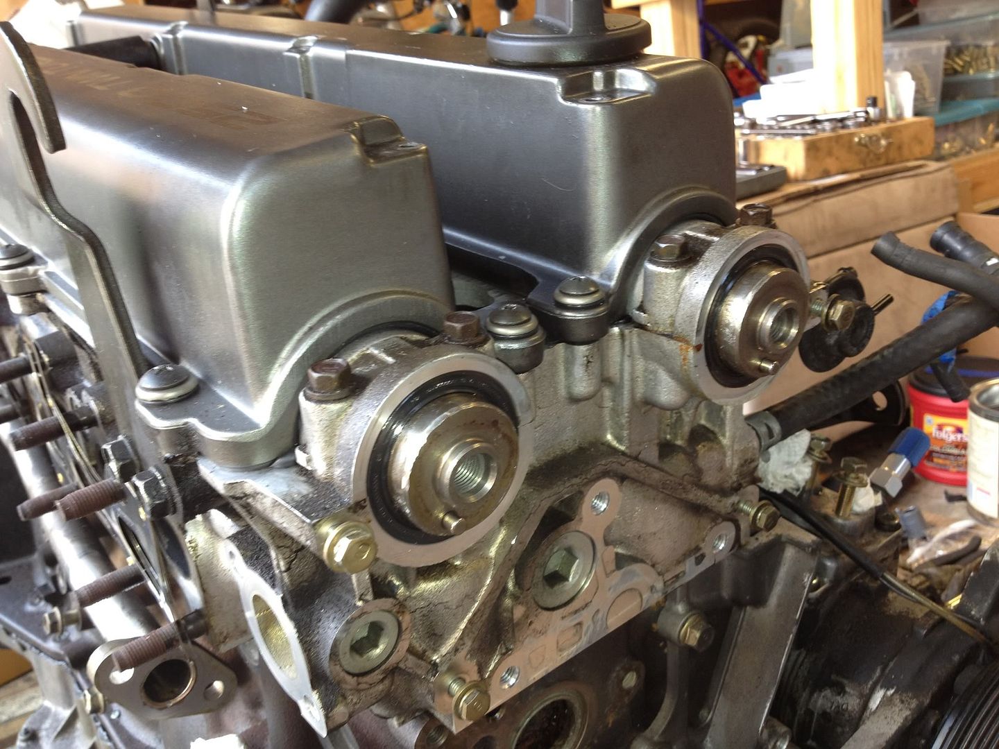

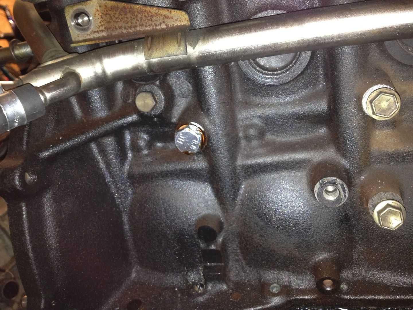

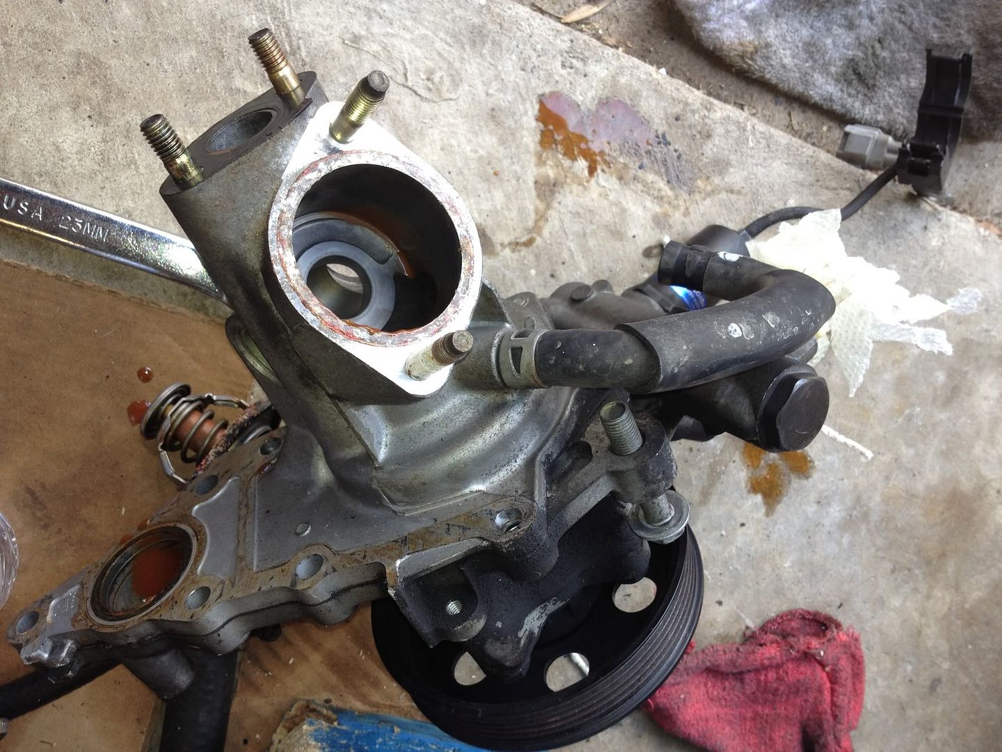

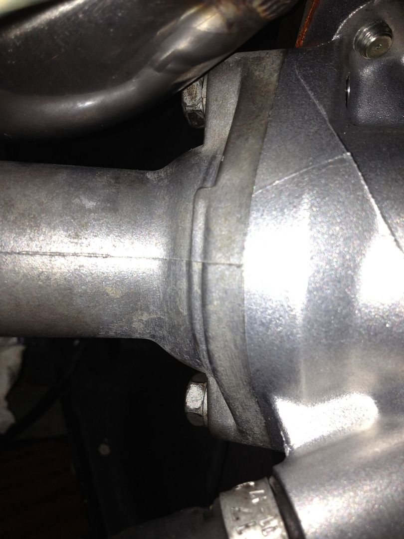

Got this done over the weekend.
^^ Normal studs for the thermostat place didn't work, i had to change to bolts to be able to take it off with the manifold on.
Will be trying to finish it up by Tuesday, depending on when I get my DM shipment.

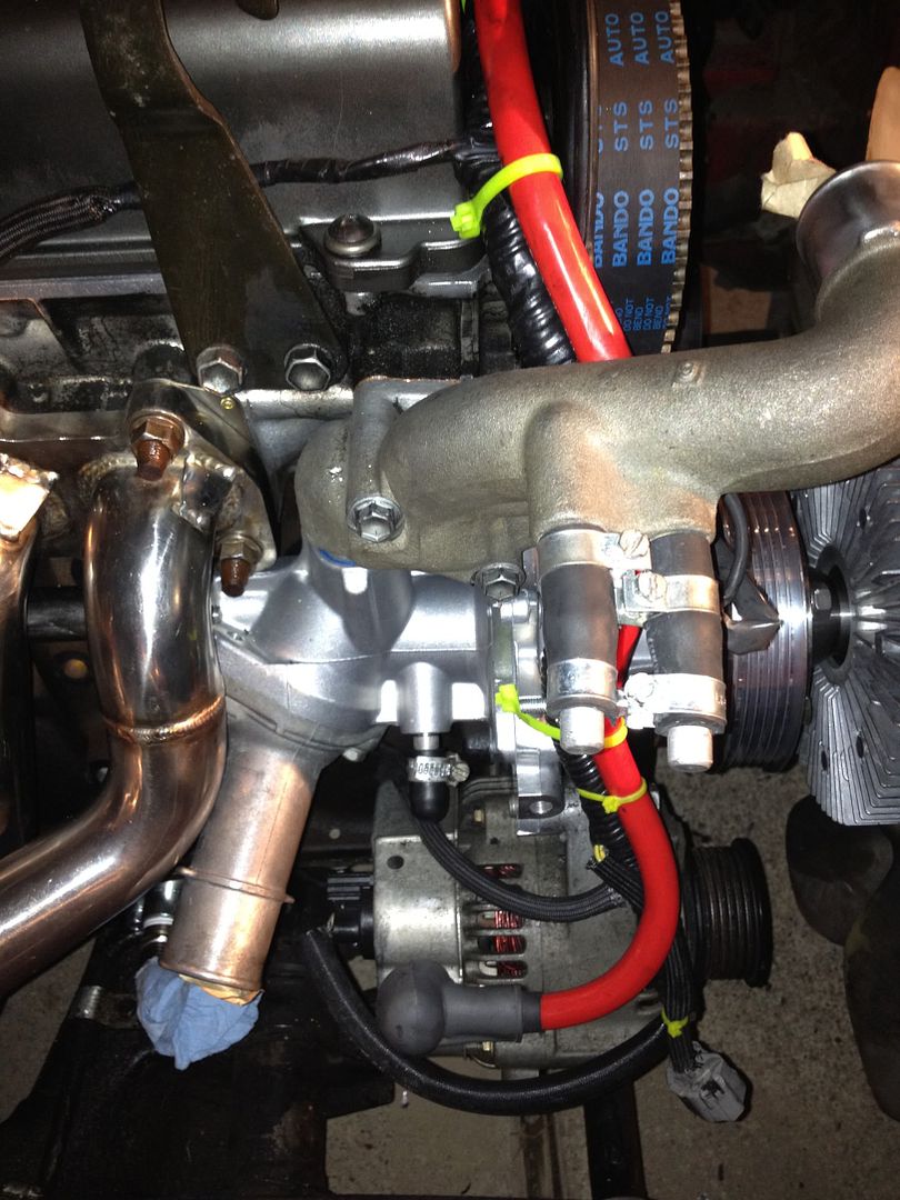

Houston, TX

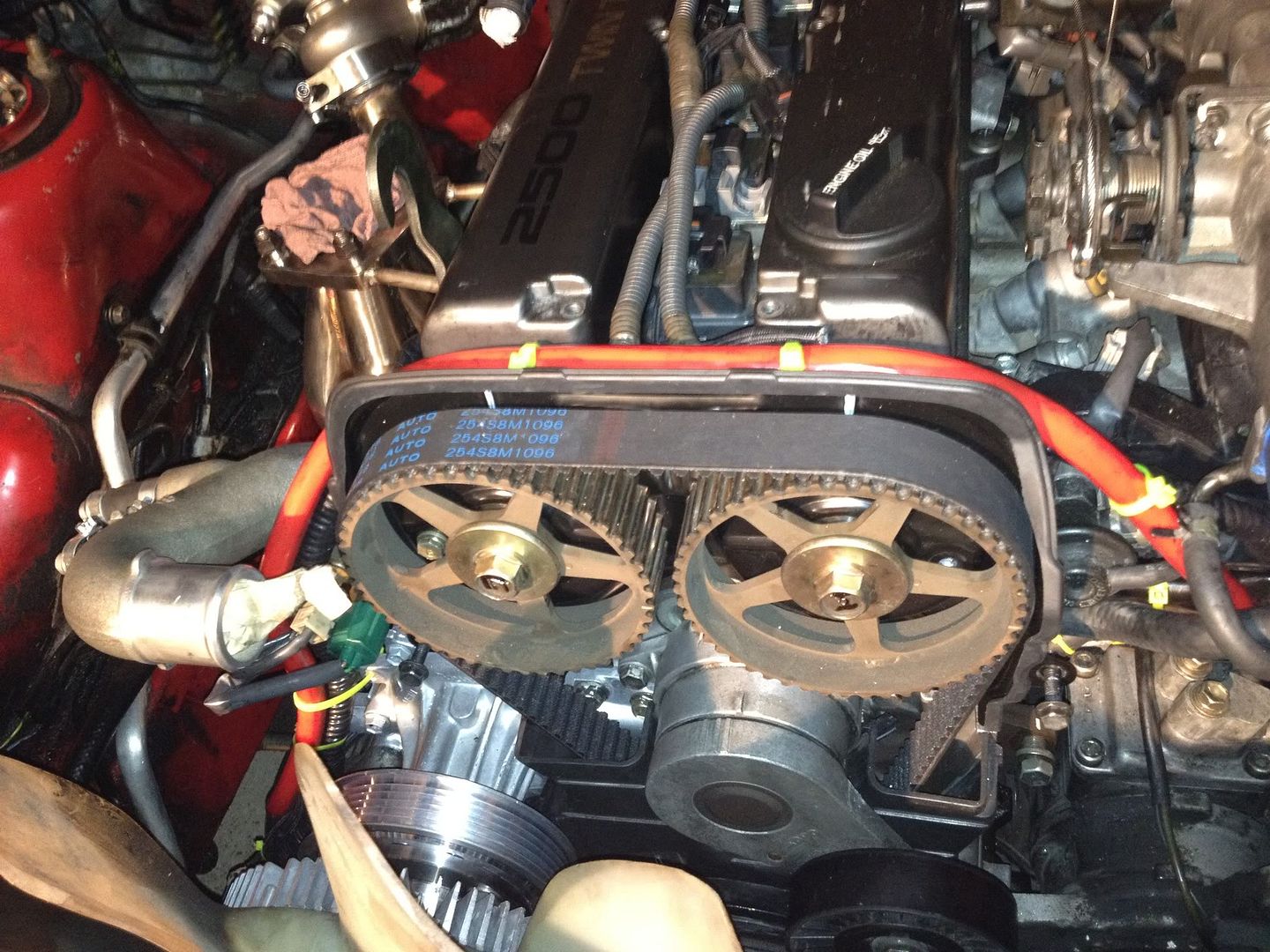

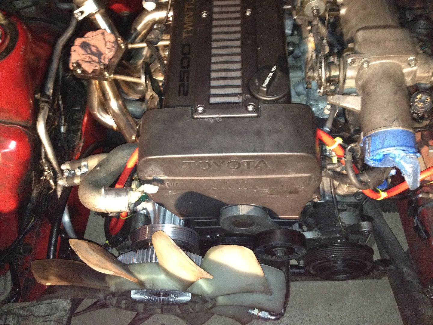

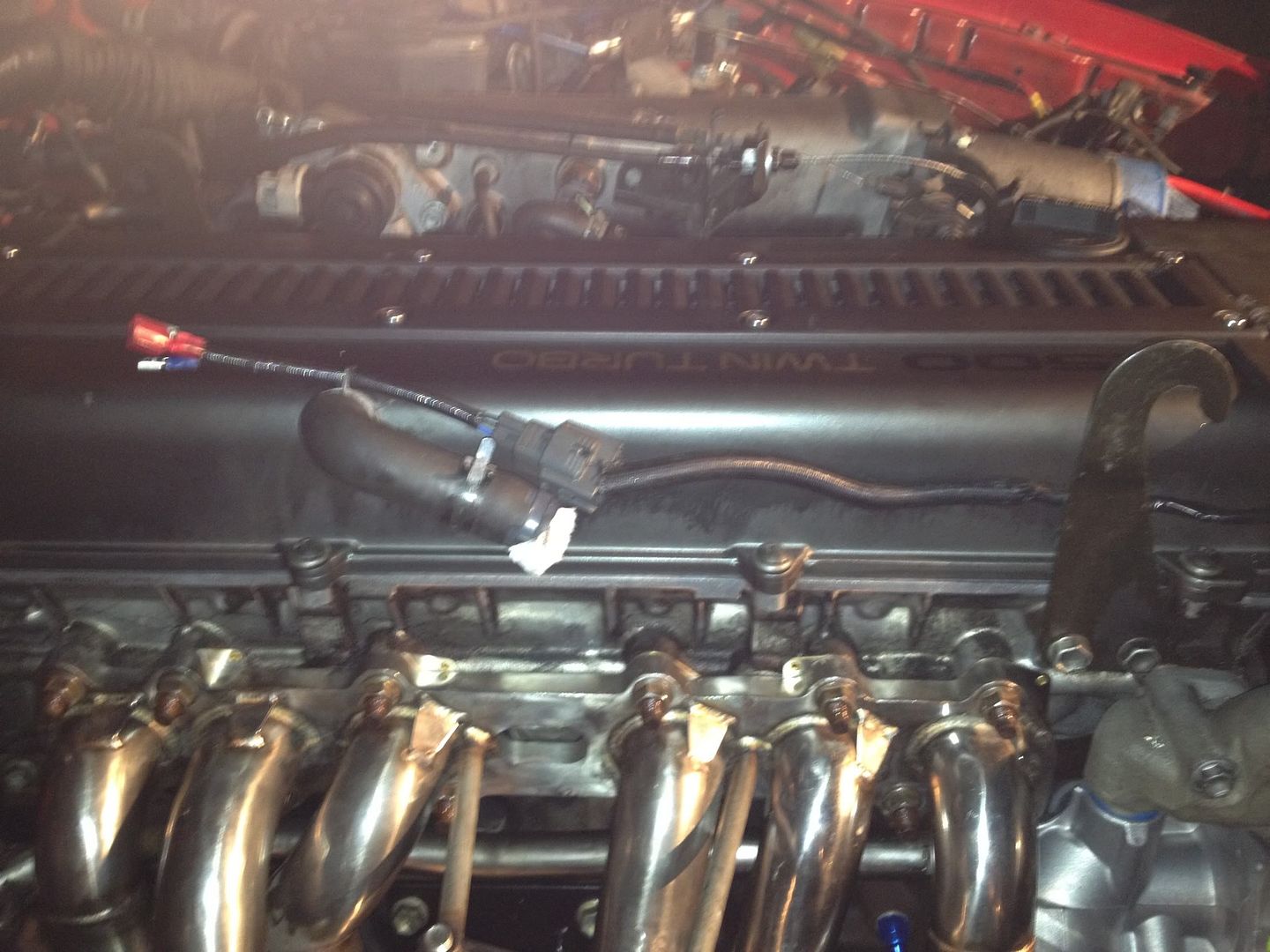

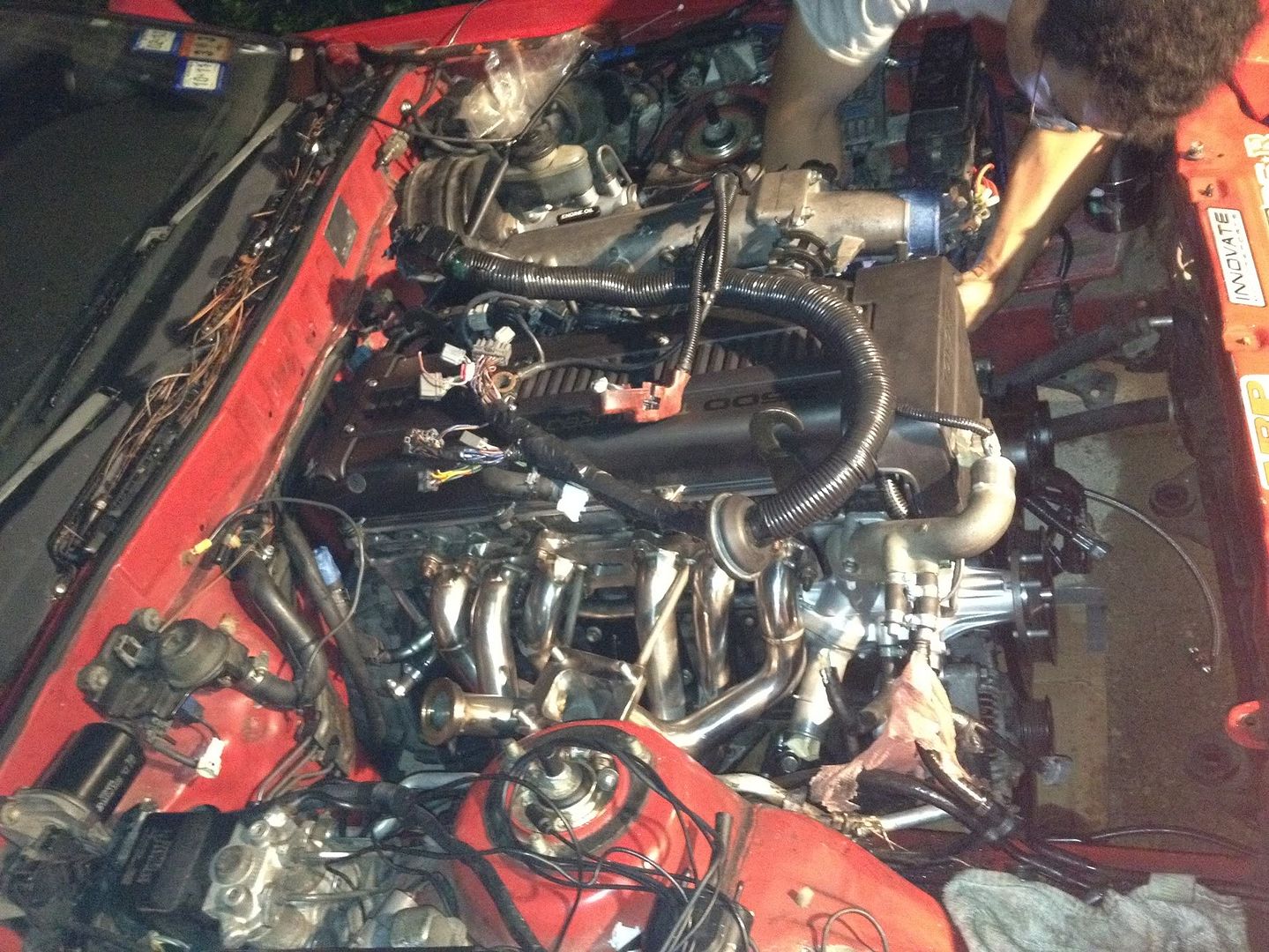

What I got done yesterday.

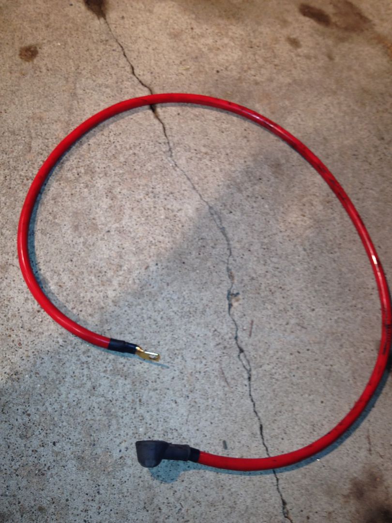

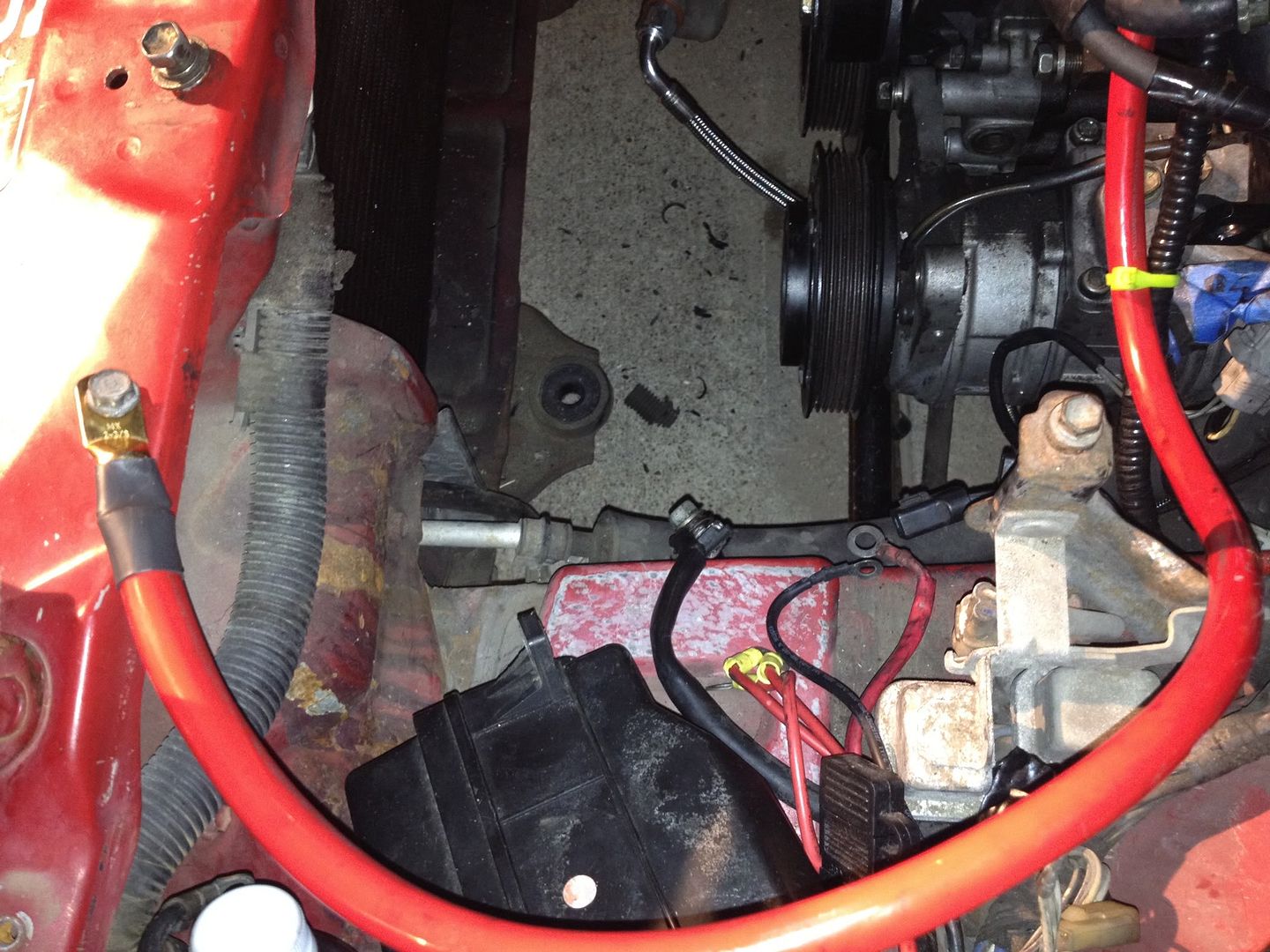

Extend alternator wire to other side. Took a slight different approach than usual, lets see how well it works.
Fixed the O2 sensor Wire location for the downpipe.

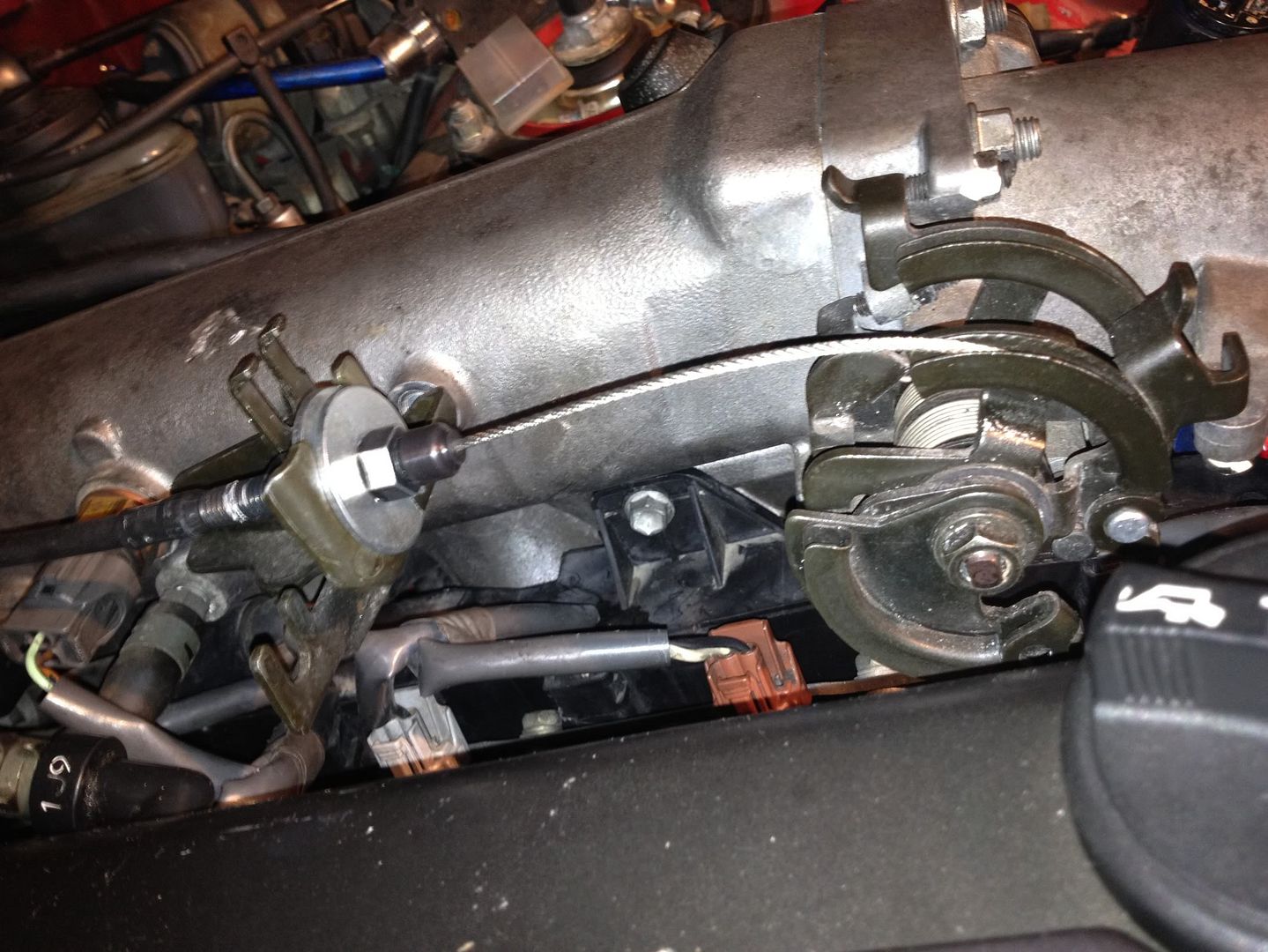

Found some washers for the throttle cable and got that mounted.

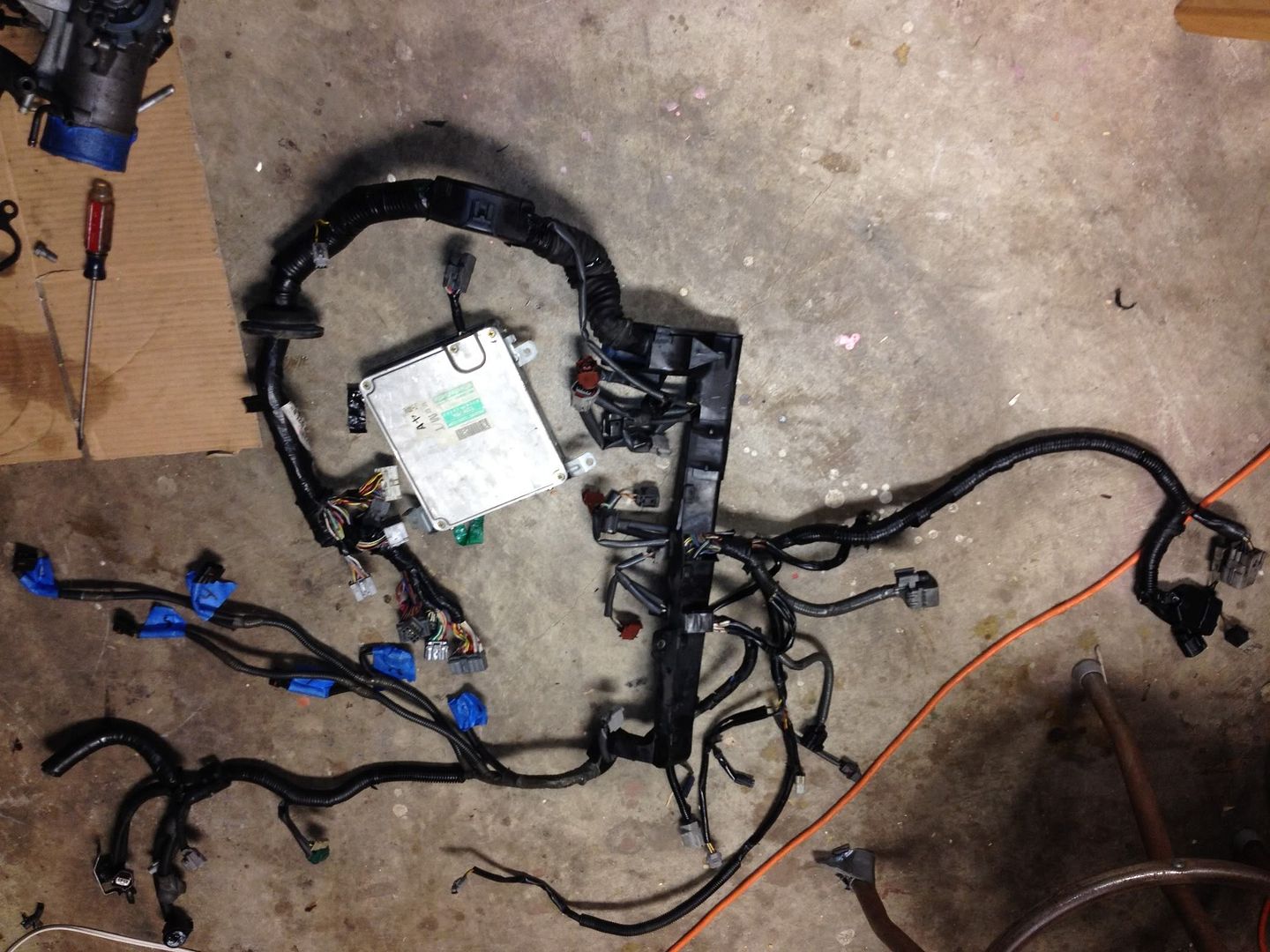

I got my harness back last sunday (local friend did the harness) and had already put it on the car before dropping the 1jz in.
Oh and my Driftmotion shipment came in. Its the clutch fan, pulley, and oxygen sensor (not pictured).
Next - Intercooler setup, put radiator back in, put ECU in, fill with fluids, prime, start, ???
