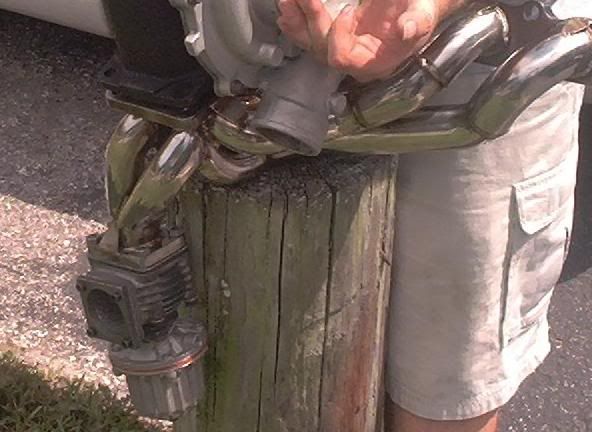

I just thought of something: how far off is this going to move my turbo? Is it going to affect my DP? I was just thinking, I get this thing, put it on, bolt it down, and then realize my DP "V"band is an inch too low or something...

I guess you should figure: If getting this custom style manifold... OF course it's going to position things differently. I almost guarantee the DP will need to be either repositioned (cutting and re angling) or remade all together.

Damn... thats what I thought... I suck... I was thinking, er, hoping for plug and play... But it looks like I might hafta put some work into it... If I decide to go forward with this... I guess if it doesnt work out, I can always just sell it...

Have you seen how low the WG sits down there too? Makes it look really low.
Here is the pictures from Will's manifold.
It's pretty low.

A spacer was needed for the wastegate in order to properly run the dump tube. The way it bolts onto the manifold the dump either faces against the subframe or the block, with only a couple inches clearance on either side. I am sure it is POSSIBLE to make some hacked dump tube work, but I just found it easier to make a spacer to rotate the wastegate 90* so it dumps towards the back of the car leaving more room to make the dump tube.
I have owned the manifold for several months but it has only been in use for about a month. Yes it is an older version I suppose since it hit the oil filter mount.
A friend has been running his gt42R with the ebay manifold for over 4 months with no issues, and thats without any supports on it. He does 24psi DAILY DRIVEN with it too. Manifold is fine.
Downpipe:
How the turbo sits:
I don't have a picture of the wastegate spacer. All it is is two 50mm WG flanges welded on opposite ends of a short section of straight pipe (2.0" dia. I think) with one flange rotated 90*

well, i guess they redesigned the wg dump too. cause my wg sits so close to the block there is no way a pipe would fit. but in my mkii i should have room to run a 2in pipe with 90deg bend the way it is in the pic. it should clear the rail just fine. though mines going in an mkii. i havent bolted it into the mkii yet but measured from the flange on the head amd the wastegat is directly below that and almost as close as the head flange itself. mine is the newer style one though.

With my spacer, the nipple on top of the wg hangs as low if not a tiny bit lower than the oil pan.
My downpipe isn't low, it almost rests on the underbody, its a tiny bit lower than the frame rails.
