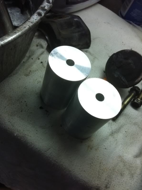

I love my solids, went out bought some material and lathed them up. It rattles alot im not going to lie, but its tolerable. It reminds you to tighten everything up in the interior. But right when you hit 2000 rpms its about the worst. Go for it you wont go back.
