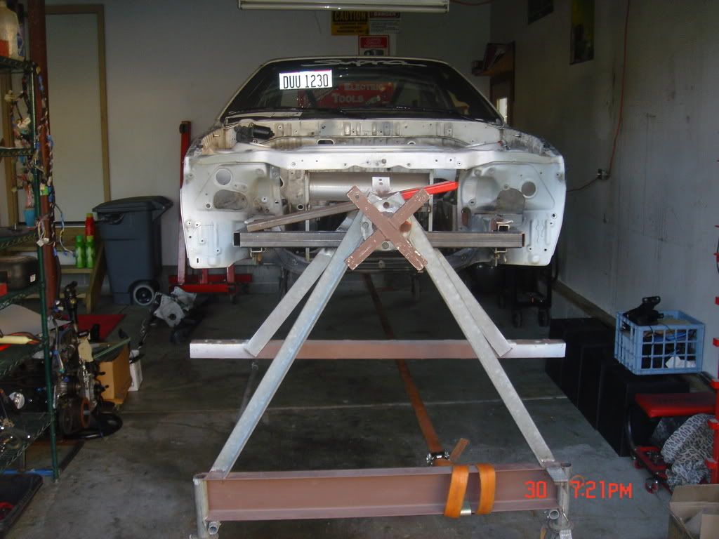

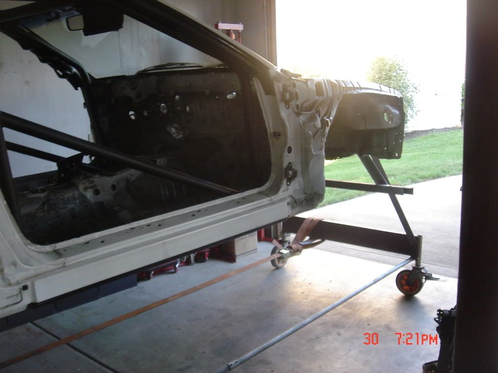

Well today i took off the doors hatch and subframes. Then i put it on the rotisserie. Its sipns so easy ill post a video of me spining it tomorrow.

dude i so put seat in and get some one to spin the car and try to hold on lol or just put 4 points in it
ps why do you even have ti rack any way

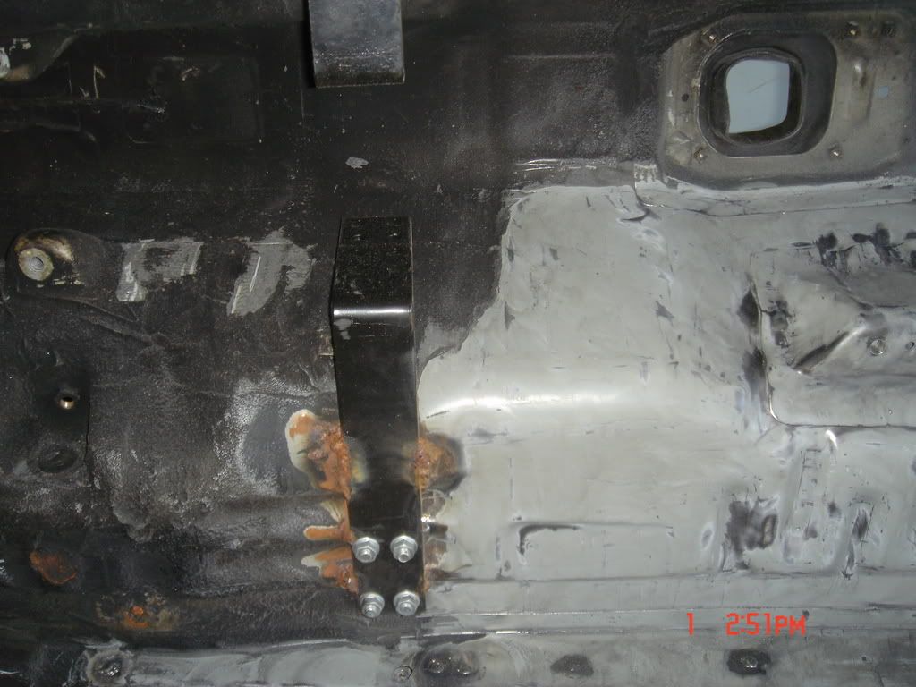

Supraholics;1118195 said:
:rofl: I'm loving it!!!!! What are your plans with that? Blast it?

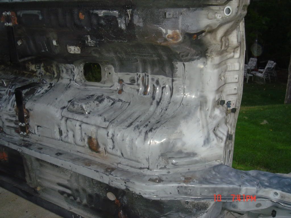

I wish no im just using a scraper and wire wheel and striping all the under coating welding up al the stupid little holes and coating the whole under side with por 15

Why do i have a what rack?

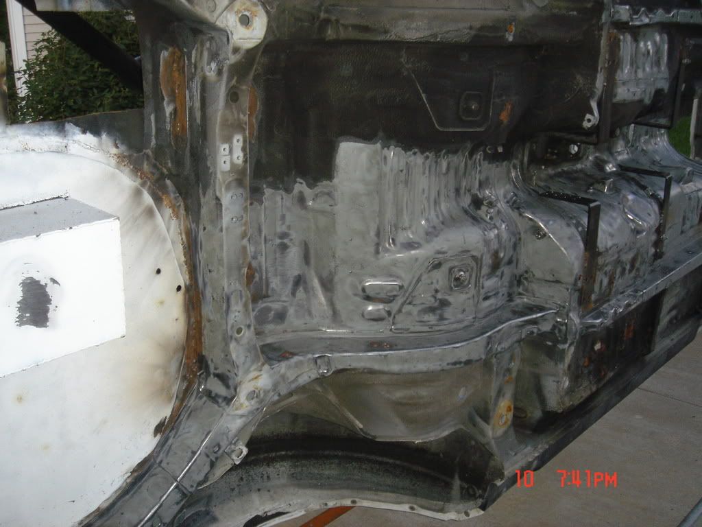

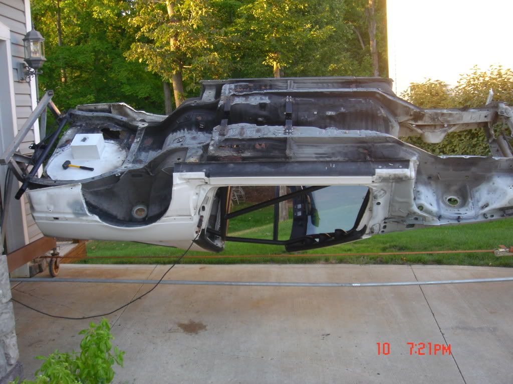

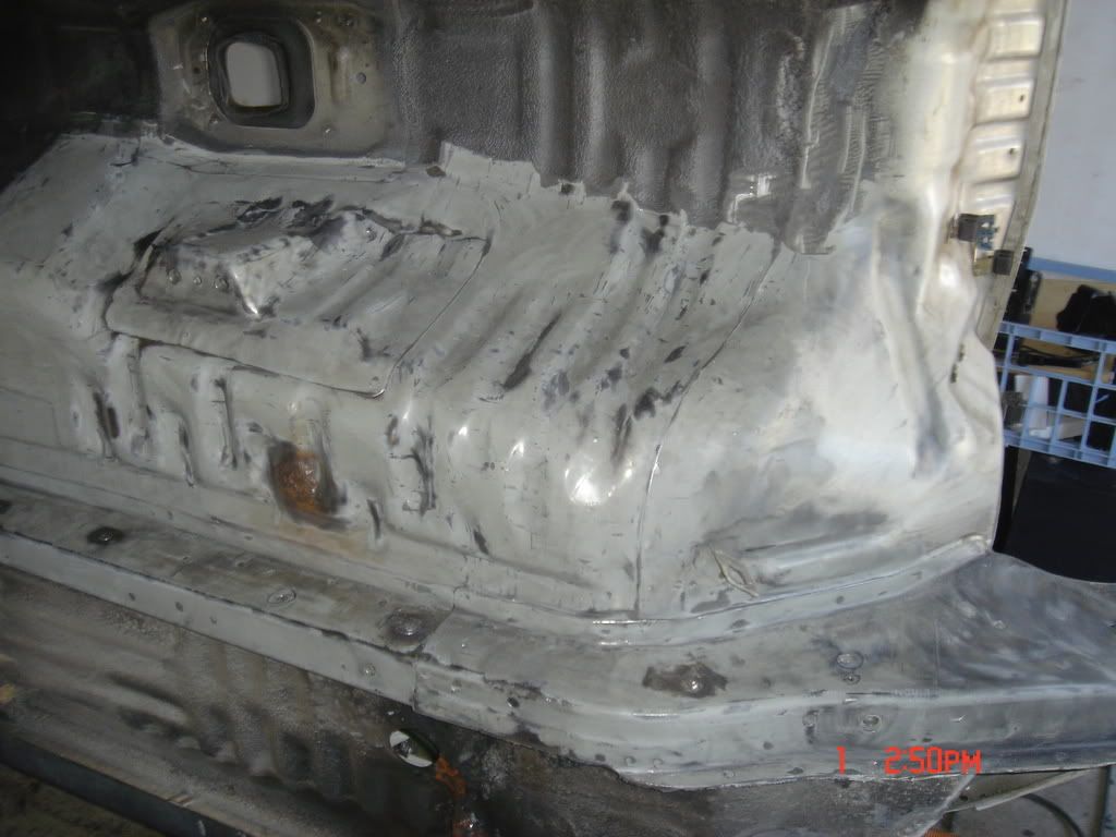

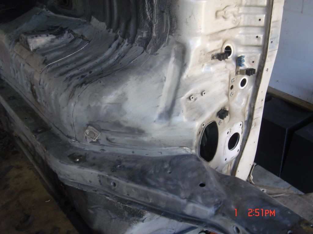

Well today i started sriping the undercoating off what fun.

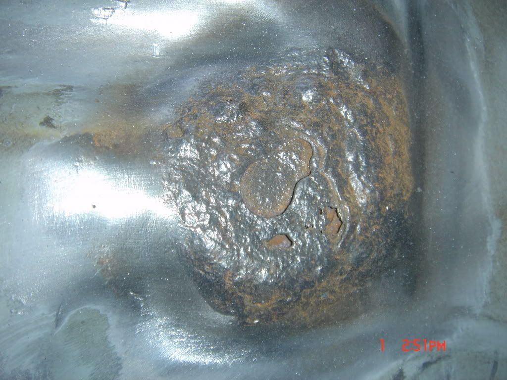

Well this is as bad as the rust gets and its my own damn fualt. But its a hole i welded up and never removed the burnt off undercoating so water got in it and rusted but its not bad at all.

IJ.;1119051 said:
^ Seriously cool Wes! :D
Must have got it right on the centreline for it to turn so easily well done.
Thanks Ian. My buddies dad had his caddy on there before and he had to use a comealong to spin it but he had it way off center.

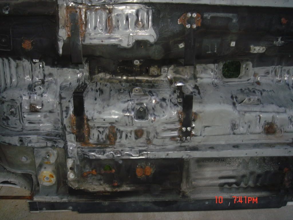

Well i have the under coating striped off from the middle of the trany tunnel to the frame rail on the driver side so thats allmost half id post a pic but the gf has my camera.

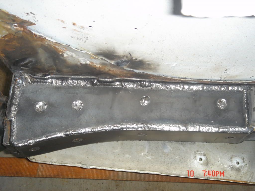

Ok i want to get your guys thoughts. I wanna box in a few sections of the factory frame for jacking points at the track oon wenn needed in a pinch cuz i can see on my car ppl have done it before and smashed it up some. I was thinking the verry front sections before it starts running up tword the firewall and the back section right before the subframe and on each side the two parts that run out at a 90 degree angle to the frame. What do you think is it worth it?
Well it really depends, cause u can use where the front and rear sub frames bolt to the chassis as lift points just as easily. Put your jack right under the bolts and lift, Or life from the diff. But that is my opinion. If you want points in the middle of the car to lift the whole side at one time, then yes, but it seems like added work and weight for no real reason. Unless you are trying to strengthen the chassis up and have lift points by putting a second layer over the exhisting frame rails, and maybe hiding the fuel and break lines in the process.
Im only gonna do a 6 inch section no thte whore frame rail.

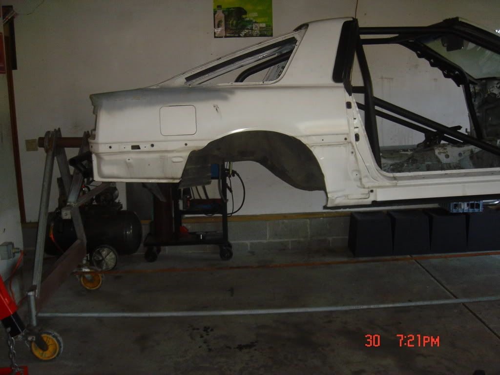

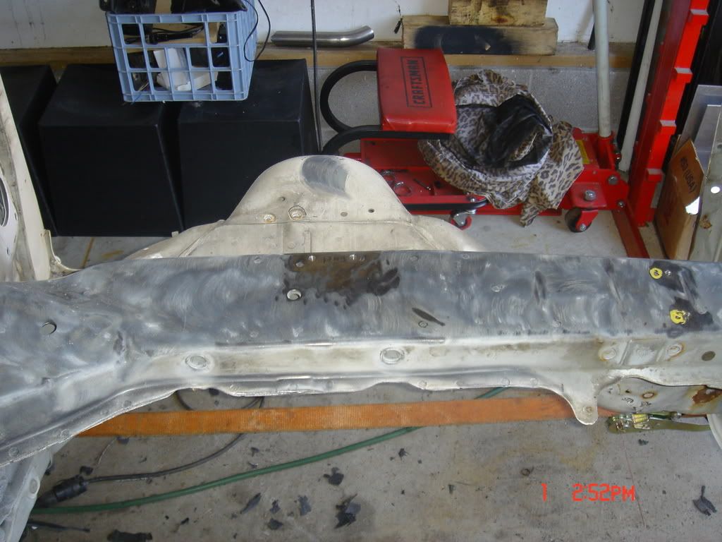

Ok well here is how the car looks now
And here is the under coating i have removed so far

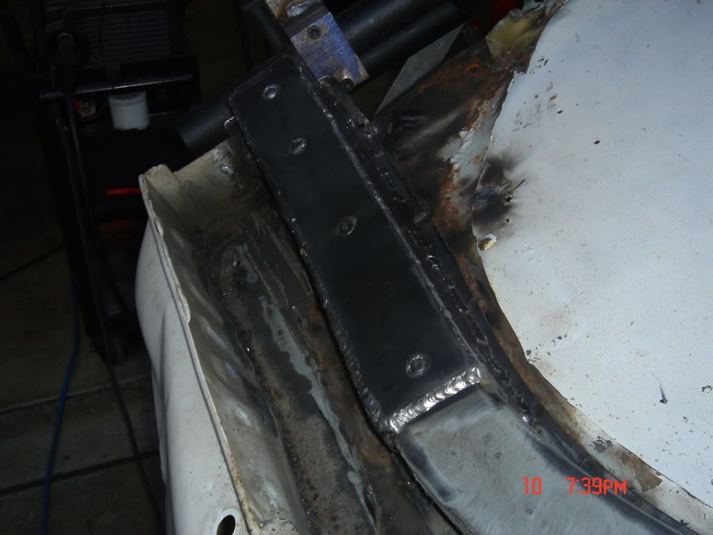

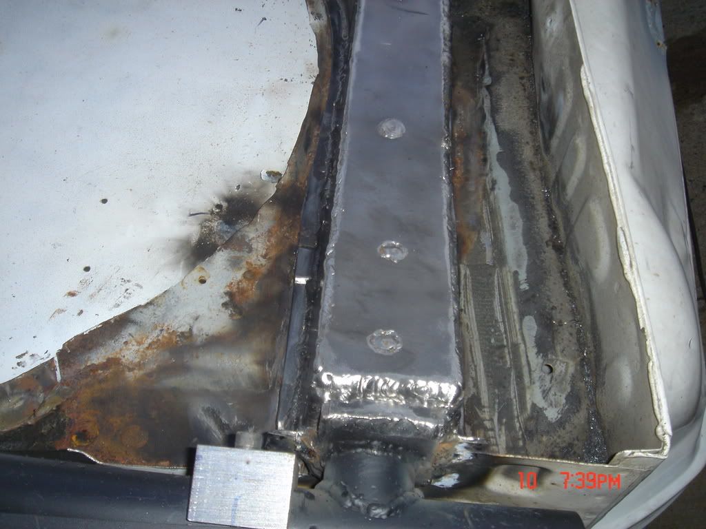

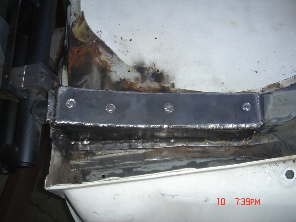

I have one of the rear frame rails all boxed in and i haope to get the other one done tomorrow. Im only doing this to spread the stress from the chute and strenghen it up so the chute mount and new frame section dont rip out one day at the track.

Well i have both sections of rear frame rail boxed in and about 75% of the under coating stripped. Iv just been bussy as hell getting ready for vegas and im not even going WTF.
