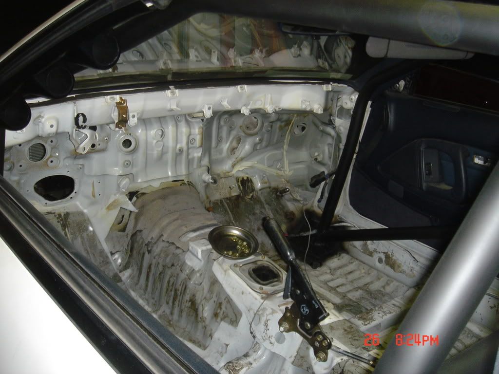

Thanks jake did you check out the thread i just started with the pics of my finshed cage? I didnt feal like posting all those pics here. So whos gonna be done first :naughty: Let me know if you wanna rool your fenders.

Wanna come help i know you do dave. Please:1zhelp: Thanks the cage was a fun fight to get how i wanted it.

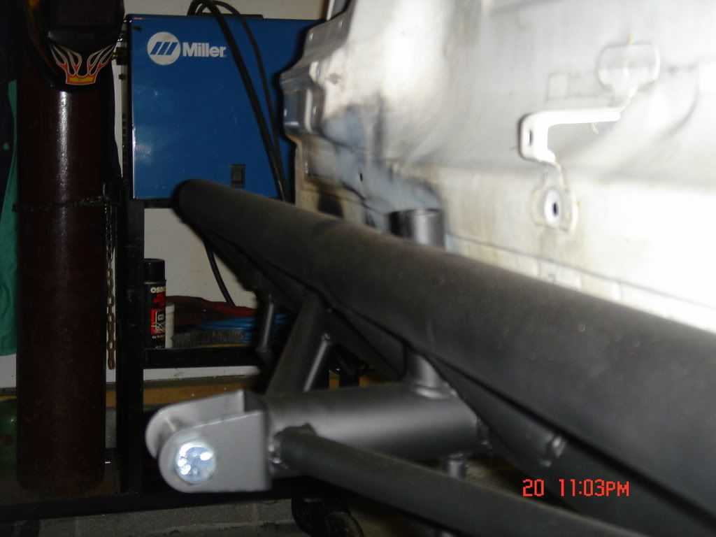

I did, and that cage is bad ass... I was looking at the back, is that for the chute? I wanna cage mine, eventually... I think I may, just for rigidity... *targa top* I also LOVE what you did with the rear sub frame... I see all this bein done, and I know eventually, Im going to have to do it with my car... I wish I could weld... A buddy of mine, the guy that does the custom welding on my car, once told me: If you know how to weld, you will never look at a car the same way again, because you will always know where you can improve it and you'll know you have the ability to do it........ That is so true...

That is verry true. Yea i firts decided to cage my car when i was driving trought my buddies back yard real slow going to the bond fire. I had my windows up and the targa off and i could watch the window gap at the a piller go from none to almost a 1/4 inch so that helped alot pluss i wanna go fast. And with the chute mount nhra says im legil to 8.5 or slower so thats good.

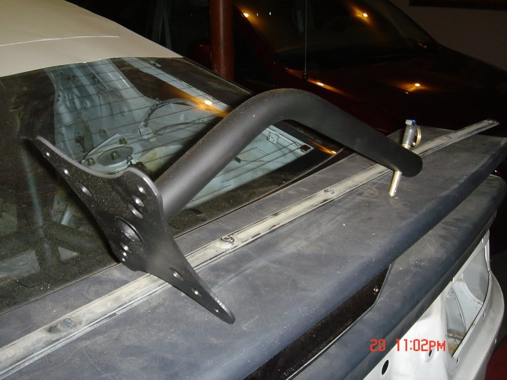

Ok well here are 2 pics of the chute pack mount removed.
And then i can pop a plastick body plug in the whole and it will look nice.

I wanna put a parachute on my car and drive to Wal Mart with it... ;) *I just wanna drive to walmart in my car, period, but eventually, I want a chute on it*

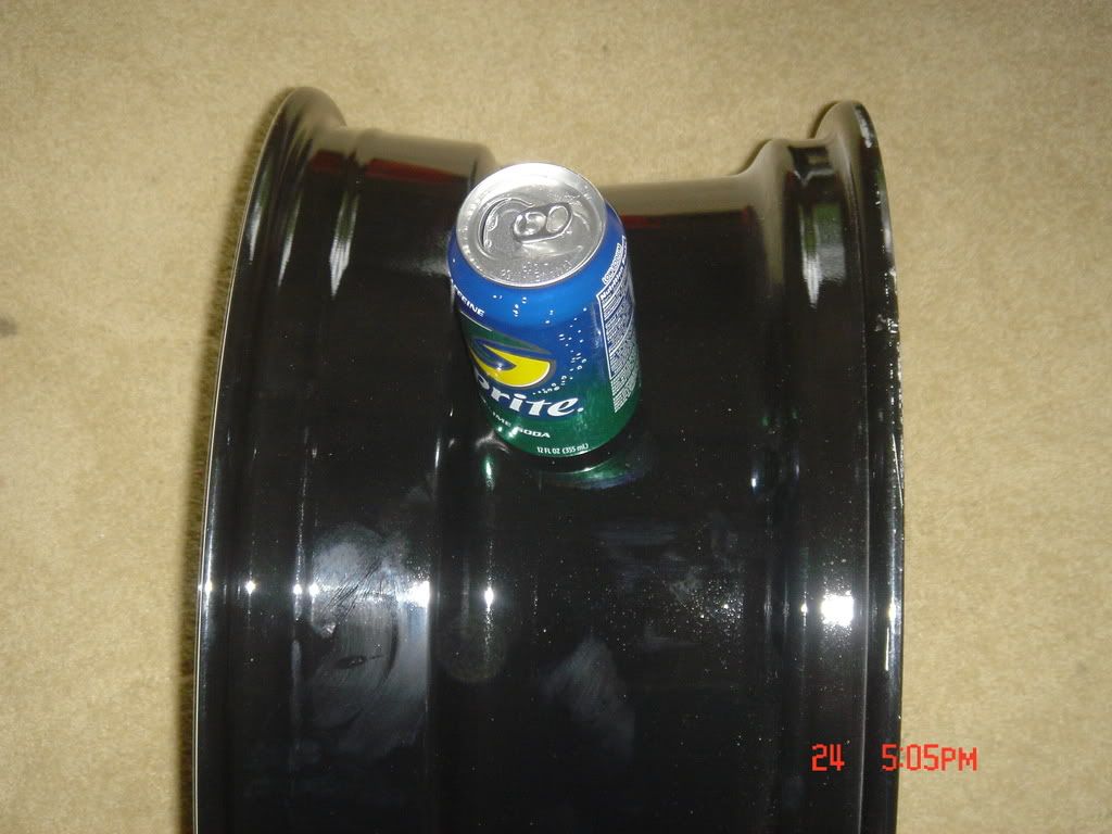

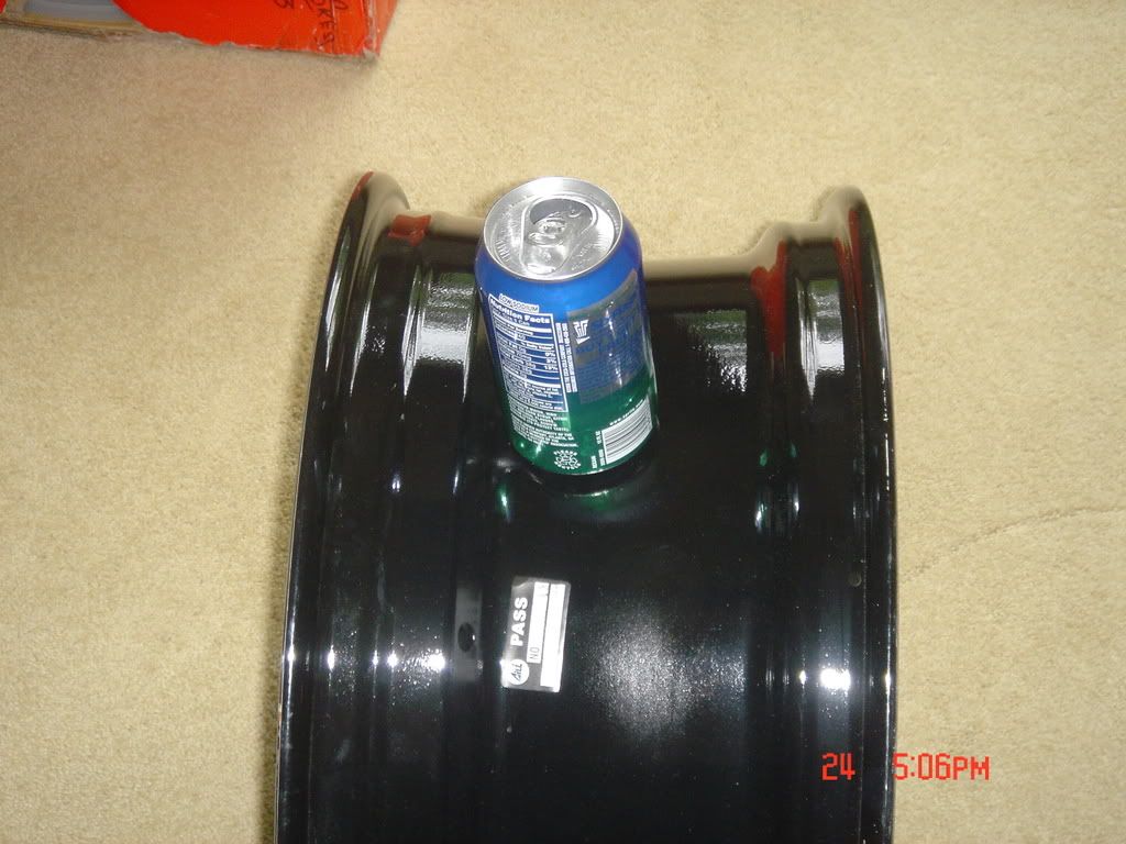

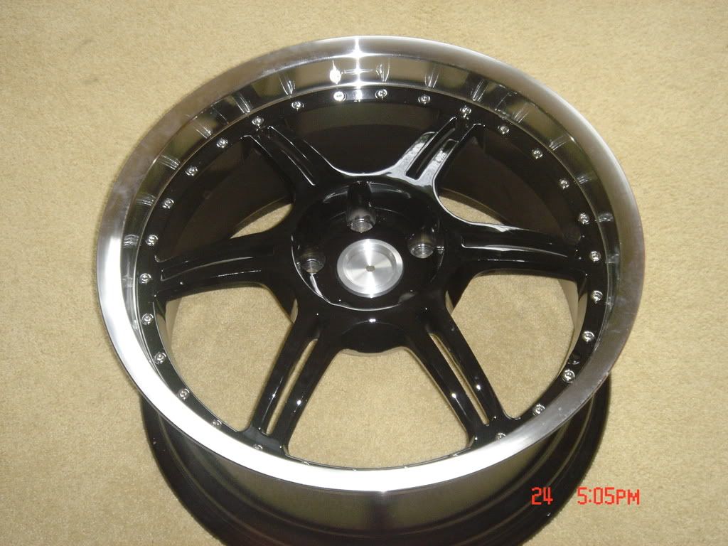

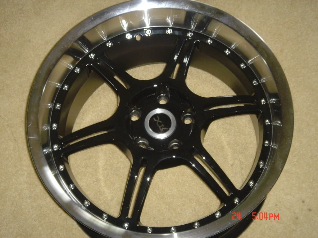

Well i got my new rims on friday.
Rear
Front

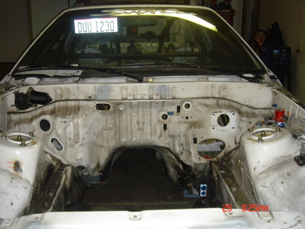

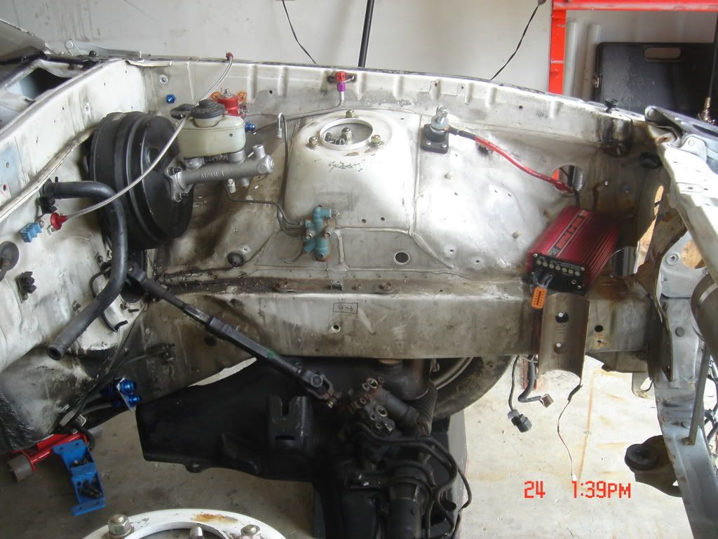

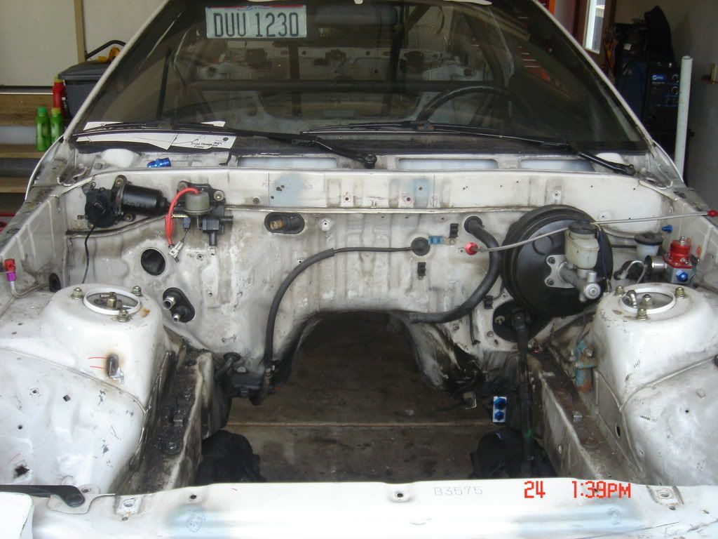

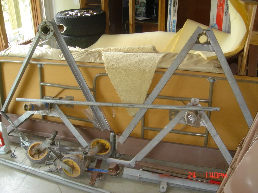

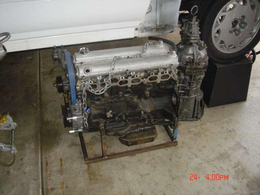

And here is what i did on the car today. Pulled the motor and trans out.
Built a stand to hold the motor on the ground for storage.
Hopefully the week i can start making the mounts to put my car on here.

Hey Wes in your one pic you have the tranny sitting on its bellhousing I had my 1st gear slip into place without the use of the shifting fork I had to break the tranny apart to disengage it! Just thought I would give you a heads up save you some grief.
Ok thanks for leting me know but im not to worry'd about it cuz im gonna be building it. How did it slip out of place?
lintlars
ROOTS RADICALS
Apr 1, 2005
631
Ft.St.John BC
My guess is at the wrecking yard this was a few years ago I finished putting in the used tranny, new flywheel, new clutch and the AL drive shaft and a 2way Kaaz, after getting it all back together I start it up and I let the clutch out and its stuck in 1st gear but I could move the shifter from side to side as if it was in neutral. I was Fuxkin pissed! Ya every time I see a tranny stored like I have to tell them.
joliroger4
Flying Dutchman Pilot
Apr 4, 2005
264
New Jersey
www.geocities.com
The selector lever moved out of position in relation to the shaft heads. That really shouldn't happen unless the trans lost one of the small snap rings that goes on those shafts. They limit the shaft from moving too far. Storing a good tranny like that won't hurt anything.
I had the same thing happen to me. Instead of lifting the tranny to carry it I rocked it back and forth on its bellhousing and put the tranny in to find it locked in gear, just pulled the tailhousing off with it still in the car and popped the gear back into the proper spot.

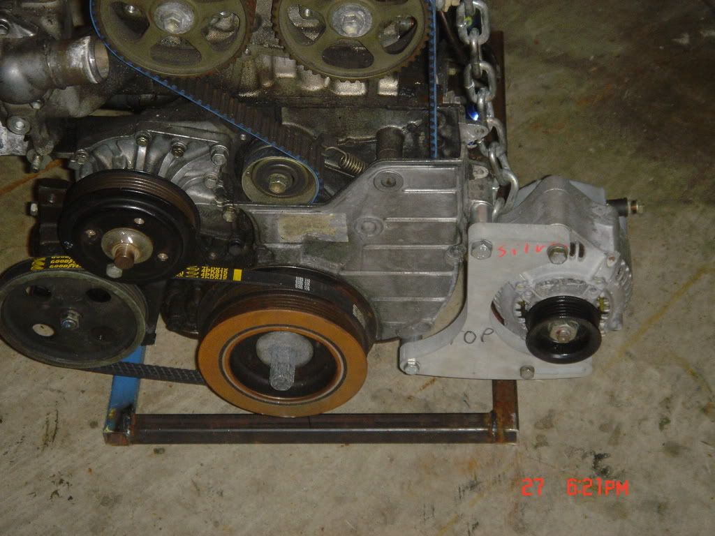

i went through 5 belts trying to find one that fit the best for that bracket... i would notch the bottom adjustment hole larger to the inside.
if you want the part number i used i'll go look for ya....
