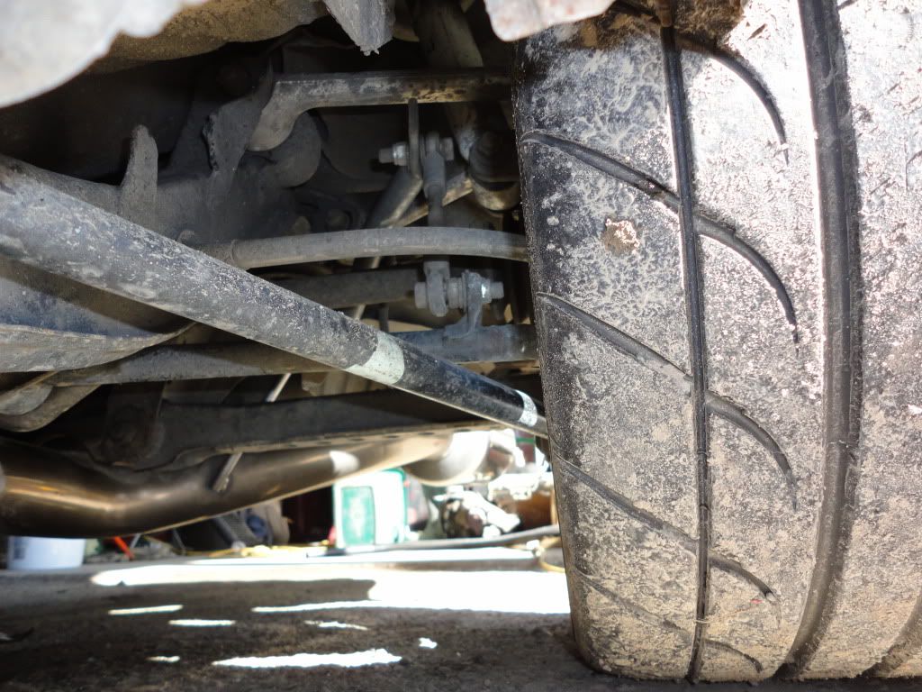

no link. never seen a writeup on it. all you need is heim joints, studs, threaded collars, and nuts. you put the stud in the heim joint (make sure you get ones that have plenty thread for the collar), thread a nut on down on each stud to use as a jam nut to keep the collar from spinning, thread collar on heim joints and adjust to proper length.

IJ.;1800346 said:
And end up with a rattly piece of crap on your car that offers no improvement over the stock links ;)
Ran stock 86.5 links on my car and it would sustain .95G on non R tires.
hahaha IJ i thought this is the tech section where you're suppose to go off facts not assumption. you say you ran stock links so how would you even know how adjustable endlinks perform on a mk3. :nono:
granted i only have them on the rear of my car and i put them on when i did the st sway bar set. i can say they don't "rattle" at all. and the car transitions from corner to corner much better. not to say its all from the endlinks but they are really nice to dail in how the rear responds for autox. there are two holes that adjust the rear st bar but its drastic. i didn't do the front because the rear alone really is all i need to get my car perfect for tracks or autox. again this is all first hand experience on my mk3. heres some pics. actually can't remember where i got those heim joints. i got them before i noticed ace sold them. and i actually didn't use a collar just a stud and heim joint so its even cheaper lol
