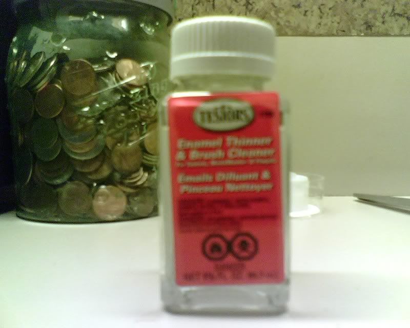

So I found something that worked incredibly well on the paint left behind. A little scrubbing with a hard bristled tooth brush worked wonders and doesn't damage the plastic in any way.
Testors Enamel Thinner & Brush Cleaner. I got it from the local "Michaels" for a little less than $4 in the model section.
The bottle looks like this...
5
45
After removing the paint (No, not ALL of the paint is gone, it's not really necessary to be honest. But, you have to make sure everything behind the lense is black, and you can't just put black on the back of the lense.)
