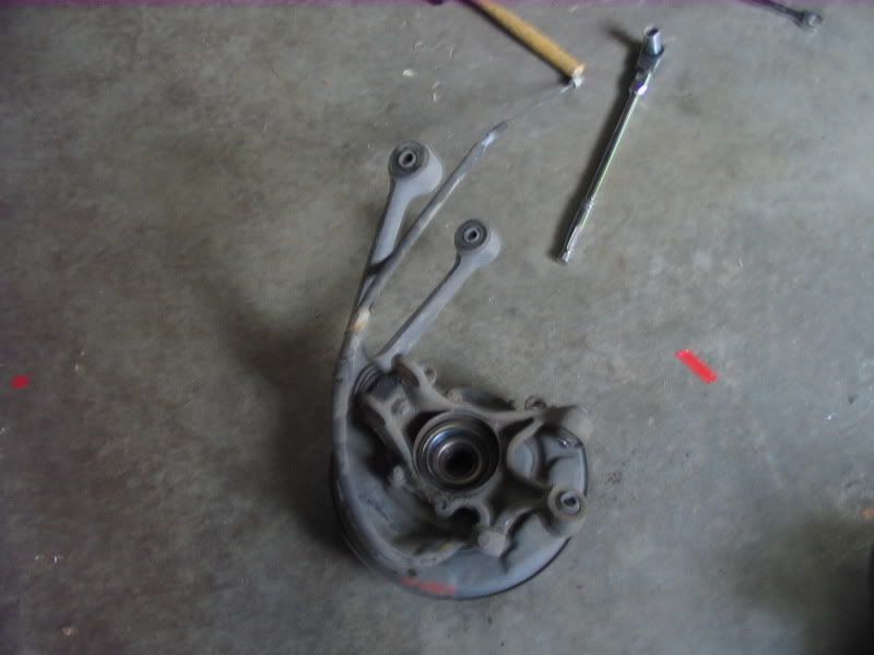

#04
Sep 7, 2009
526
Cambridge
^photo courtesy of nashman
the bushing in the 3'o'clock position did not seem to be included in the Energy Master kit, however my old ones were pooched, does anyone know if Energy offers this (or some other Poly company), as I would like to change ALL my bushings rather than all but 2..
