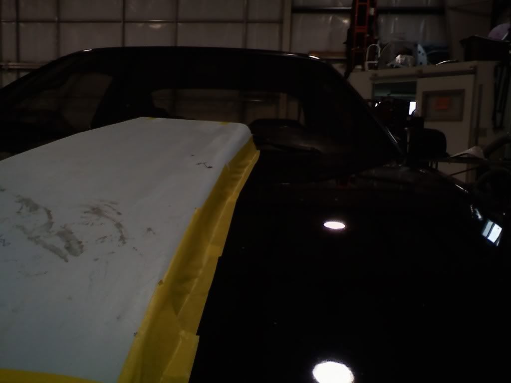

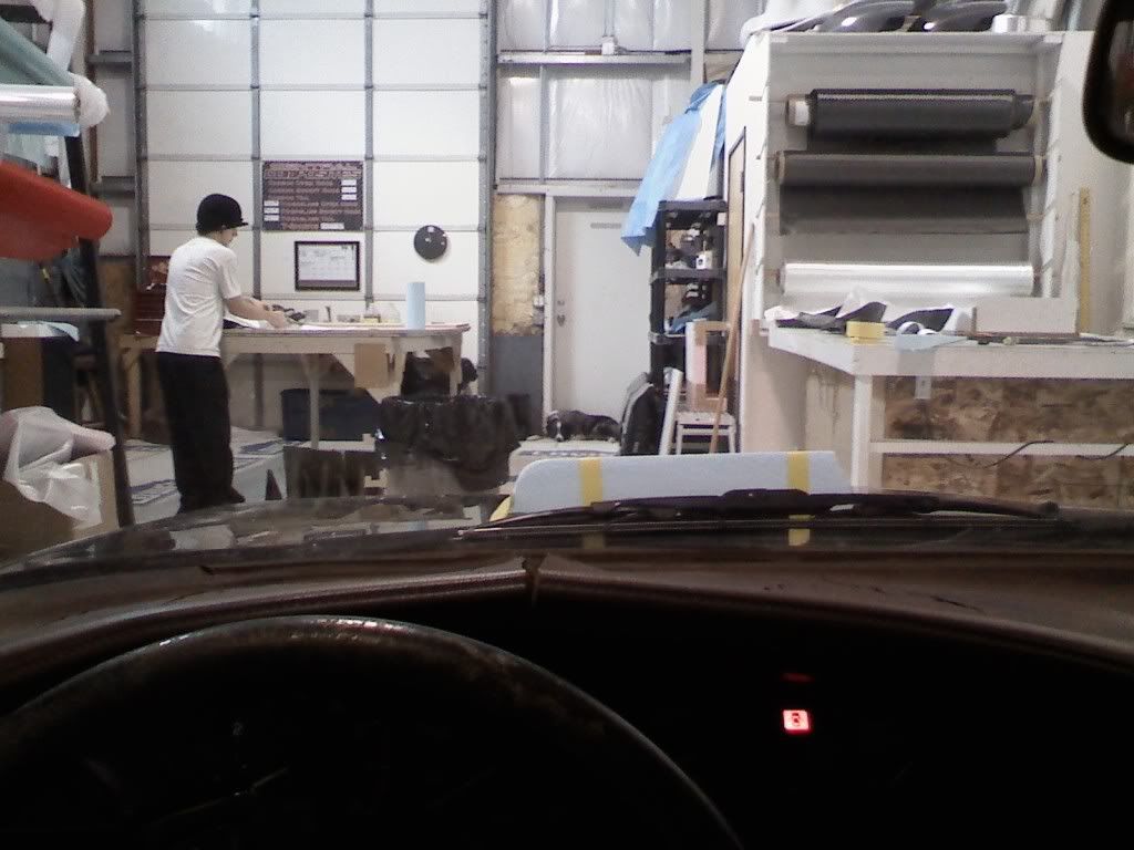

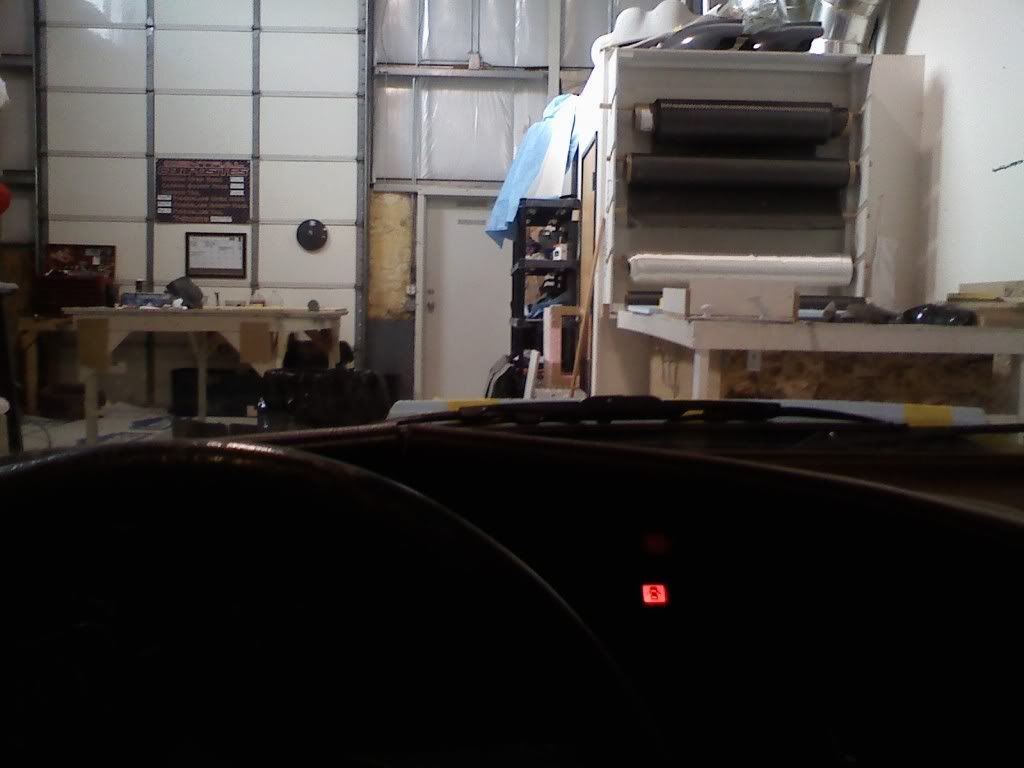

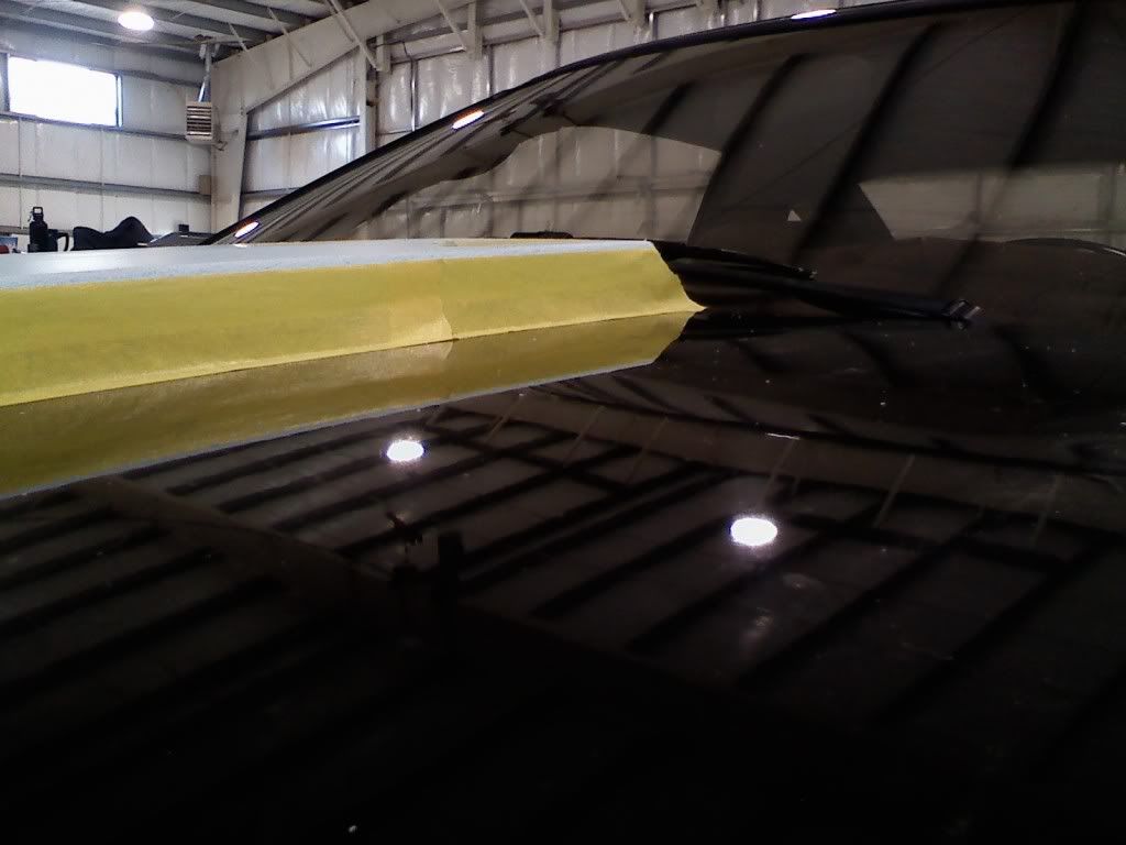

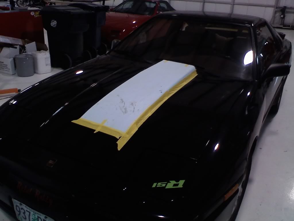

Posted below are some pics of mock ups that he did with foam. This is part of his process to get a feel for how to approach the project. You'll notice two different foam thicknesses and the 'In-Car' pics are to demonstrate view obstruction. **This is NOT how the Hood will Look!** It will follow the stock lines and resemble Tekdeus' hood. (I wanted to get that out there before someone has a heart-attack! ;))
It appears that the angle of the sides of the stock cowl are approximately 35-37*. To retain most of the cross-sectional width of the cowl, that angle will be increased to ~45*.
Stock cowl height is .5". This will be increased to 1.5".
