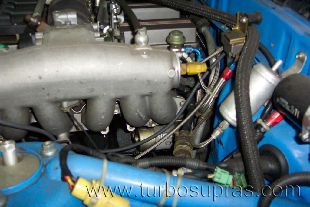

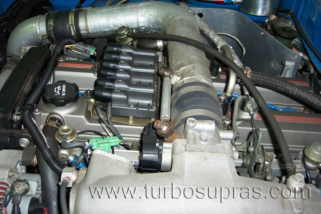

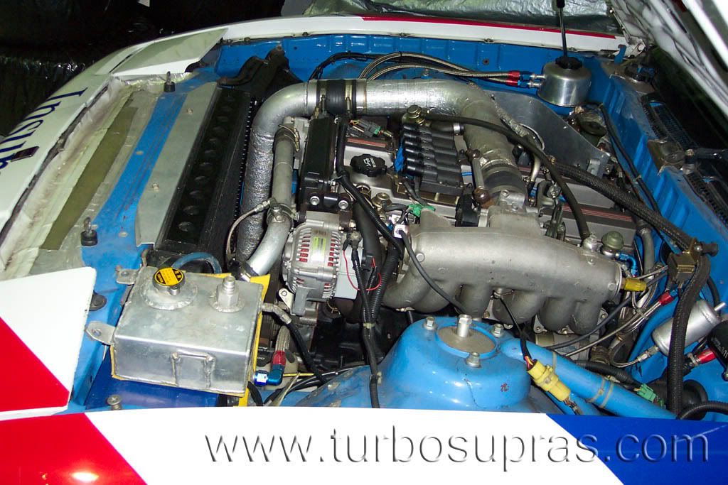

And i decided to post a pic of the Group A Supra engine for good measure

Almost wish you hadn't:cry:
Some crazy looking strut tower braces, no ISCV? whats that second vac line off the front of the intake manifold, powersteering up?
Wish I could see more, I like:)

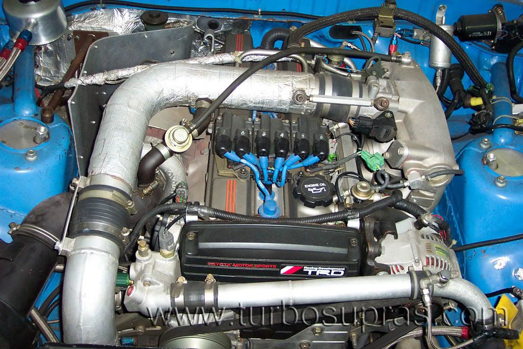

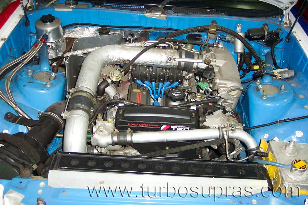

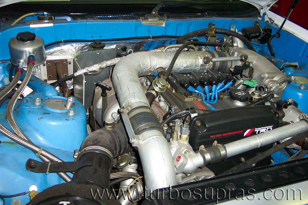

Your wish has been granted
