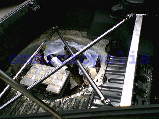

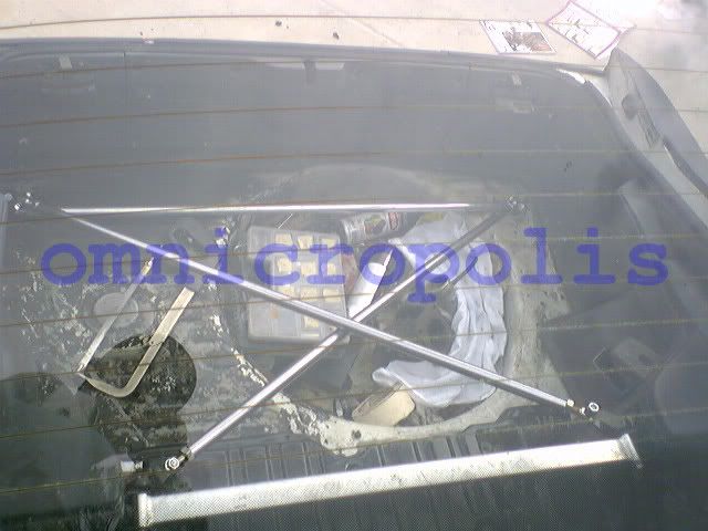

Here's the rear cross brace I just finished fabbing up. Ties directly into the frame rails. Four bars for 4 times the fun! The most important info though; yes, it still allows you to put the targa top back there.

stuvy said:
I don't have one, but I know someone that does, and its made by Cusco. Hes got a few other crazy weird braces back there too.
Pic? The only rear brace I was aware of that was even remotely like that was a YSR brace. But it was a box frame.

The spare fits in there just fine. I just happend to be using it as a "tool box" at the time of the picture.

5 min tire change has just been turned into take everything out of the trunk 20 minute tire change.... :rofl:
Looks good though....... :bigthumb:

I Love it, how much of the stock interior fits back in there?
It's like your own personal rear cage...

looks nice, but is there a reason to brace anything behind the rear axle? i ask because i can only think of reasons not to.
