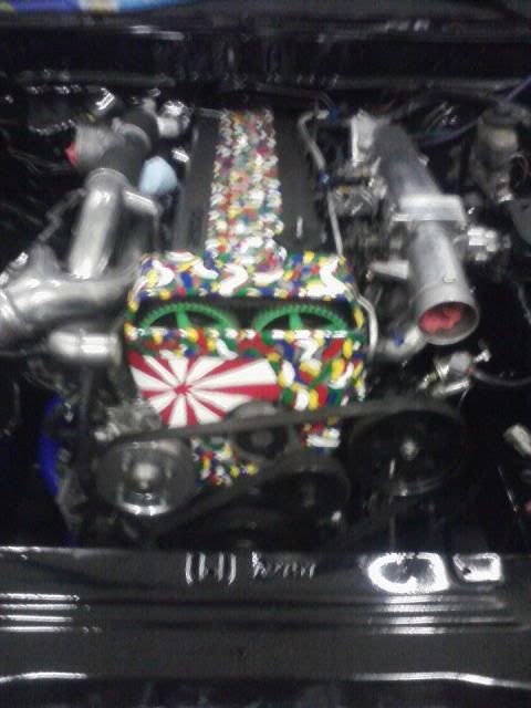

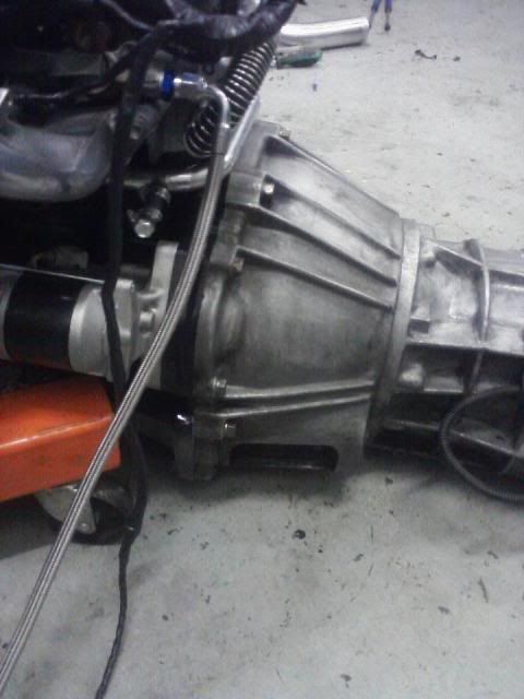

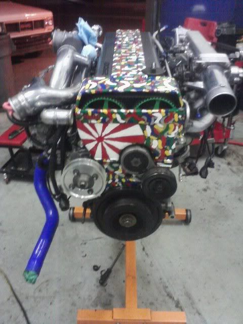

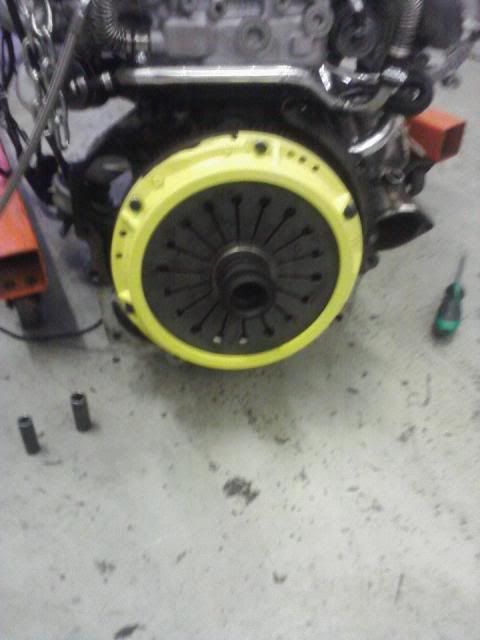

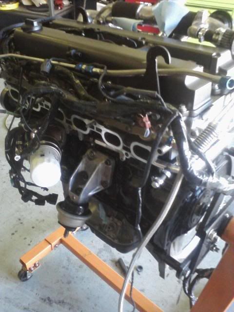

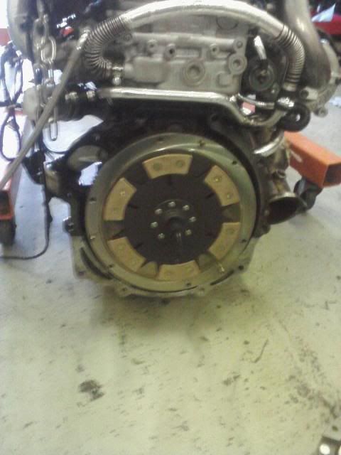

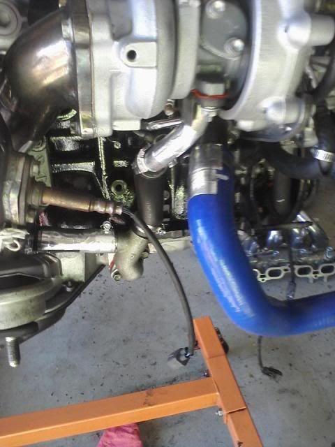

Turbo Oil and coolant lines all done..
Fuel dampener bypass
Wiring Harness put back on..
Engine coming together..
6 puck..
Clutch installed..
Trans bolted up..

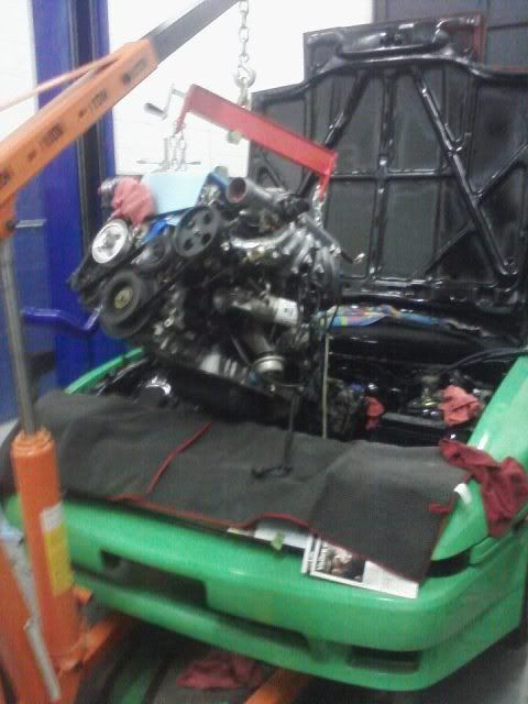

1j almost back in its home..
1j back home..

Ooohhhh me likey, the engine paint goes good with the car color.
That clutch is gonna grab like a drunk redneck in a titty bar. Should make for some nice clutch kickability.

kotu100;1809603 said:
Ooohh this i did not know
Unsprung hubs are very hard on transmissions. Without the sprung hub, the shock delivered on shifts to the tranny is pretty brutal. They can be driven safely with proper rev matching and techniques, but they really put a lot of strain on the whole drivetrain.
Supracentral
10,542
12
kotu100;1809610 said:
I see, so whats the upside to an unsprung disc if any?
Faster shifts and the clutch disc itself becomes nearly unbreakable. The springs on sprung hubs sometimes get torn up on very high horsepower applications.

Yeah we will see how the unsprung goes... If i hate it im not out that much cash but i just didn't want a slipping clutch.. Ive heard people love and hate them and i want to make my own opinion on them.. but i do have the clutch safety switch mod so i dont have to push in the clutch when starting it as i heard that with the higher pressure pressure plates and the unsprung hubs it can cause crank walk issues if you push the clutch in on start ups..

Zerocool;1809523 said:
Jake, why did you go with a none sprung disk?
Sent from my ADR6400L using Tapatalk
Friggin gay eclutchmasters.. showed a sprung hub in pic and thats not what it came with.. litterally cheapest clutch to hold the most power.. but if its as bad as you all say then a 6 puck sprung hub friction plate is only like 60 to 80 bucks..
