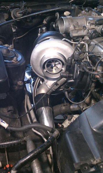

Put the rest of the turbo on. The return is a tight fit. The turbo will have to be clocked slightly which you'll notice. Otherwise everything is going fairly smoothly :)

Started w/ Turbo on :) No comp cover as it's out for welding. Turbo spinz!!!

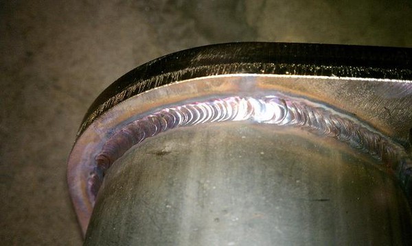

Here's the only piece I managed to get done tonight, but I'm glad I got it done because I suck at fabbing and I thought getting this angle just right was going to be a biatch. Took me a couple cuts and test fits to get the angle just right.
Gettin that angle juuuuust right
attachment.php
Done, just need to get it welded up!

Huge thanks to Momin (Speedfreak) for taking the time to weld this up for me, and Aaron for lending the equipment!

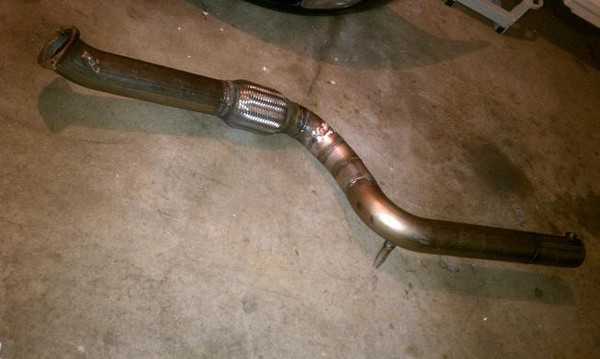

Got some more of the exhaust done. Pretty much the entire 3" section is done though. I still have a 3" resonator I may put on yet, but not sure if I'll put it on yet...

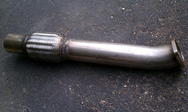

Used the old flex section from my Talon exhaust. Had it so figured might as well use it.

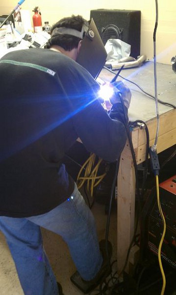

Momin workin his mad TIG skillz :) Thanks a million again, especially for dealing with my crappy fabbing and doing your best to make it all work! And also thanks again to Aaron for the equipment!

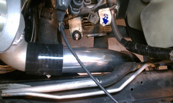

More IC piping mocked up.

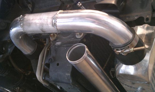

Got a fantabulous pie cut style bend rigged up to get around the hotside. Not the most beautiful arrangement ever, but it is temporary until I eventually switch to a forward facing intake manifold. So it'll do just fine for now I think. Welding it might not be so fun...

Dropped off the pie-cut ghetto bend to get welded, should be done Friday. Got all the other stuff back from him. Thanks again Momin, your TIG'in skillz are awesome!!

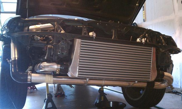

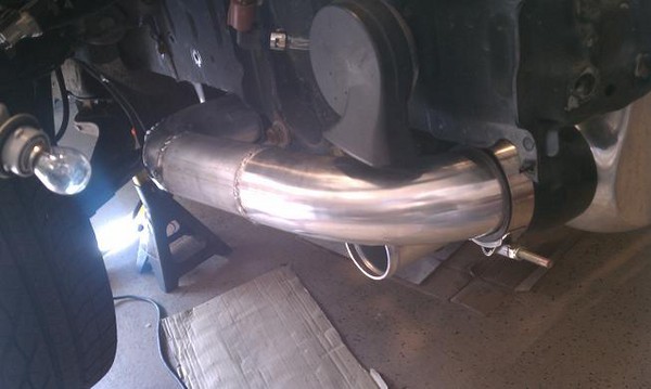

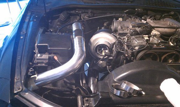

Got things fairly buttoned up today. The piping is all done. You can see I had to do a little special something to the TB because it was hitting the massive BW exhaust housing. I'm referring to that as the "ghetto bend" from now on.
I do still need to add a bov flange to the piping, but I may take it for a spin around the block as-is.
