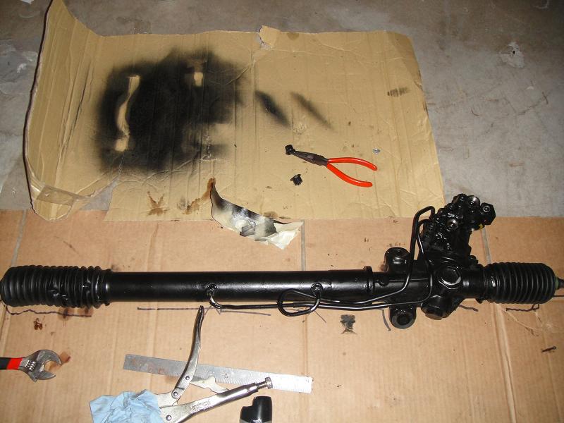

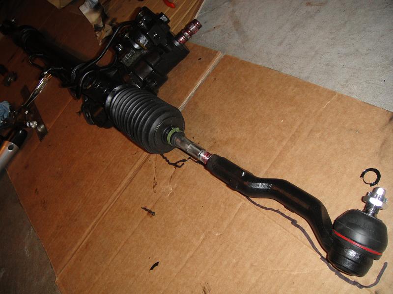

Replaced the steering rack with one from Vatozone w/ lifetime warranty. Also installed new tie rod ends on it from Rock Auto. And also installed Poly bushings for the rack that I bought from TME.

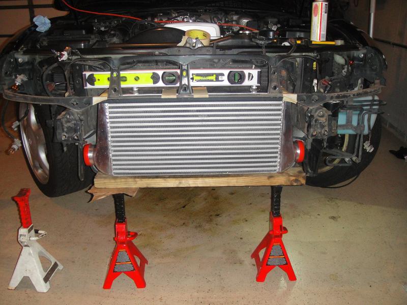

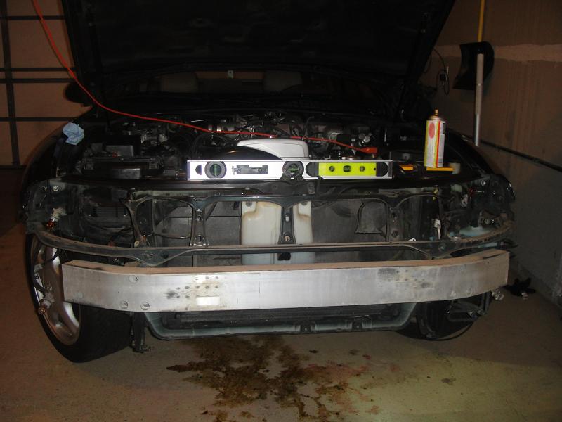

I'm still waiting on an EMS setup so I've decided to start doing some 'non-intrusive' mods that won't affect the current drivability of the car. So....
Initial mock-up of the FMIC is done. Couple notes are that there is a TON of room in here to fit this thing. 4" thick intercooler, and zero trimming of the bumper will be needed. Also I ensured to put it high enough so that the bottom of the FMIC will not be hanging below the bottom of the front bumper, which I made sure of because I've seen quite a few other ones setup like that and it looks weird IMO. I got it perfectly level at the moment (made sure the car was level first). Also I took a picture to show the gap between the FMIC and the A/C Condenser. Lots of room in between there. I would have pushed the core back further but the A/C lines would then be blocking one of the inlets of the FMIC, so that is why it is placed exactly where it is. If I could have tucked it back further, I may have been able to retain the factory coolant reservoir but nope, so I'll just be using the old reservoir from my Talon. There's 2 horns. I remounted one a little more out of the way, and the other I will either remount, or just remove as I don't feel like I really need 2. It alsoit looks like I will be able to retain the stock crash beam, but for weight reasons I may just leave the sucker off, we'll see :) And lastly, doing this made me notice part of my bumper is broken (you can see in the very center the plastic grill piece is broken in the center) :( ghey, but whatever because eventually (probably not unilt next year) I plan on switching out the the 97+ bumpers so not a huge deal.
OK so here's some pics. Probably be making a trip to Lowe's later for some lengts of aluminum angle to mount this in place.

And she's mounted. Used some Aluminum Angle up top to hold it up and in place. It stayed up and in place real well with just those 2 brackets, but since it's thinner metal up there it could swing a little bit if you pushed on it.
