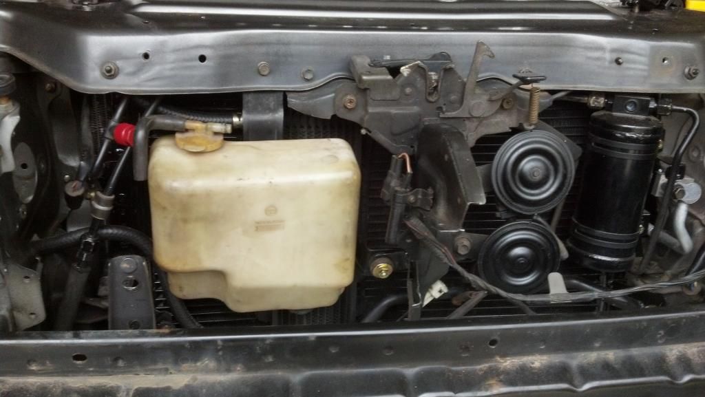

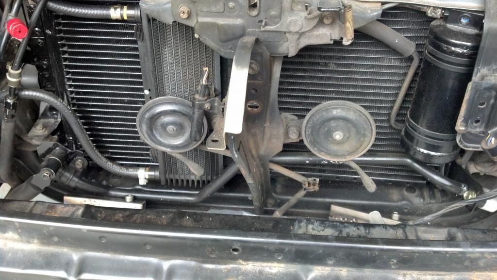

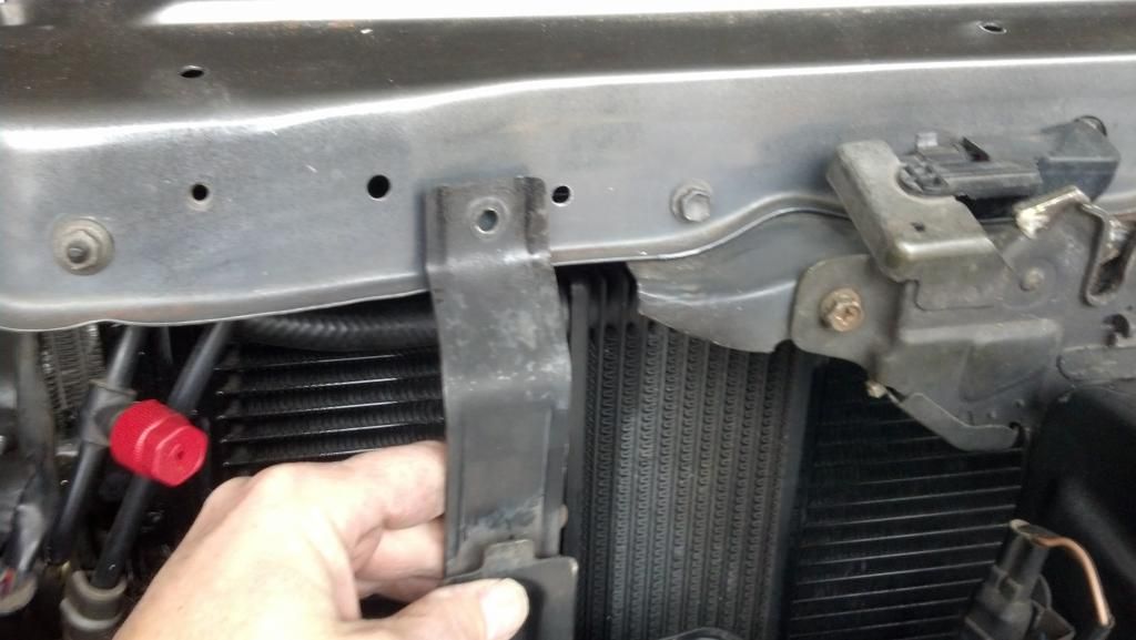

Today, I took care of a few more little nagging issues.
My Driftmotion intercooler made slight contact with the front center nose/ latch support, so I had to notch a bit of clearance into it. Also, the coolant overflow bottle interfered with the intercooler, so I decided to relocate it to the other side. This also required the relocation of the right side horn to the left side.
As it was.

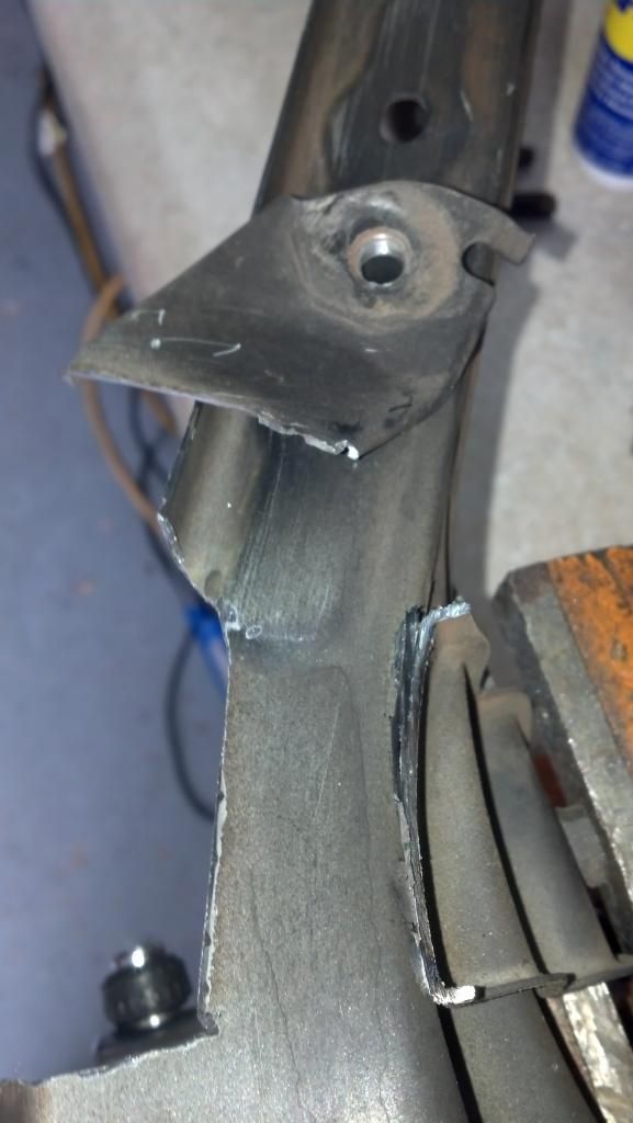

Cut the right side horn tab off, and notched the support for the IC.

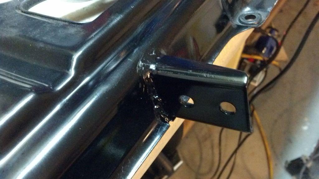

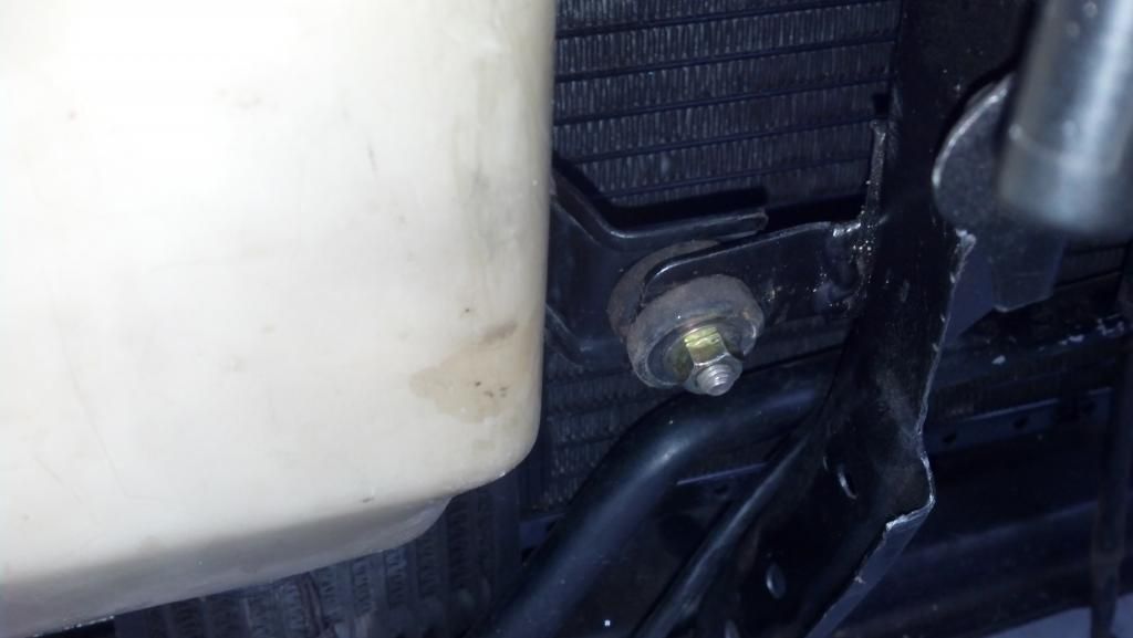

Then, I drilled a mount hole for the coolant bottle bracket.
Then, welded a bushing tab to where the old horn mount was, for the lower bracket mount.
And here's what it looks like, all reassembled.

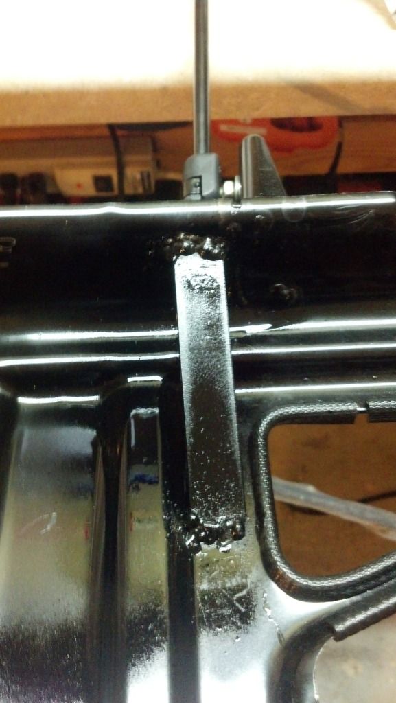

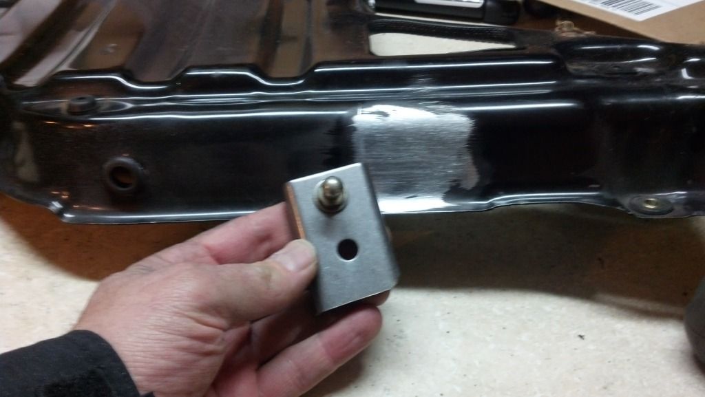

Got my weld-on mounting tab in the mail, so I put it to use.

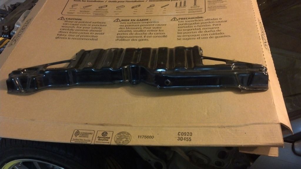

Rear hatch cover support. This is the piece that straddles the floor between the rear shock towers, and the hatch floor mounts to its back edge.
New tab
Welded.

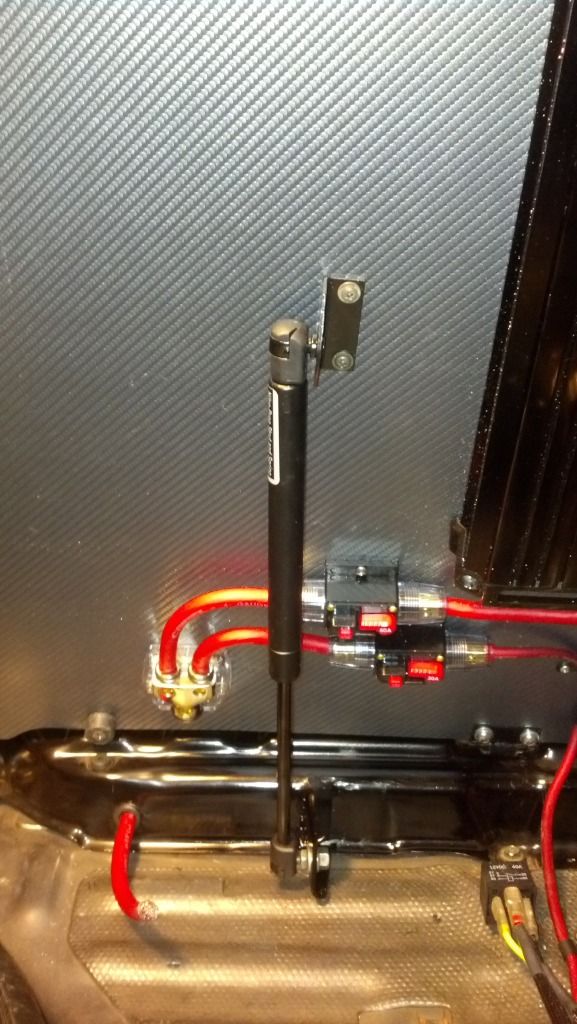

Underside brace.
Installed.
It holds the hatch floor up, but just barely. I bought a 30lb strut, unsure of how strong it would need to be. I think I'll end up replacing it with a 40lb unit.

Well, the hatch floor cant be opened when the targa is blocking it, so it's not for that scenario.

No, due to the strut position, it has zero leverage in the closed position.
