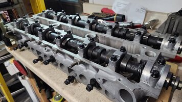

Ever since I rebuilt the engine back in 2012, I've always had an issue with oil burning. I thought that maybe it was a drain backup on the turbo, so I bought a better one- no luck. Then I thought, maybe I idled it too much, without putting a proper load on it, causing a poor seating of the rings. Perhaps it is. But I also thought that maybe it was that I didn't seat the valve stem seals in place properly, so recently, I tried replacing those with the head in the car, since I also had a new pair of BC cams and springs to install. After putting it all together, she still burned oil, and made the usual smoke screen. So a few months ago, I decided to pull the head, and check the head gasket, because after using a borescope, it seemed that there was a trail of burned oil coming from the mating surface on most of the cylinders.
Well, after pulling the machined, 0-mile head, I measure it and discovered that although the mating surface was dead-straight, the cam surface was .025" warped. Basically 3 times the limit. Apparently when I sent it to the shop, they decked it without ever checking it for straightness. So.... after finding a good used head, I sent it to the machine shop to have it checked, and got a three-angle valve job. I ordered a fresh set of valves for it from an online seller, but when I tried to install them, I found that most of them were going to require a shim thickness of 3.3-4.2mm!! WAY over the norm. Looking at the valves more closely, I finally realized none of them were fully seating; They're oversize valves; .5mm larger than stock, lol.
SO....I took the head to a different shop, had them cut the seats to accommodate the new valves, and ordered a fresh 2mm head gasket.
Finally time to reinstall the head, right?
Well, just before I tried to lay the head back on the block, I decided to reach down and verify that the oil pump driveshaft wasn't doing anything weird, since a number of people on FB lately have had issues there... Sure enough, my driveshaft pulley moves in and out by over 3mm. So now, the entire block has to come back out, to check for oil pump/ driveshaft damage, and do the necessary upgrades. So this weekend, I'll be pulling the motor and starting a full tear-down of the zero-mile block. I'll post pics soon, wish me luck.

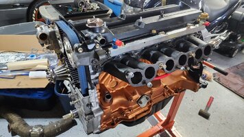

So, for those 4 or 5 of you that still get nostalgic and peruse the build gallery, here's an update.
I've finally completed the rebuild of the brand new, 10 yr old engine, lol.
I don't have too much in the way of pics, but the rundown is:
All new clevite bearings, new Wiseco piston rings, new cometic head gasket.
Fully rebuilt head with oversized stainless valves, BC 264 cams, BC springs,
Rebuilt oil pump driveshaft with newly fabricated collar, SR Fab needle bearing retainer.
Hopefully, this will address the oil burning and reliability issues moving forward. I've reinstalled the engine,
and I switched back to oem 440cc injector and the oem afm as well, in order to build a base map for the DET3.

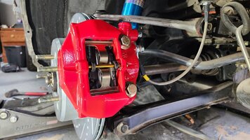

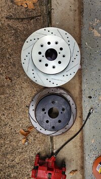

I also replaced the stock(brand new) rear brakes with the Poor man mods LS430 setup. Looks a bit more proper, behid the 18" wheels. I also replaced the hatch struts, since they were struggling a bit. Next step is to finish the final fitting of the carpet, then install the center console and the seats. Then reinstall the quarter windows, then the hatch area plastics.

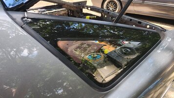

I finally installed new front and rear Kenwood speakers, and also a pretty cheap Kenwood head unit.
I know that getting the sound system in isn't really a priority, but I wanted to make sure that all of the wiring to the speakers as well as the amp, was fully functional. All good there now. Center console is in, I finally stripped the targa seals from the car and the top, and at this point, there's really nothing left to do to the car prior to paint. So the car is going to dent removal next week, in preparation for THE Actual Paintjob! A couple of pics:
Microphone install for the radio:

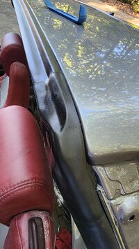

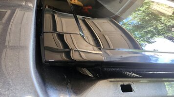

Well, the eternal project car got loaded up, and headed for PDR last week. She is now completely (as far as I can tell) dent free. Next Monday, she gets loaded up again. This time, headed for the paint shop. Then the long pain-staking task of reassembling her. You can tell by the other cars, that I'm into grey.

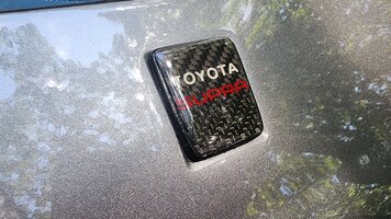

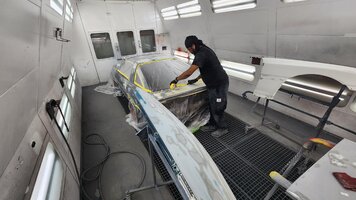

Updates: Well, she's back from paint, and while that bill was a bit painful, I'm happy to say that we are now on the final stage of "Project: Get 'er dun"- Rebuild. Here are some pics of what's been going on for the past 2 weeks.
Prep work for paint

New carbon badge. Can't recall who was making them, but hopefully they will see this.

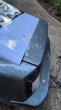

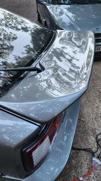

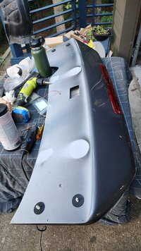

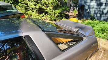

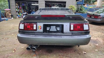

I finalized the install of the Kaminari tail.
Installed PPF on the top of the decklid, and used stainless studs and locknuts, to make it solid. I didn't want excessive metal flex on the lid, so theres also some metal reinforcement inside.

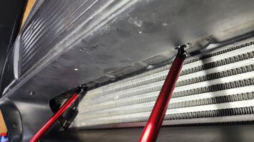

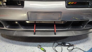

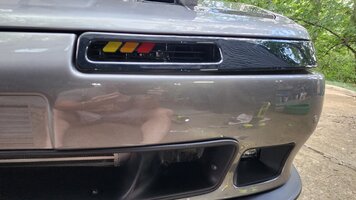

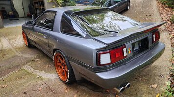

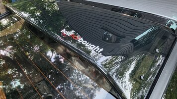

Well, a small update-
The hatch visor is on, and the front left trim/ side marker. I accidentally busted the right side, because it was hanging off the car, and I caught it on my pants. I'm now waiting for Mr. Martinez to send me a replacement. Not sure how long that will take, as apparently, the replacement got lost by UPS. So, technically, I'm waiting on the replacement of the replacement.
I also installed the Kevin M turn signal cover, to see what it looks like. I have to wait for the passenger side trim, before I can install the turn signal and other cover. You can also see that I decided to add two splitter rods to the front lip. I was afraid that at highway speeds, it might begin to bend down in the center, and also, I kinda wanted the over-the-top look.
In fact, the entire idea of this car is to make it slightly over the top on styling, without going full retard.
Anyway, enjoy the pictures.
PS- It was nice of Toyota pre-install the threaded mounting holes for the rods. I just screwed them in by hand.

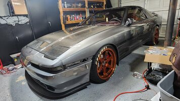

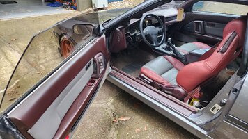

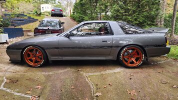

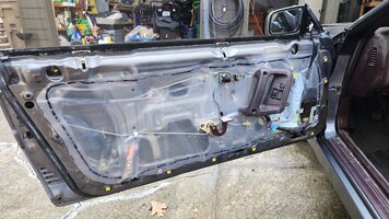

So today is my birthday, so as a gift to myself, I insured and registered the car for the first time since 2011.
I was planning to test drive it tonight, but I'm going to hold off till tomorrow.
Here's some walkaround pics, and some of the door work I was doing this past weekend.

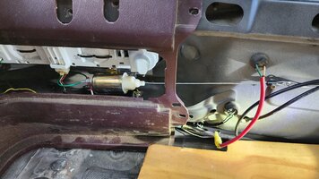

Remote hatch release:
This picture is really neat because it made me wonder if it was an early gen Celica or older American muscle. I had no idea it was the Supra with everything off and at that angle!
Love that you never gave up on the car!
How bad was the paint bill? I want to have paint done next year and I am dreading the cost.

Hey Loc-
The bill for dent removal was around $1600, and then it went to paint. The shop i used went above and beyond, removing the hatch and doors to get into all the back edges, and they removed the windshield, to address a slight bit of corrosion. I also asked them to clear coat the CF hood, to add more gloss, and improve long term UV protection. All in, it was around $8300, so the bodywork essentially came to just under 10K.

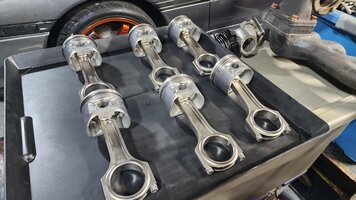

Ever since I first assembled this motor, it has had a terrible oil burn issue, which I've mentioned a few times, over the years of this build. And during this time, I've suspected a number of issues:
1. The turbo drain backing up. So I bought a better cnc drain fitting, and visually checked drain flow with a clear silicone drain line. No improvement.
2. Bad piston rings on the new turbo. I thought it might be a freak manufacturing error, so I replaced them. No improvement.
3. Leaking MHG. So I replaced the brand new MHG, and retorqued the ARP's. No improvement.
4. Leaking valve stem seals. Replaced the new seals, with NEW seals. No improvement.
5. Bad head. I DID find out, that when my head was machined, they decked it without checking straightness. Turns out, it was warped and after decking, that meant that the cam saddles were warped. So I replaced the head, and added BC springs, stage 2 cams, and oversized valves. No improvement.
6. After this, I discovered that the oil pump drive shaft needed a new collar, so I pulled the entire engine, installed an SR Fab roller bearing shaft retainer, custom machined collar, 5M oil drive pulley, and re-honed / re-ringed the brand new Wiseco pistons, thinking that maybe I had installed them wrong, or I had a bad hone job...
NO IMPROVEMENT.
So, what's the problem? Why am I burning so much oil?

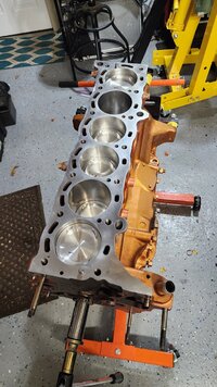

Well, I decided that perhaps the bore job was too wide, or perhaps I had screwed up again on the ring install. So I pulled the engine AGAIN, last week. I did find that compression in cylinder 1 was about 15psi lower than the others, and borescoping all 6 cylinders, showed fresh oil sitting on top of all the pistons. However, Upon removing the head gasket, I noticed that there was fresh oil all over the block's deck, stemming from the front oil feed port. I NOW suspect that the original deck job on the block was not as flat as I needed, and that oil was pushing up under pressure, out between the block surface and the gasket, and pushing into the cylinders.
SO...The block is now at a different machine shop, being bored to 84mm, and getting a fresh deck job. I also asked the shop to do an initial inspection, to verify that there's no cracks or defects.
I am moving to a set of 84mm Wossner pistons, and will be using an HKS stopper type gasket, instead of a cometic.
I've had good luck with Cometic on my daily car, but didn't want to skimp on this motor.
Hopefully in about 2 weeks, I can reinstall this thing, and with any luck, my oil issues will be gone.

Once I got the block back from the shop, I checked the deck surface, and STILL found that there were some low spots, and the finish was not really up to the smoothness requirements for a metal head gasket, so I hand lapped the surface, until it was almost a mirror shine, then did the same for the cylinder head. I don't want ANY leaks, period.

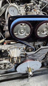

The head has been reinstalled with the HKS stopper head gasket and new dowel pins. Once I installed, I set the intake and exhaust valves to a fully open position in two different cylinders, and ran the crank up to TDC for each. I found that while there is NO contact between the pistons and valves, the visible gap(on a borescope) is almost impossible to see now, so I would say that there's less than .5mm clearance. This is due to the larger valve faces, new pistons, and BC cam lift. In the event of a broken belt at high RPM, I wouldn't have any confidence that they would clear. So I'm now considering this an interference engine.
I also found that the turbo's outlet flange, and the mating surface of the exhaust manifold, were not perfectly flat either, so after filing and cleaning, they should seal perfectly as well. Crank is in with all new bearings, and today I will install the oil pan. I also replaced the wastegate setup, because I had made a very complicated and leak-prone recirculation system, that I just didn't like, and added an HKS- to-Tial type adapter, and will just have it dump to atmosphere, rather than tie back into the exhaust.
She's almost ready to install again.
