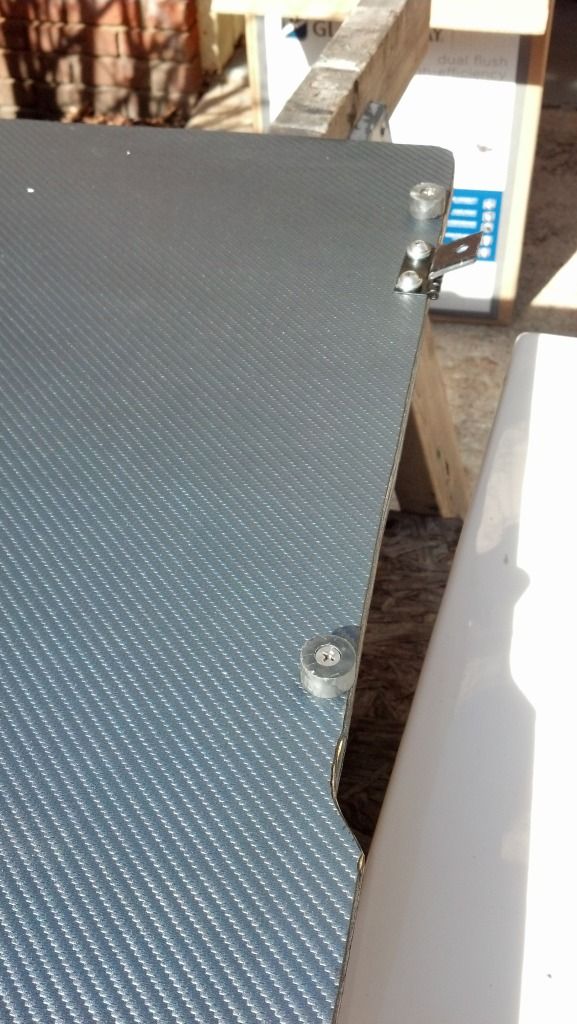

So today, i spent a bit of time creating some supports for the rear deck cover.

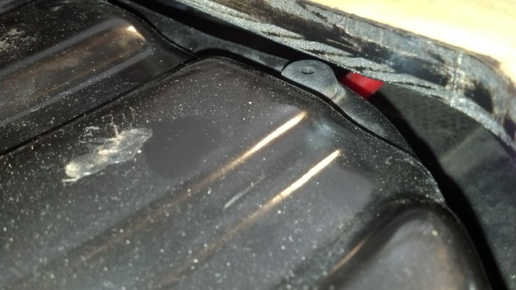

Being that it sits about a half inch higher than it used to , I needed to make 1/2" posts to support it, otherwise the hinges would take all of the weight
if I were to put anything heavy back there. Here you can see the gap:

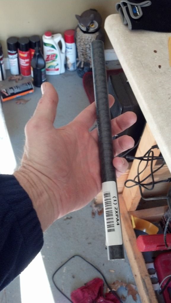

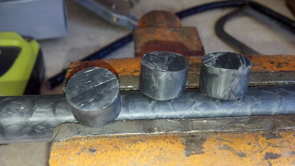

I started with some 3/4" nylon rod: (the owl is not impressed)
Cut it into 1/2" discs:
Countersunk some stainless bolts, and placed them in where they could rest on the rubber bumpers:

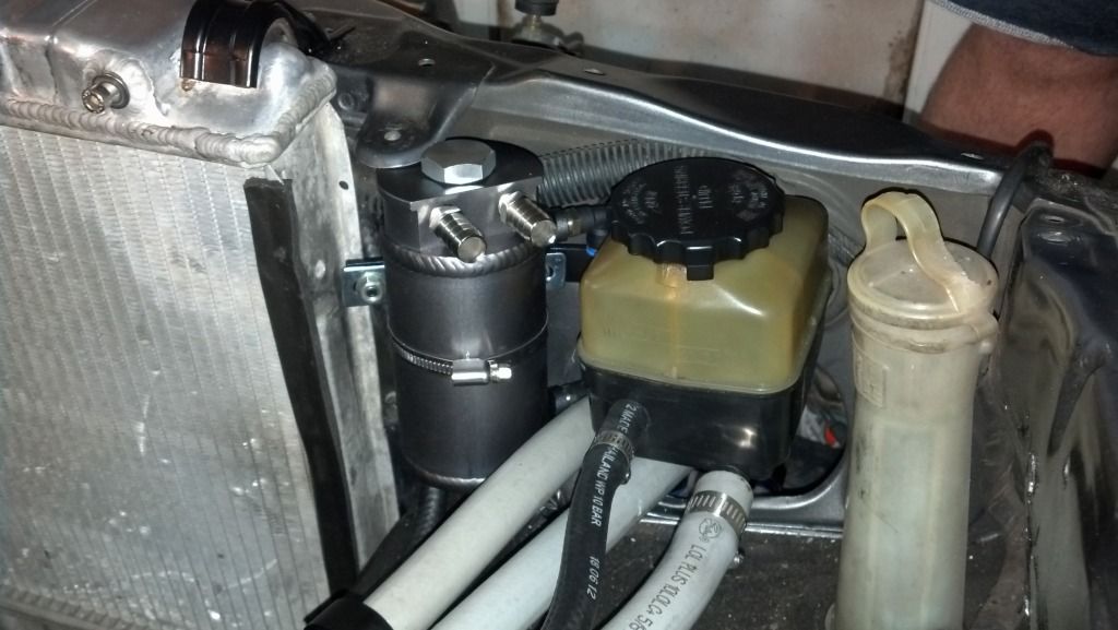

Then, I finally got around to creating a mount for my catch can. It's simply welded on to the side of the ps resevoir mount:

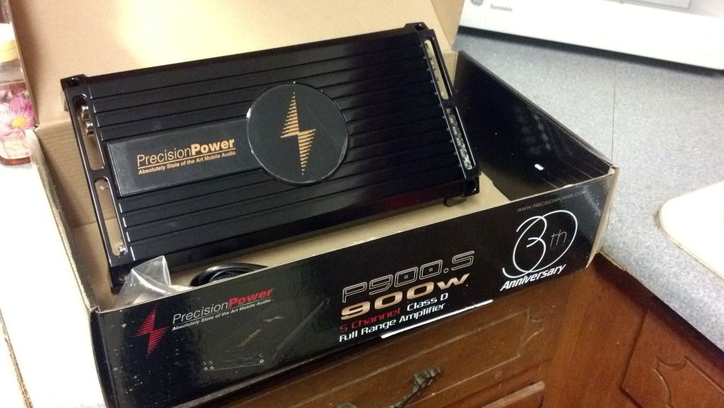

Finally got home and opened a couple of presents. Here's one I got from my Mamma:
5 channel class D amp. It's teeny, but heavy as hell.

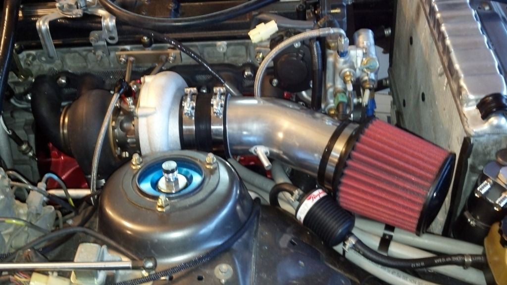

Today, I decided to attempt the final install of my turbo. I say 'attempt' because I'm just hoping I don't have to remove it again, for any final adjustments to anything else on that side of the motor. I'm also waiting for a new mounting plate for my DG500 coils, for the "Morganson cop mod".
I was also going to do the final install of my full exhaust system today, but it just got too damned cold outside, and I gave up. Maybe tomorrow.

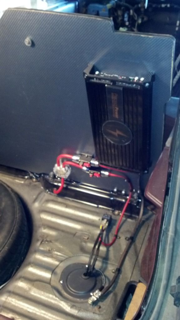

Today, I just played around in the hatch area a bit.
Just started mapping out wiring for the amplifier, as well as the fuel pump. Pretty much squared away, except I have to route the speaker wires, as well as the rca leads.

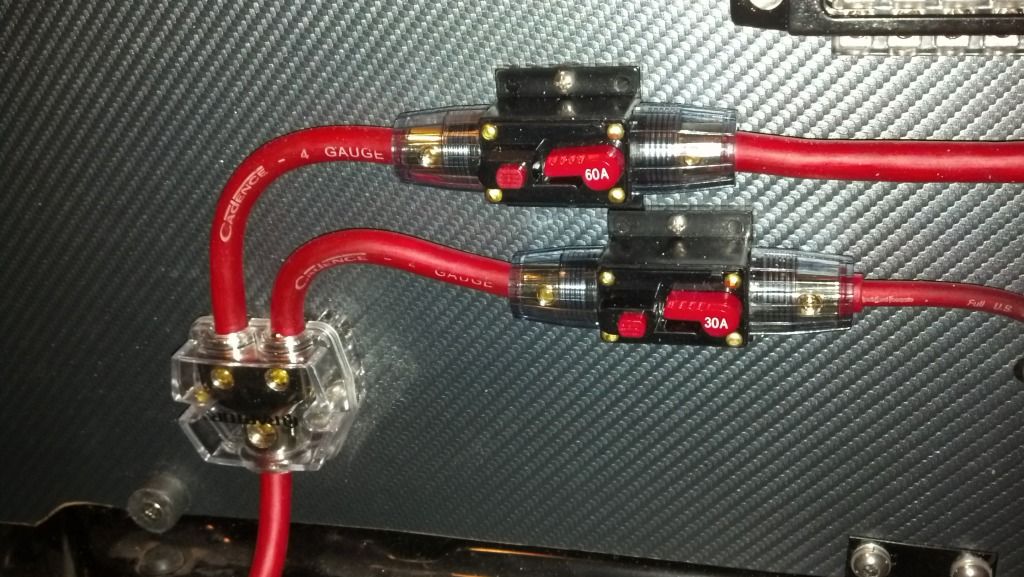

I ended up having to get ground loop isolaters had alternator whine on my speakers sigh, how did you run your power cable and rcas? Btw clean amp install probably gonna clean mine up now that I see yours. Also can't see clearly but did you use circuit breakers instead of a ANL fuse?

I hope I don't have to deal with isolators and filters, but i guess we'll see.
I ran the power line down the driver's side, the rca's down the passenger side tunnel, and I will run the front speaker lines and remote line back up to the front, probably up the driver's side of the tunnel. And yes, I used resettable circuit breakers- 60amp for the amplifier, and 30 amp for the fuel pump. This allows me to disable the fuel pump at the push of a button, without having to run any additional wiring, or install any extra switch.

That's what I ended up doing but I have a dual amp set up and my wiring is a little crazy right now(got impatient lol) maybe after I clean it up I can get rid of the isolators they're ugly, that's badass may steal this lol thanks for the pic!

1/2" plywood(birch, i think) and covered it in carbon fiber-design vinyl.
I had a roll of it just lying around, that I had bought years ago.
