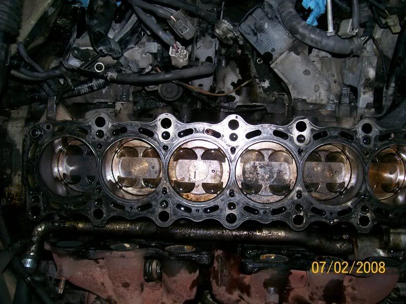

progress...since i cant post in the supra build gallery i guess i'll post here...dun wanna "not follow" the rules...anyways here are pics of the work we did today...started to take the crap off the head.
It was very messy in there, need new valve cover gaskets while im there, bolts were extremely loose. Hopefully we can have the head off sometime tomorrow and then we'll see where we can go from there.

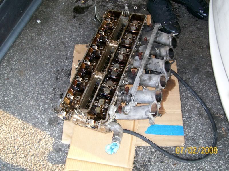

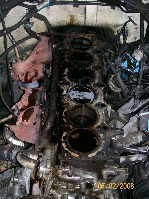

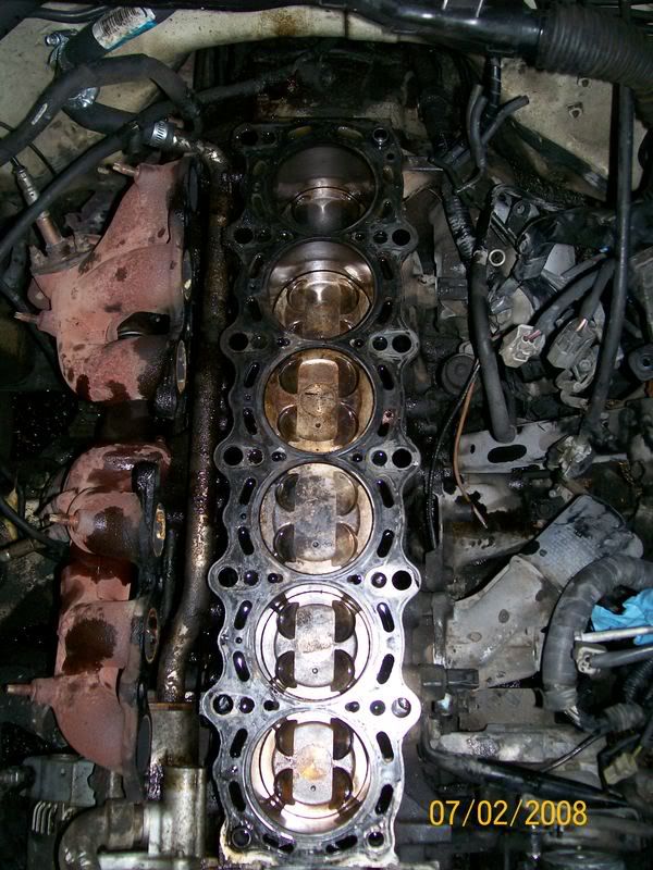

ok took the head off yesterday, and if u think theres a lot of oil in the galley...well check these out.
Very messy...
started cleaning it.

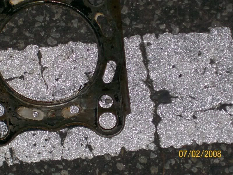

The head bolts on the exhaust side were loose as fuck so that coulda been a cause or caused by the BHG...
