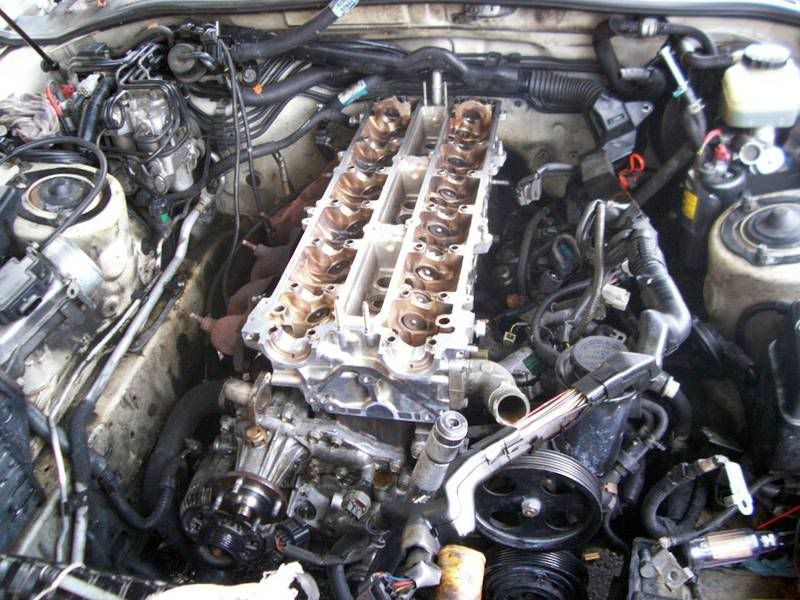

this head is so damn dirty dude LOL....I'm going to take it to my old work and clean it in the tank.....I can't be haveing dirt get on the deck while laping!
I did do a quick test on it and it came out real good! Let's hope the guy didn't take too much off and that its flat....
When I'm done with it I think you will be very pleased.
gaboonviper85
Jan 13, 2008
3,236
Northeast Philly
to got bad news and I got bad news...let's start with the bad news, head is .0045" out...I put it on the granite test table and it rocks like a baby cradle.....and he took more material off the front then the rear by .003" which means the timeing belt will want to walk off the cam gear "in theroy"....if I can figure out if there is still enough to cut again it may be able to be saved but at this point I really doubt it.

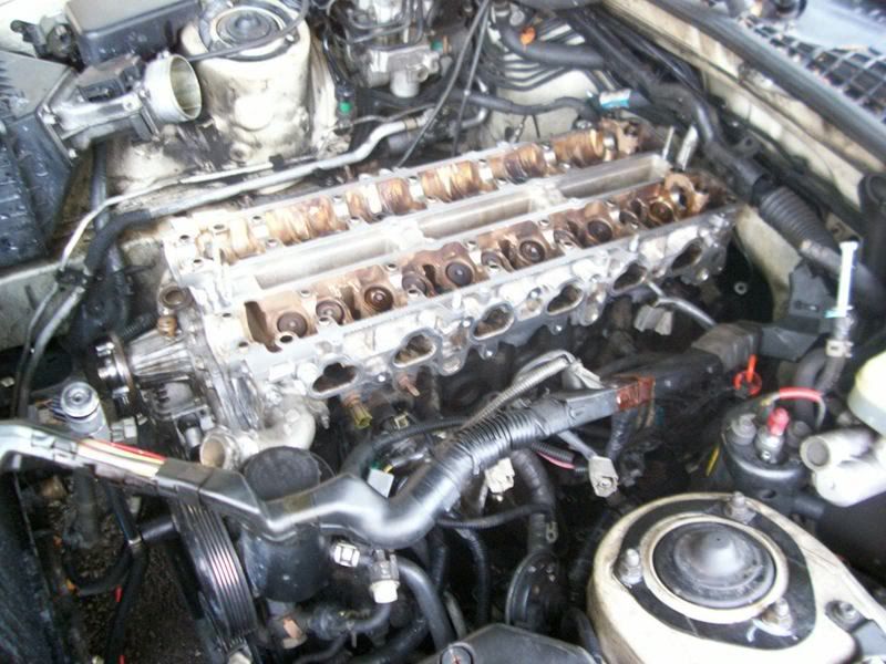

head is back on...
buckets are back in and the head is torqued down...gonna install cams and valve covers tomorrow along with as many things as possible...

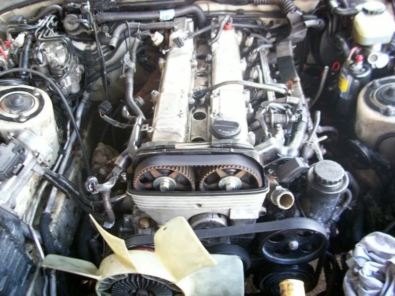

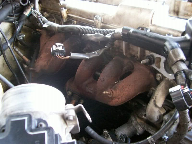

update!!!
Lower Runners and most plugs back into place.
Fan and belts
Exhaust and more plugs back into place
Not oil....atleast not yet :sarcasm:
Almost there guys...almost there...
oh and i gotto tighten down the damn crank pulley, any ideas? considering the fact i dont have the SST and my torque wrench doesnt got pass 200 ft/lbs?
