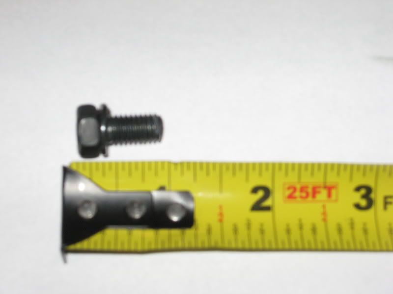

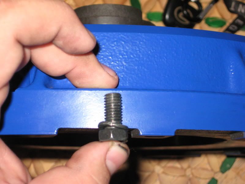

I bought the MK3 bolts and they weren't long enough to go through the Spec pressure plate. I then got MK4 bolts and they "to me" looked identicle in length. I emailed Driftmotion about them and they said they had them for sale on the site but they dont and they havent gotten back to me. Im pretty pissed I wanted to get the tranny attached to the motor during the weekend but no such luck

I show 90119-08302 for the JZA70, while the MA70 is 90119-08322. Not sure why the difference, maybe the JZA70 ones are in fact longer. I would think they'd be the same. Is the SPEC pressure plate really that thick?

Errr... it's a well documented fact that the SPEC pressure plate (at least for stage 1, 2, or 3) *is* a Toyota PP that's been painted blue. Hell, it still says Toyota on the casting!
Is the pressure plate properly aligned and on the dowel pins?

I beleive you I'm sure the 7M's would work fine Its got to be Toyota they wont admit when they are in the wrong and once I take things out of the bag I cant return them.
It wouldnt be the 1st or 10th time this dealership has messed my Sh*t up
It does have toyota in the casting so Im sure its the right one.

those are not the right bolts.
