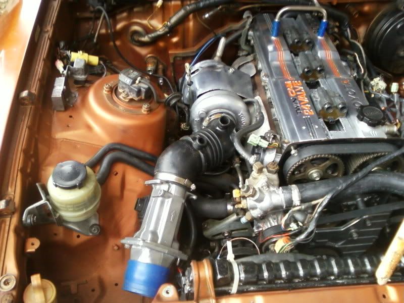

What'd you do Ryan...cut and re-bend the factory brackets?
Are there times when you regret putting it that close to the CPS?

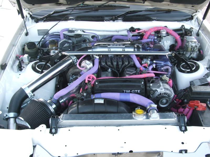

dumbo, please replace that stainless braided line from the FPR to the rail with a non-stainless line (nylon braid or pushlock). Hate to see another car burn from the FPR line wearing through the 12V alternator wire.

That was the first attemp and I never ran it that way and am sure I would have regretted it.
Heres where I ended up moving it too.
Lots of room now
Have no fear I keep an eye on it, and when it's a daily it will be changed/fixed. Thanks for the keen eye though:icon_cool

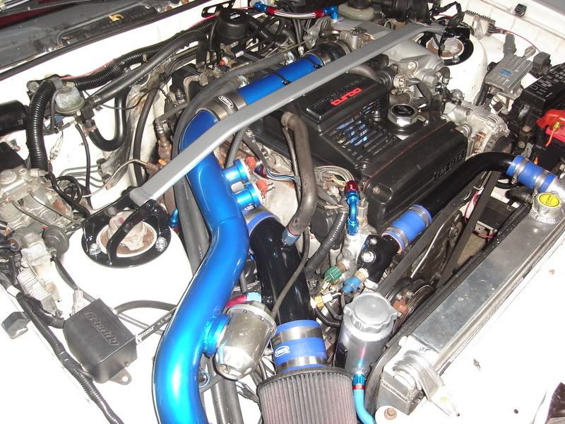

IJ.;1396725 said:
At least mine ran :p
Lol.
i used my 7mgte on my 2jz, and used a camry one on a sc300's 2jzgte.
those afterarket ones, are they custom built by you or buy thm somewhere? w/ a screen?

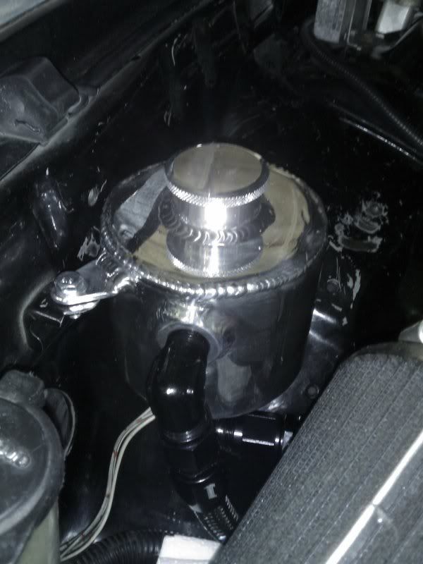

why not get one of the aluminum ones? you can get a pretty decent looking one for $30 or so. the n/a is a cheap solution, just think they are a tad fugly.
