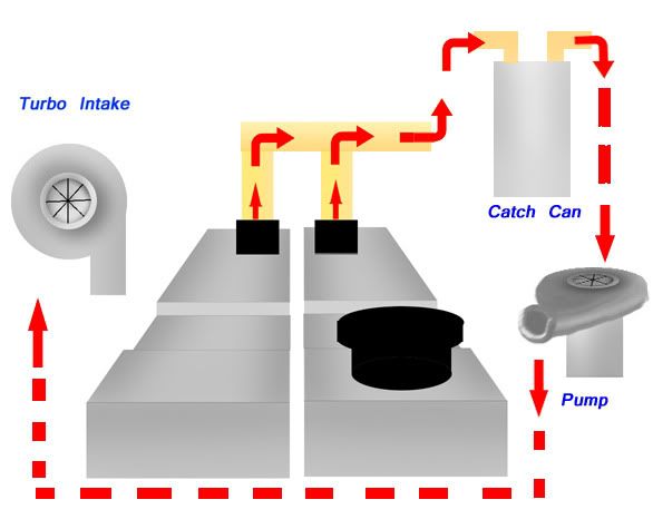

So in this setup...
Is there going to be enough air flowing into valve cover to support the flow taken out by the pump? Wouldn't you need a way to get the air in before you can suck it all back out?

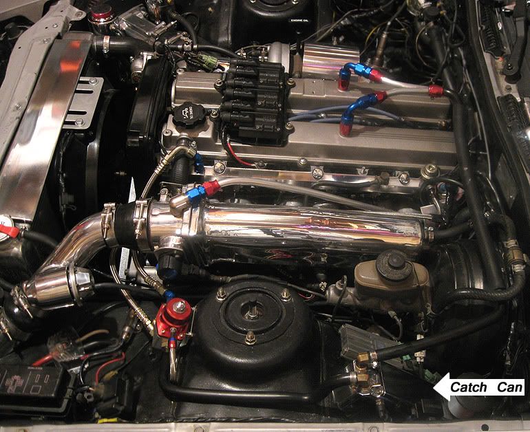

Ok this is my set up right now, basically the only thing that will change is the pump will go inline between the catch can and the turbo inlet pipe.
I'm thinking about putting the pump in the IC area, or under the intake mani. I think in the IC area would be easiest.
