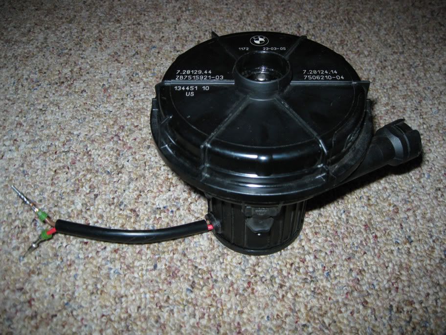

I'm using an electric air pump from BMW, no mods needed, and it pulls huge amounts of air. It is an impeller style fan, similar to a turbo impeller.
So my plan is it plumb, valve cover - catch - air pump - turbo intake.
Here is a pic of my pump. Dimensions are aprox 5.5" round and 6" deep.

i only have 1 question, if the pcv system reverses when under boost with the stock setup, whats to stop it from blowing pressurized air back into this impeller pump? Could this potentially damage the pump?
other than that i like the idea, i've been trying to figure out a way to clean up my PCV hoses and install a CC but was always confused about how they worked in these cars. Thanks!

thanks for clearing that up, so which of those numbers on that beemer pump is the part#? or where can i find one on a bmw and what years? thanks

So the pump is between the valve cover ports and the intake?
That must be the part I'm missing.
How long can the pump handle drawing oil vapor though it?
thats why the pump is after the CC, that'll catch the oil.
