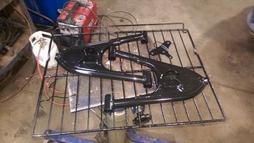

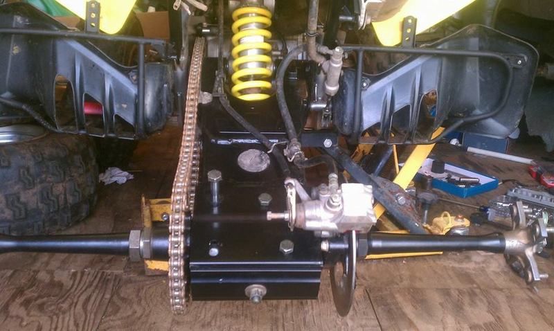

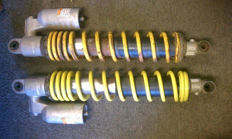

I did my chevelle parts with POR-15 and its held up great for the past 10 years. But I would powdercoat it all. It wouldn't be much at all. maybe 100-150 for the subframe and all the parts. Im gonna have mine done, but I also will do everything that I can fit in my oven.
Heres some quad stuff ive done at home (well technically at my shop but its a home oven)

I plan to powder coat my arms and everything I can as well. I was planning on painting the subframe and the ps rack and knuckles since I can't bake them.
I have used por15 in the past and it did OK but was not the easiest to work with. Seems like opinions are 50/50 online of those that swear by it and those that hate it. I was almost thinking of trying a quart of the rustoleum commercial gloss black and adding some hardener this time.

I just finished one side of my rear knuckles. I will get a pic tomorrow but I dont understand why you said it cant be baked. (will need new bearings tho since you pretty much destroy them getting them out)
