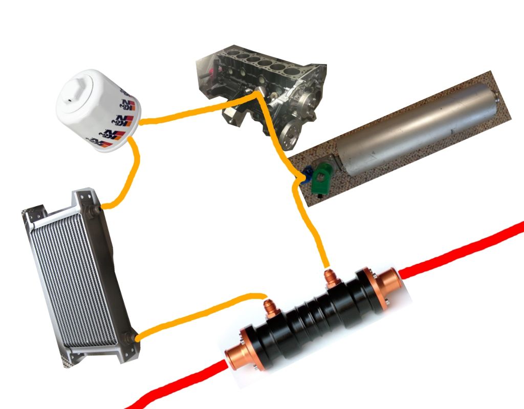

Oh I agree. If anything, this will relieve some of that though. Here, I made a dye-uh-gram:
Oil goes to the filter, then to the air-to-oil cooler. It gets cooled the most by that. In case it gets overcooled, it also goes to the oil-to-water cooler, which will warm it back up to where it needs to be (again, its mostly a thermostat in my system). Then, of course, I have IJ.'s old AccuSump too.
If anything, I imagine that it will be less work for the cooling system. If the 19 row cooler I have cools it down too much, then the coolant will warm it back up a bit..so the heat gets transferred from the coolant to the oil.
jdub
SM Expert
Feb 10, 2006
10,730
Valley of the Sun
Do as you will...personally I don't see any benefit. The KISS principle is alive and well...what I see in that diagram is additional failure points...

It's no different than having an oil thermostat in place, just switched where it would be in the system. Originally, I planned on running a water-cooled turbo, but it's looking like I wont be doing that quite yet, and I thought plumbing might be easier actually if I use it straight from the turbo.
My goal is to get the oil up to temperature as quickly as I can while keeping the temps from climbing too high. I think with the accumulator, it'll take plenty longer to get up to temperature. Since it will be a daily driver, this is especially important to consider. Sounds like you're not too keen on the idea though.
