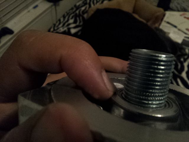

Ok so two quick questions. The Permacool filter adapter didnt signify which Port is which on the block. Now im assuming that the Arrow pointing away the left is the port that im supposed to feed the oil into and the other port next to it is the outlet. Am I correct? Also do i apply teflon to this portion in the second pic.

I'd double check everything yourself even if it did have arrows on it. Stock, the oil flows from the pump through the outer perforations in the filter, and out the threaded center of the filter to the main rail in the block. Visually check your block adapter (or run water through it to be 100% sure) and hook up your feed line to the port which flows to the outer "ring" of the block. Hook up your return line to the port which connects to the center opening in the block.
Do the same thing with your remote filter head. You will need to plug both ports on one side of the filter head, and connect your lines to the other two. Do the same check to determine which is in/out (or just follow the arrows). Just double check your work, if plumbed backwards the anti drainback valve will severely limit your flow.
Oh, and I'm assuming those are NPT ports. If so, you should use a little teflon tape to seal.
