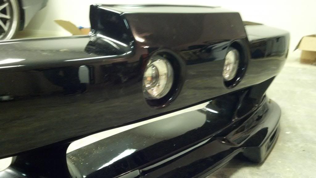

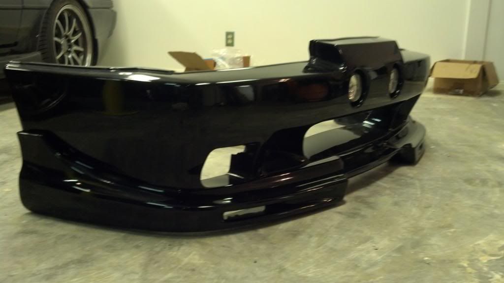

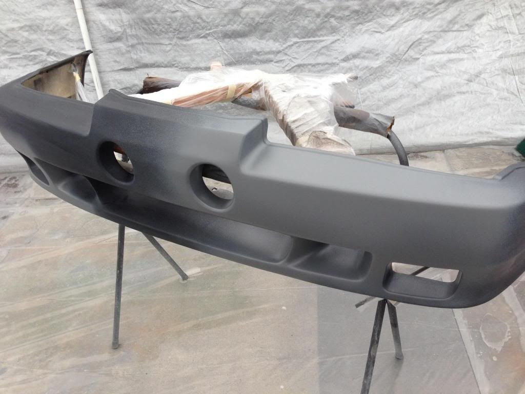

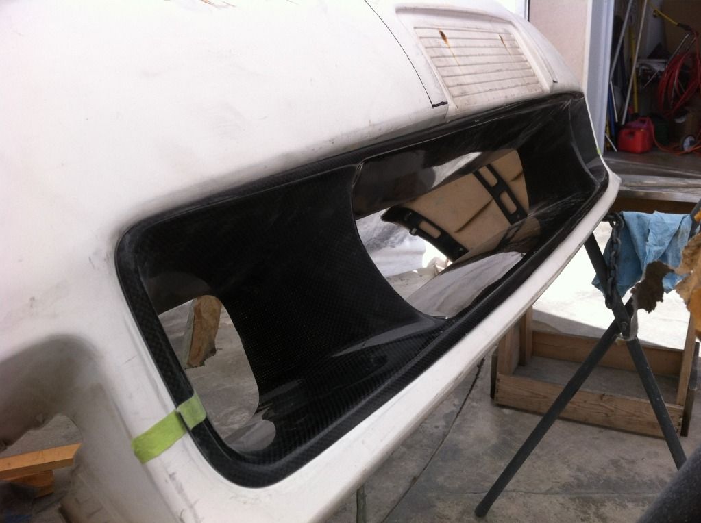

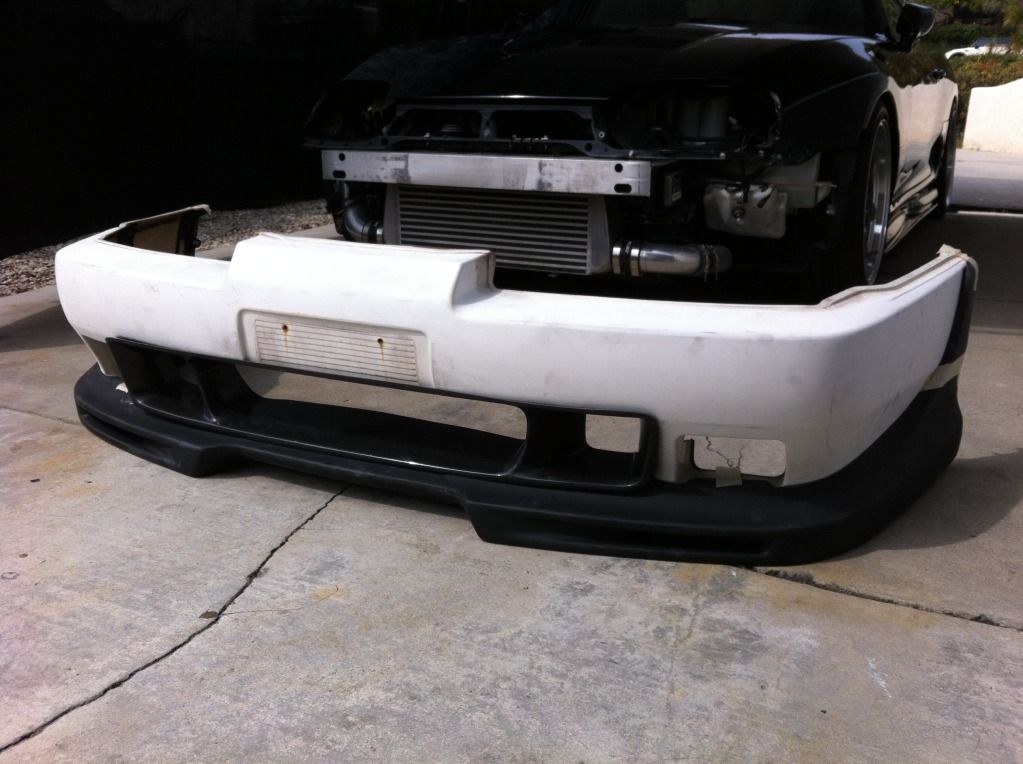

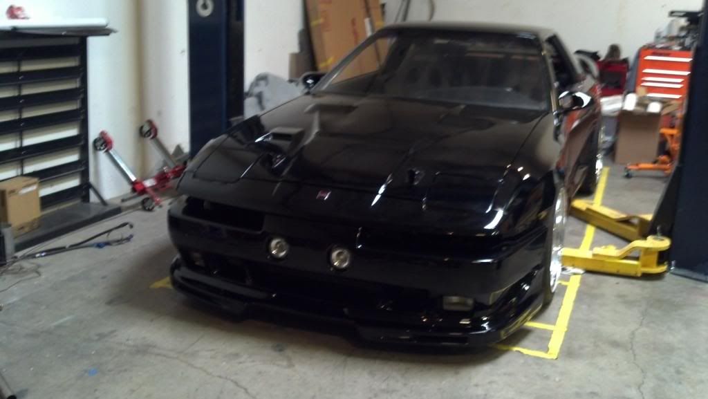

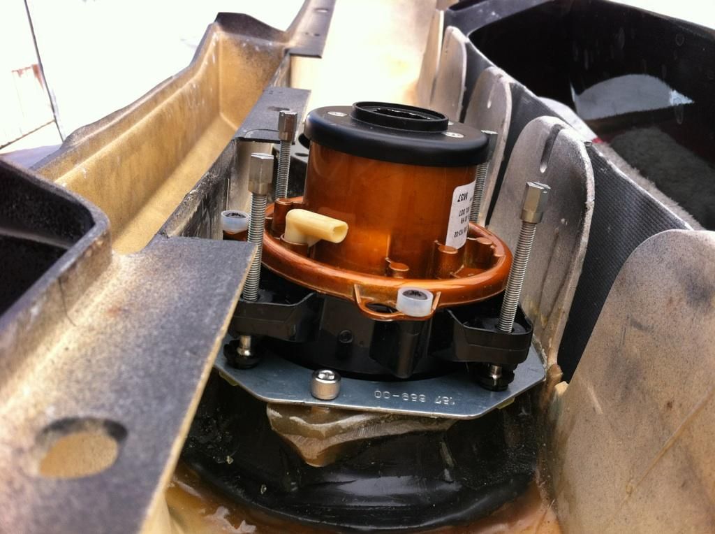

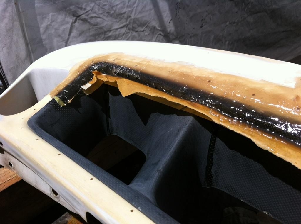

I'm sure this new bumper styling will get mixed feedback.
Old and busted OEM bumper with grill that has been cut out + Abflug Lip
S2 airguide
The airguide was massaged/trimmed so that it fits perfectly.
Molding in S2 airguide

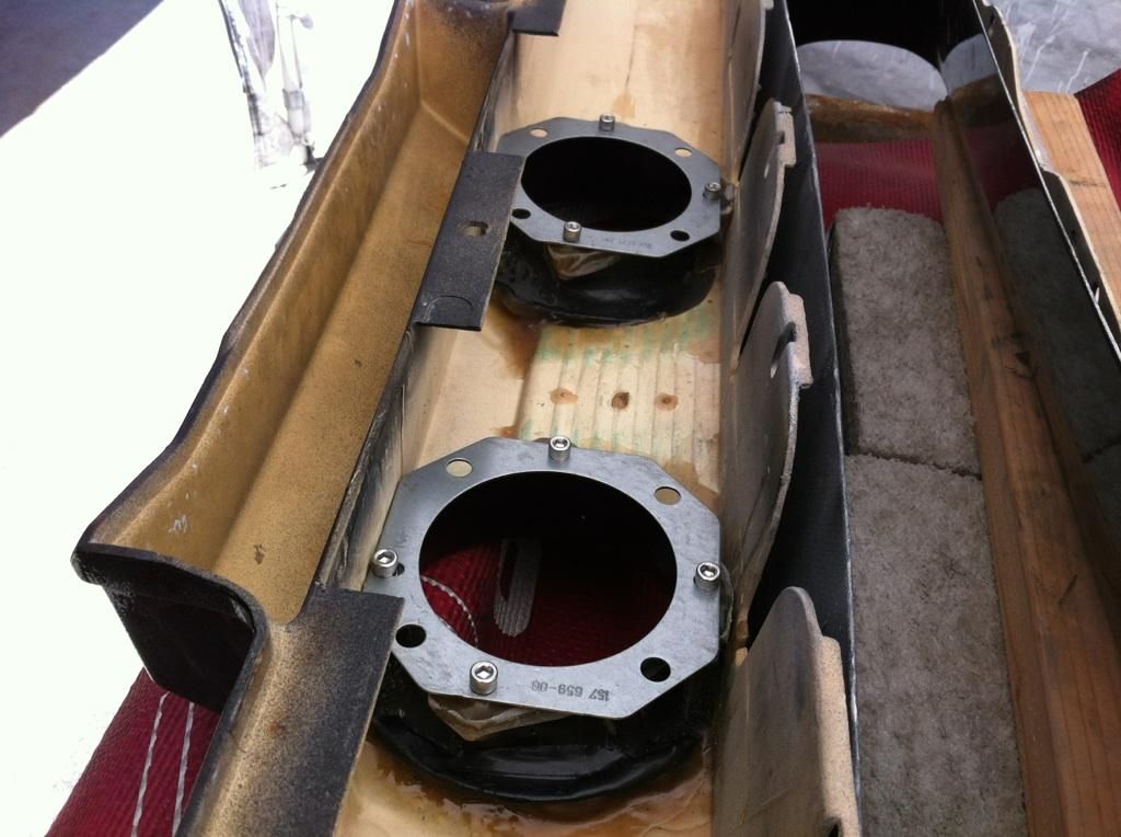

Modified the Abflug lip to S2 style by chopping the side burns. Also, the parts that overlap the bumper were chopped off for a cleaner look.
[/IMG]

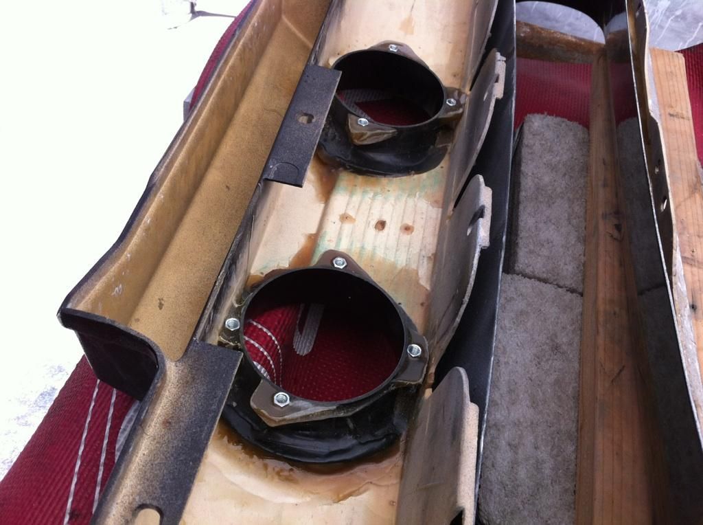

The round tunnels for projector lights.
Primed.
The backside
End result
Pardon the picture quality for now.

Very different! I like the combo of S2 airguide and abflug lip, interested to see more pics of the whole car in balance when its rolling again.
What's the plan with the projector beams? Will they be on a separate switch, or wired in with the headlights?

AbsoluteSpeed;1947342 said:
Beautifully done. The projectors aren't my thing but the way they are moulded looks phenomenal. You would never know it wasn't original.
Thank you. We each have our tastes, which is a good thing.
The Greddy bumper and oem bumper/airguide front ends have become very popular, so I wanted to have something unique. The center lights will be wired up independently of the headlights and foglights.
I will have more pics taken at different angles shortly.

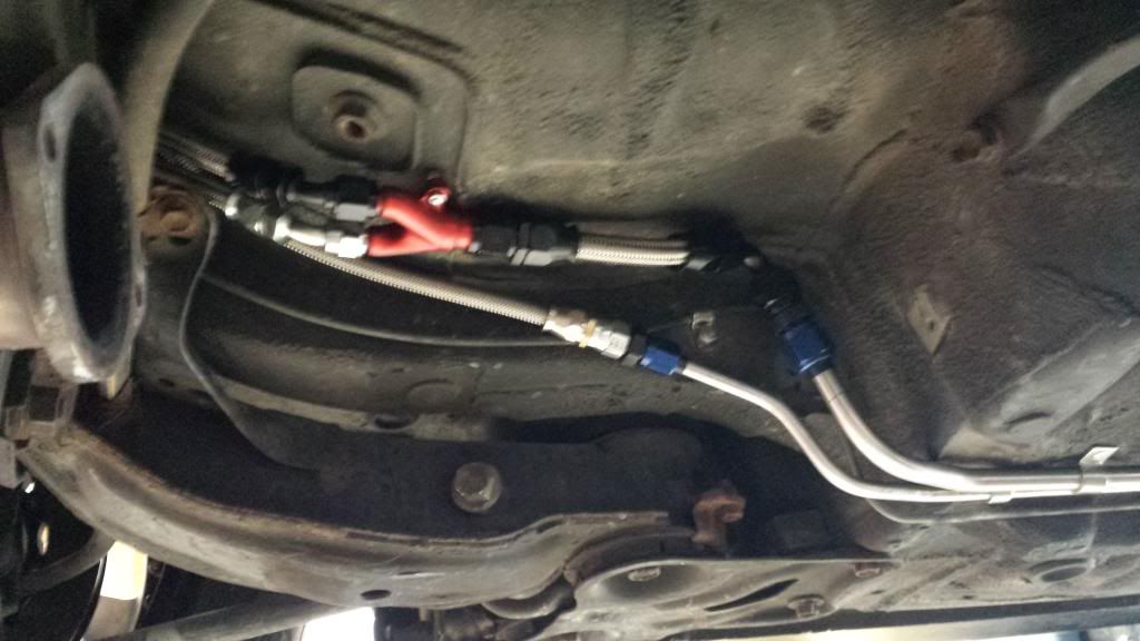

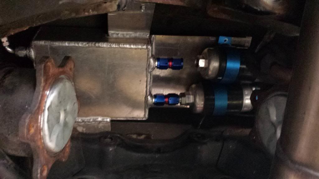

Fuel system work in progress. Surge tank and external fuel pumps located above the diff.
Fuel lines

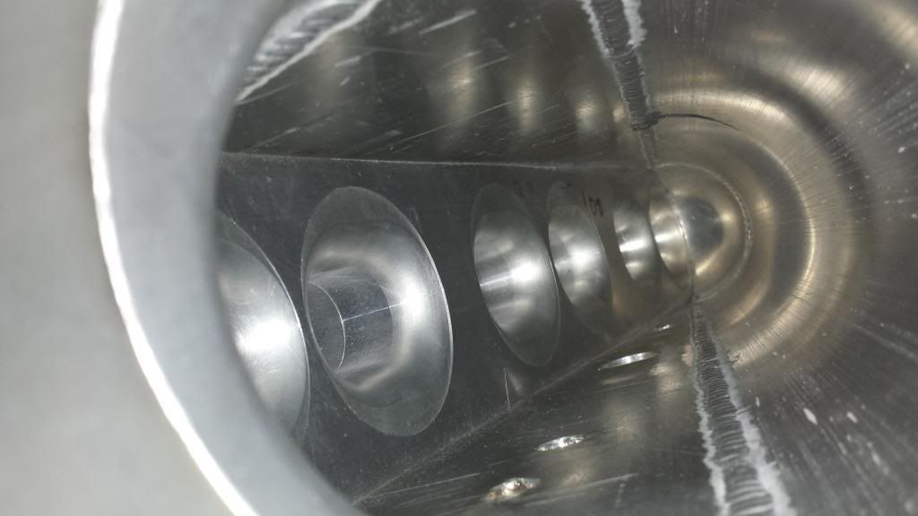

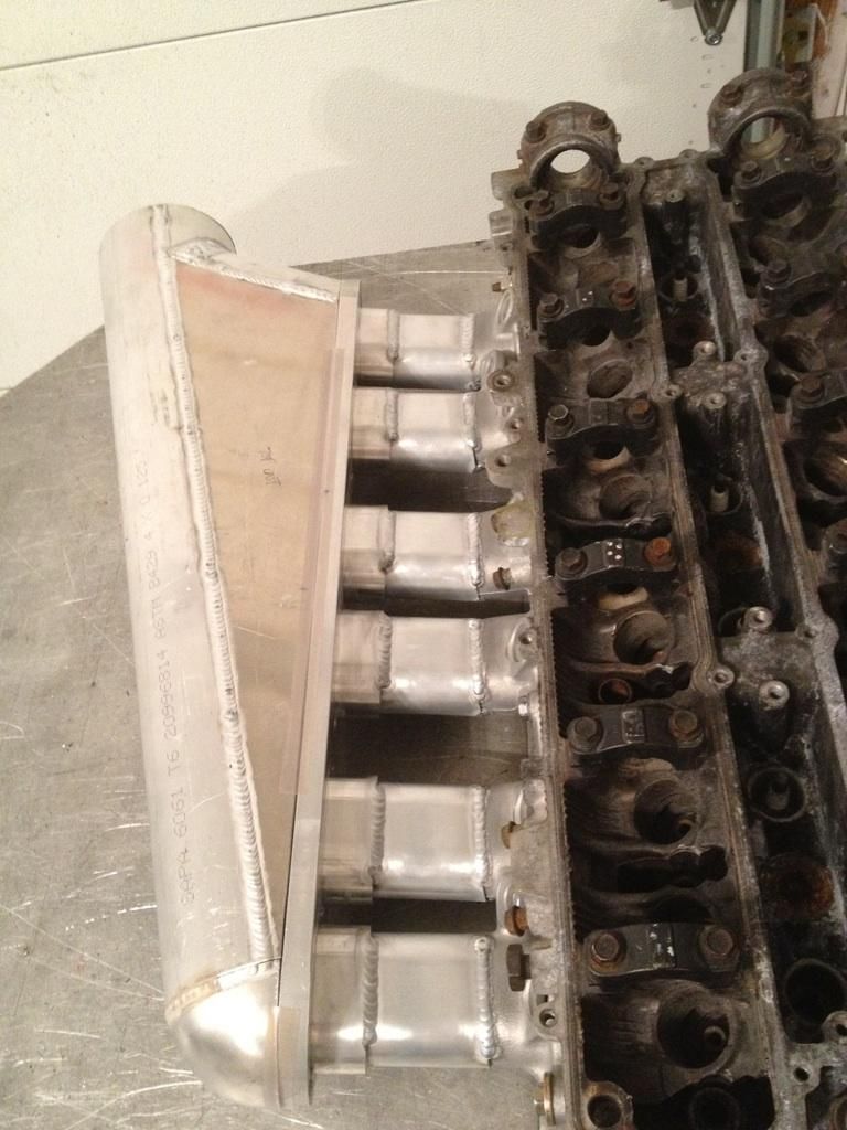

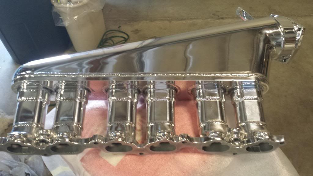

Ron R. Intake Manifold
Before:
After picking up from the polisher today.
Inside the manifold.

Thanks for posting the pics of the fuel lines as I am going to be starting mine soon
Are the ends of the hardlines flared or do you use the screw on compression fittings with the olives?
Everything is looking great, keep up the good work its giving me some inspiration!
The ends are flared.
