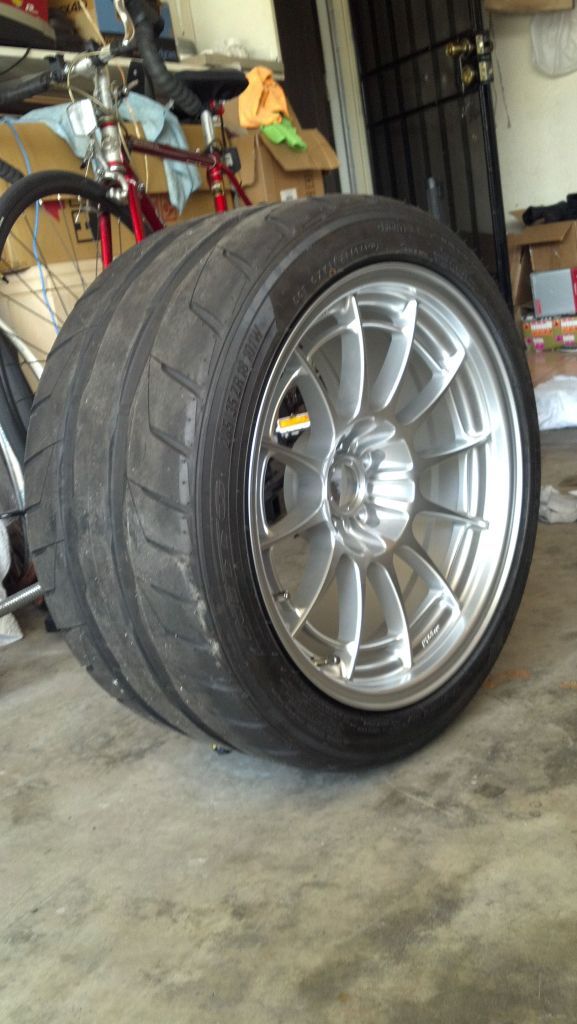

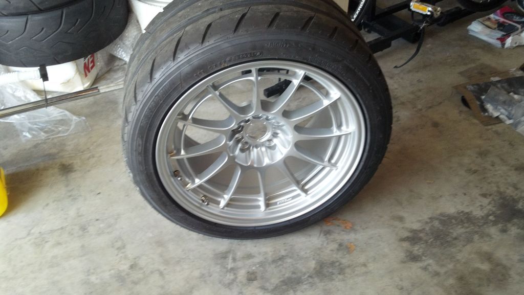

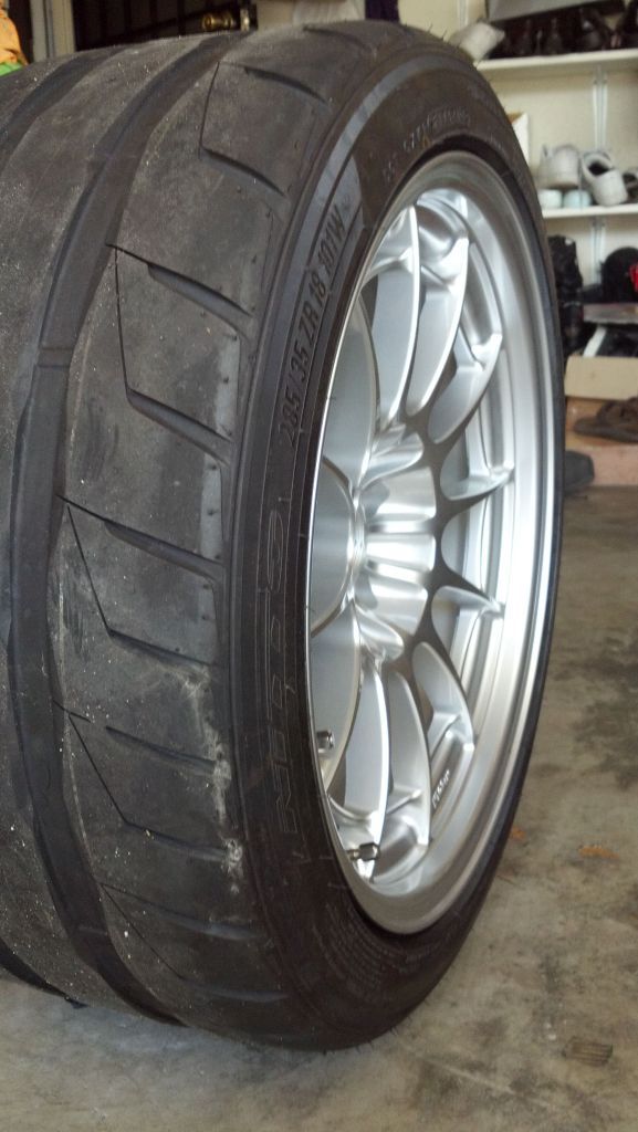

With the additional power that the car will make, I needed wheels and tires that will plant the car to the ground. I picked up Enkei NT03+M wheels in 18x10.5 +30. 285 35 will be at the rear. 255 35 will be up front.
I really like these wheels because they are light weight and have a lot of details like the dual valve stems, "perimeter brace ring" and a little bit of concavity on the spokes.
(I read that dual valve stems help in exchanging regular air for nitrogen. One stem is used to let out the regular air while nitrogen is put in the other stem. Not sure if I would actually every do this. The dual valve stems are a cool conversation piece though. LOL.)
For the interim, I will roll silver, but I will have them powder coated blue.

K_SHAN;1826543 said:
10.5 +30. I'd like to see that fitment. I really want to put a 18x10.5 or 11 with 315s on the rear of mine.
295 is the "ideal" tire width for 10.5 and 305 for 11. 315 would work on the 11 and still look somewhat square, but will bulge on a 10.5. If you want to run 11" with 315, your fender will have to be pulled aggressively or your wheel will need a very high offset.

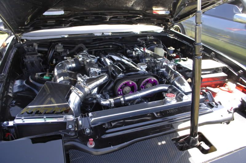

ryansmith;1837229 said:

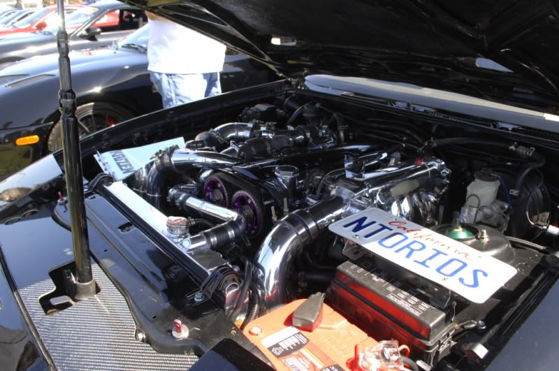

noob question, what is the name of the carbon fibre panel at the front end of your engine bay? and where can I buy one?
Really makes the engine bay look a lot tidier
Intercooler block-off plate by Carbon Fibre FX. The company doesn't exist anymore. You could buy a LIPP brand.

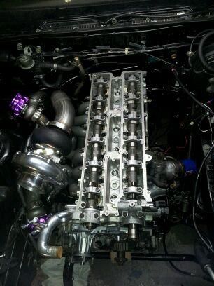

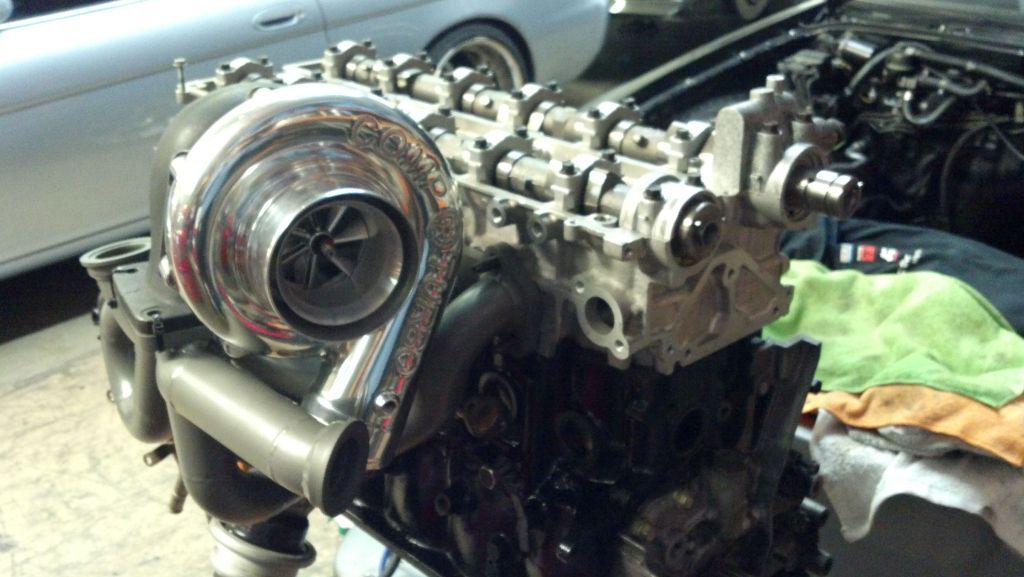

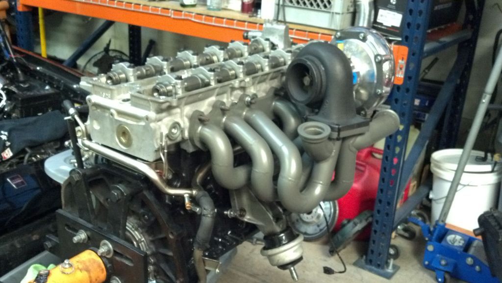

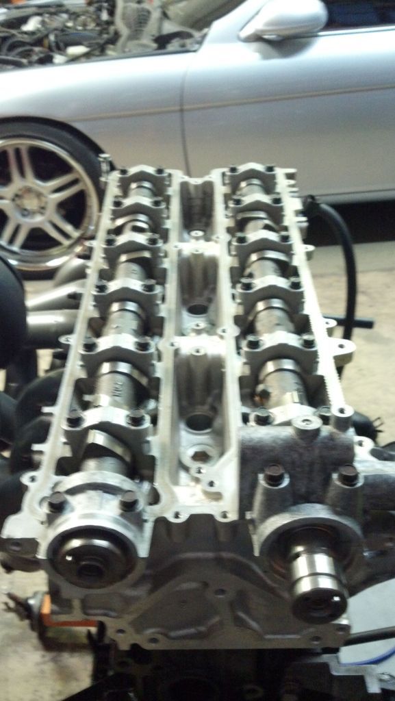

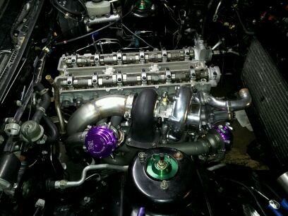

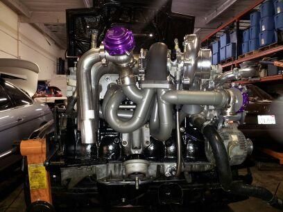

Progressive pics of the motor:
The fresh head:
Turbo mocked on

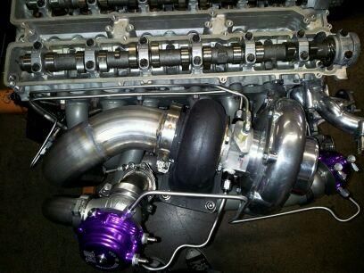

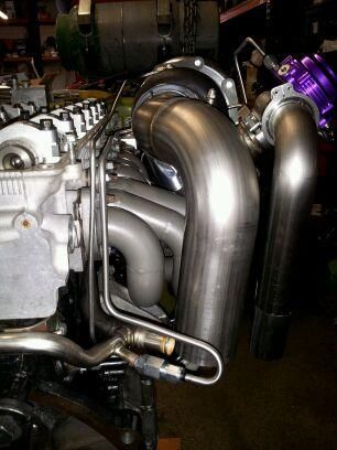

Motor test fitted into the bay so that the down pipe and waste gates dump tube fabrication could be initiated.
Motor back out
Oil and water lines created
