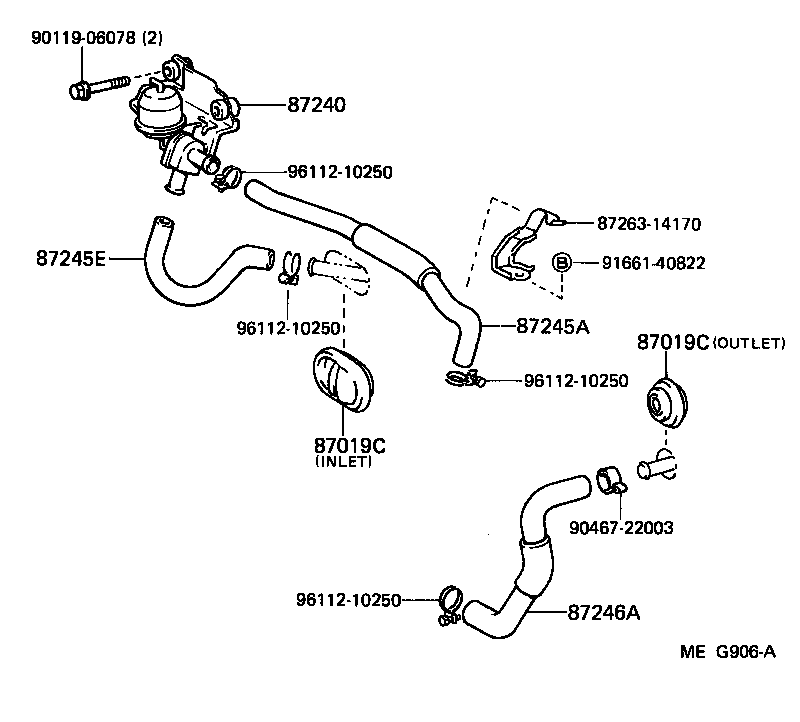

check your heater valve. probably the most common problem is that it gets stuck closed because of a bad vacuum source, no vacuum, or the diaphragm is ripped. it's located on the passenger's side of the firewall. here's a pic:
and at the end of this arrow is the plunger for it. pull it up and secure it in that position. if you get consistent heat, that was the problem. ;)

i checked that heater valve, it seemed to work okay, lots of vacuum. when i pulled the hose off, it would close, and open again when i put the hose back on. i just put in a new 192 degree thermostat and now there is pressure in the upper rad hose.
