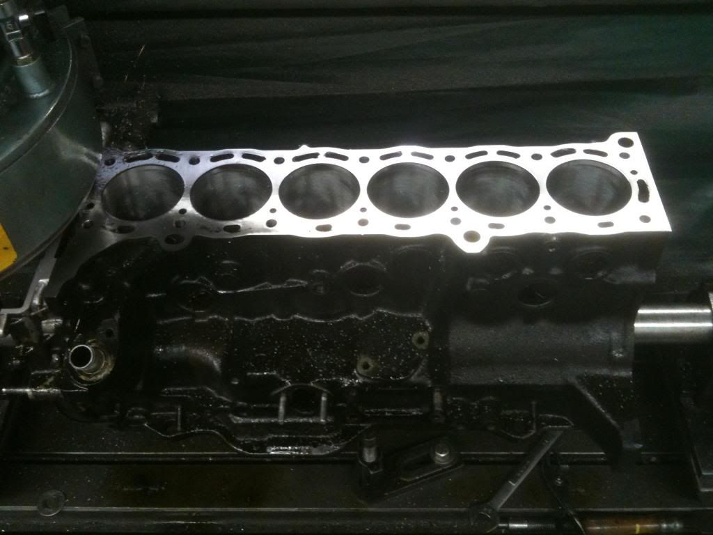

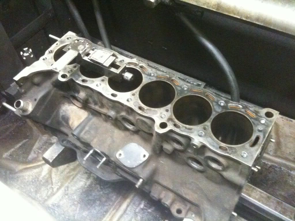

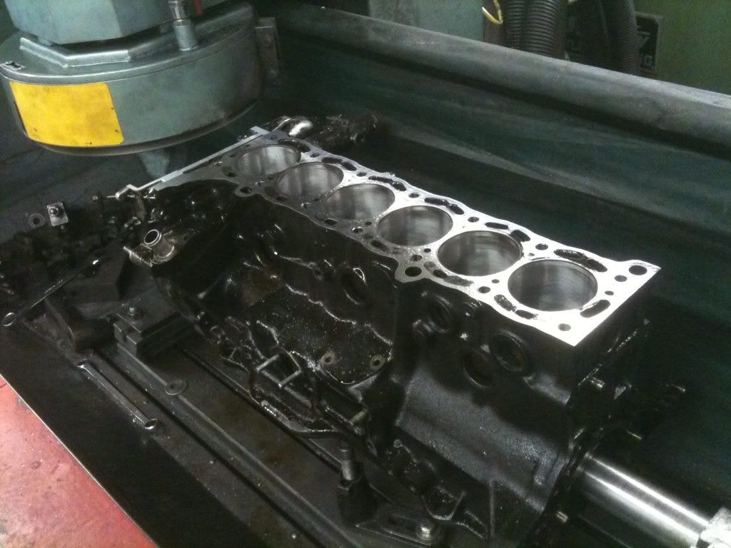

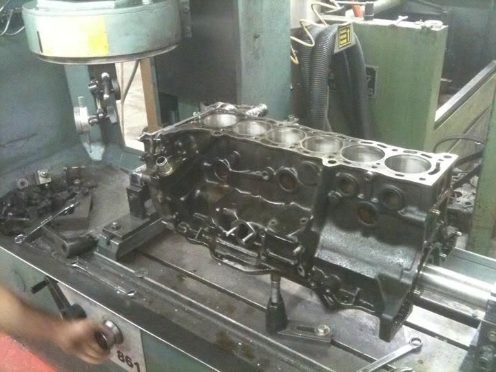

Well guys im waiting on main bearings because drift motion sent me .25 undersize by mistake. Sadly its the first thing that goes in other than the freeze plugs, so I haven't even started building the motor yet.
Here are some pics during the machining processes.
Mounted to be honed
Hone done setting up to deck the block
Ended up taking .012 off and there was still a little bit of pitting around the coolant jacket on no 1 cylinder. But its inside the sealing portion on the MHG so left it.
On the last cut.
Got to do the head on monday and then will start putting everything back together!
