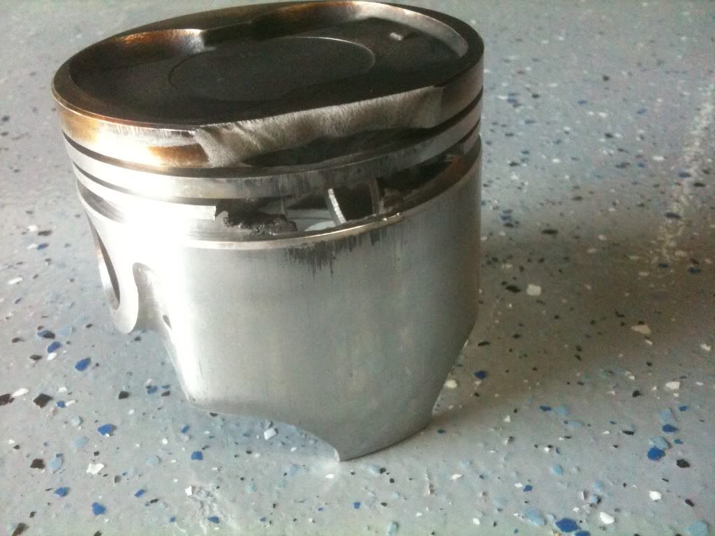

Well I got it all back together and running, ran great and made good power! I fucked up hard core because I was rushing and forgot to tighten the CPS bolt after I set the timing. Ended up running for 3 days, CPS advanced it self as much as it could go and melted the no 2 piston. Everything is out and pulled down to a bare block again so I can hone the cyl and throw new pistons in. One small mistake cost me shit loads of labor. Oh well what is done is done.

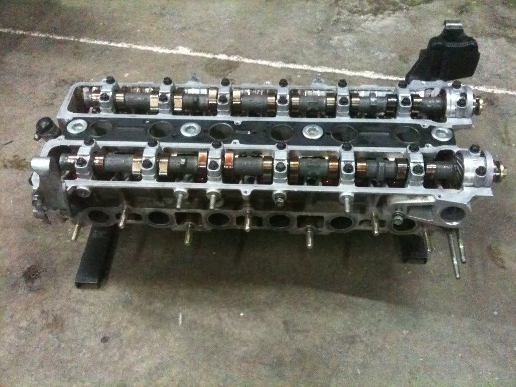

Well got the head machined today and all put together tonight. Had to take .008 thou off the head to get the grooving out of it, then another .002 to get a corroded spot off in the back where the coolant jacket is. Took a total of .010 thou off. Lapped all the valves, checked guides, installed cams, checked valve lash. Intake set to .006, exhaust set to .008. Filled each port up with alcohol and made sure all valves were sealed against the seat.
Everything checked out good, should be throwing the bottom end and everything thing else on tomorrow night. Then dropping it in wednesday!
