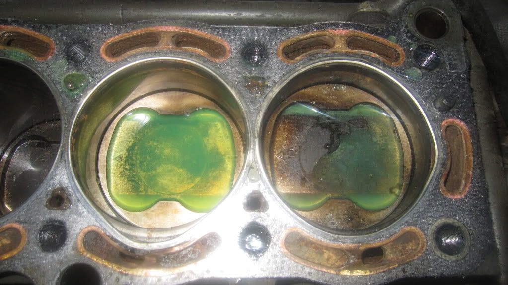

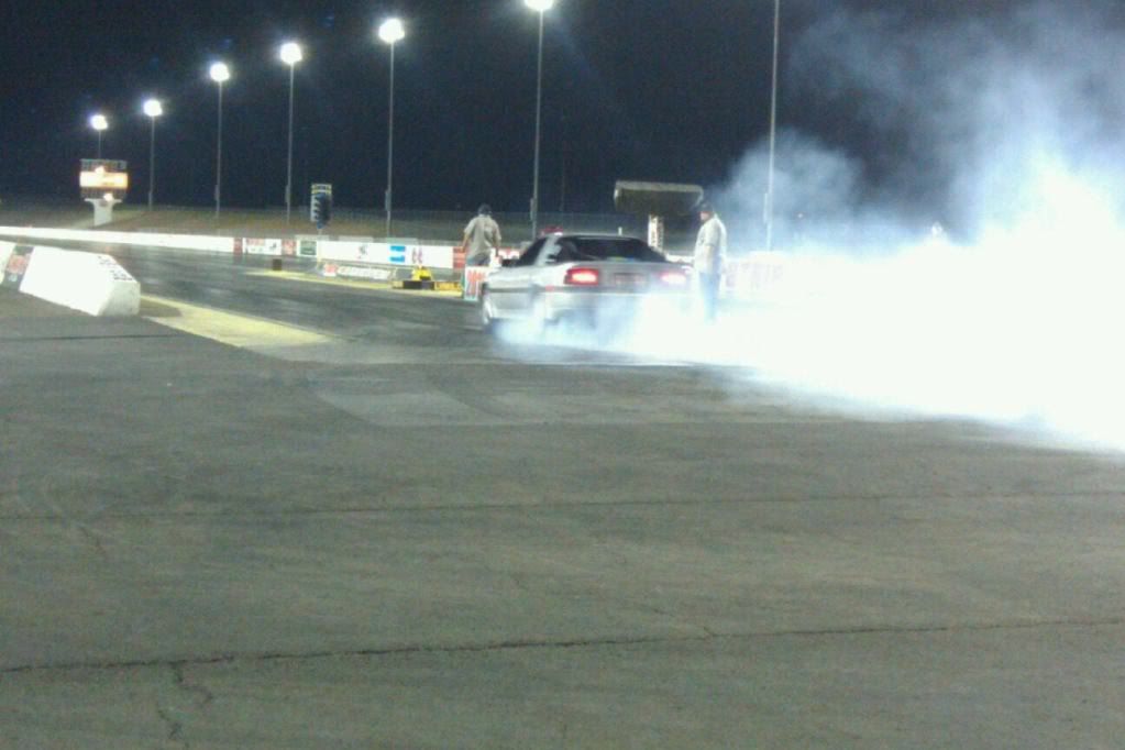

We'll yesterday was eventful. Kept having traction problems even with the slicks, I was leaving the line with 14-16lbs but track prep sucked. Got 18 runs in yesterday. Even with all the traction problems I think I can still say I now hold the official CT26 powered mark 3 supra record on boost only with a shitty time of 11.8 @ 117 with a 1.848 60ft I actually made that run the first run of the night and continued being consistent 11.8's and 11.9's
However on my last run I lifted the head and blew 4 cylinders of the head gasket out. :p Got the car towed to the shop and going to start ripping it apart for a MHG and new ARP studs.
I think I was pushing my luck with 540HP @ the crank on a autozone felpro with 6 year old ARP bolts re used 5 times. Either way car ran strong yesterday and I beat the living hell out of it!

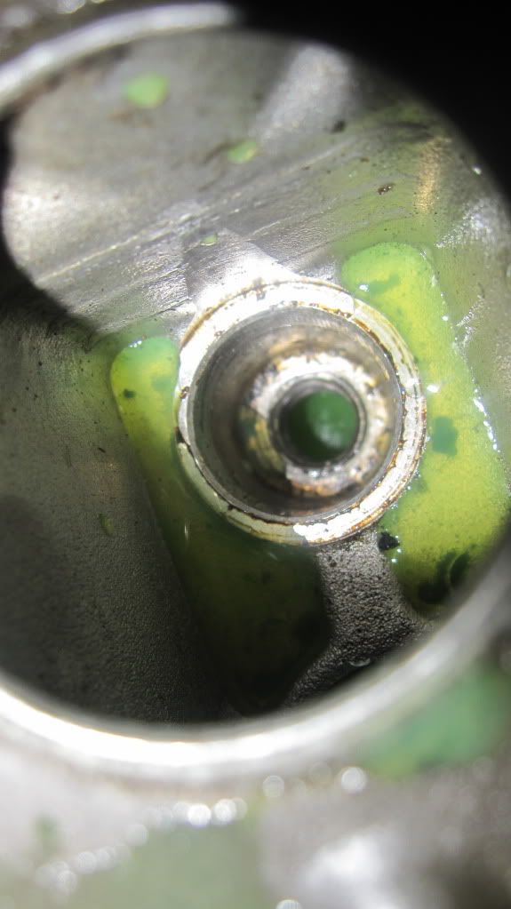

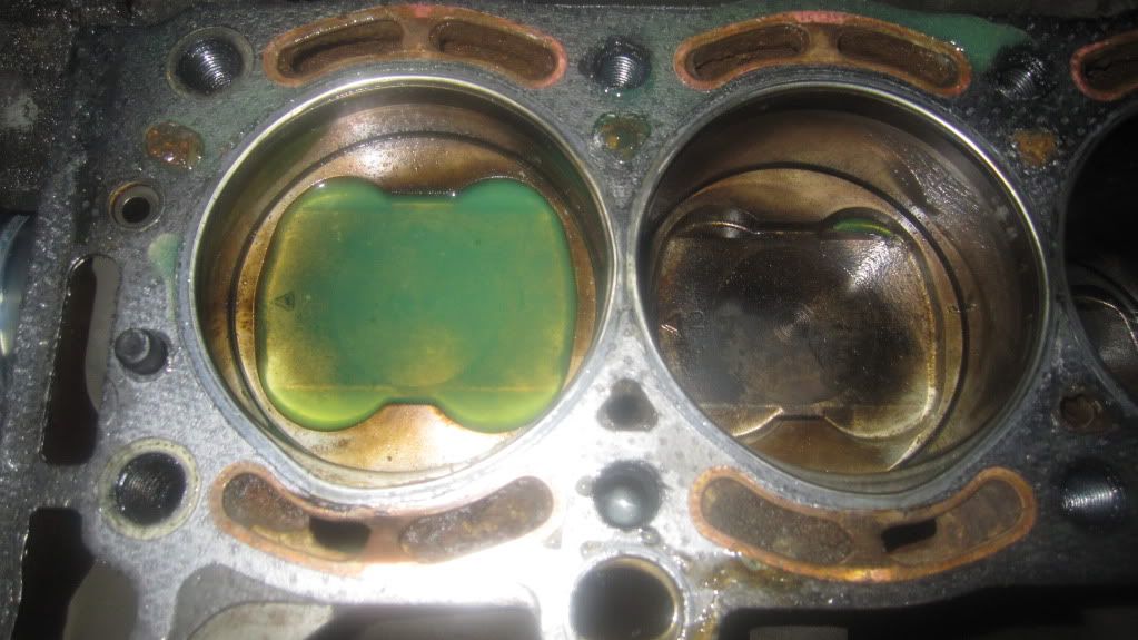

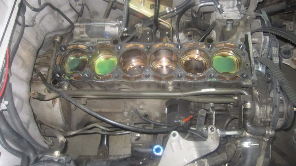

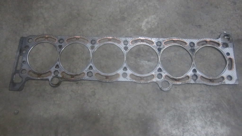

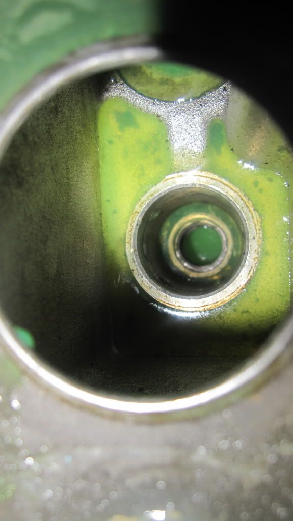

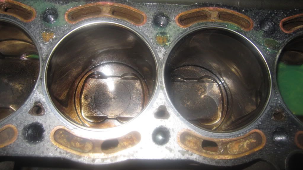

Well New ARP head studs and HKS metal head gasket is on the way! Got the head off. I did a number on the HG
540 crank HP + Felpro= egg shaped lol
Pulled all the plugs out, started to rotate the motor by hand. Cyl 5 and 6
Cyl 1-2
Cyl 3-4
Cyl 5-6
Sad that I got the head off in an hour.... lol
Got all 6 cylinders lol

I heard it start missing on 1 cyl and shut it off immediately. Coasted back to the pits and checked it out. Stopped there and had it towed to the shop!

Now I know my limit for my Felpro HG .... LOL.
