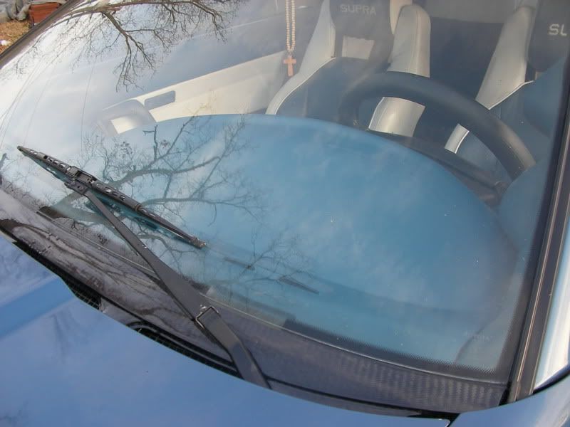

I got the dash installed and here are a couple pictures. I used the same paint, but somehow it ended up darker. I'm tired of messing with it and I didn't even notice it being darker until I took the pictures. I guess the flash has something to do with it. It's staying like this though.
55
