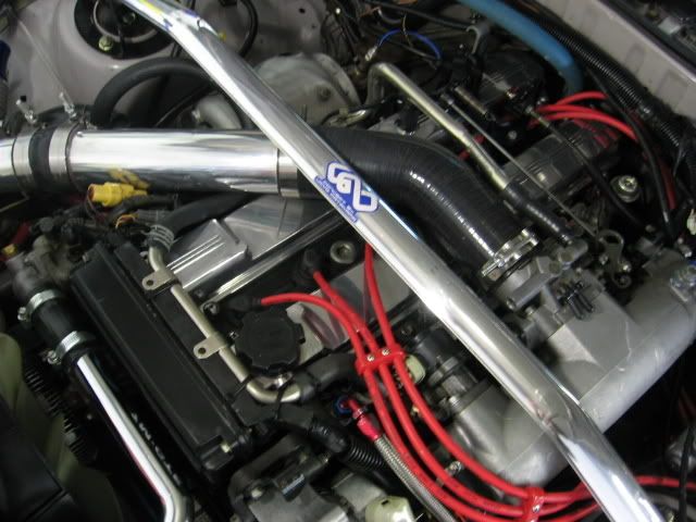

Okay, I'll give a brief rundown for now and go in more depth if anyone wants it.
I got rid of the factory coil pack mounting plate, and made a bracket to bolt to the lip at the back of the firewall. The way they sit , you can just reverse the stock plug wires. Still keep 1-6-3-4-2-5, but the wires you use will be opposite.
The PCV system will have to be modified, but I think most people do that anyway. Mine routes 2 into 1, then to a catch tank under the headlight, then back to the accordian pipe. As mentioned, the new pcv location holds the coil plugs in good.
The harness for the igniter needs to be extended about a foot, no big deal. The only other tricky thing is the throttle cable. I reused the stock bracket and linkage, just modified them to work. I moved the bracket to right before the throttle body, and mounted it on the head and intake manifold with brackets. I shorted the arm on the linkage to like 2". It still maintains the factory throw, and I haven't had any problems yet.
