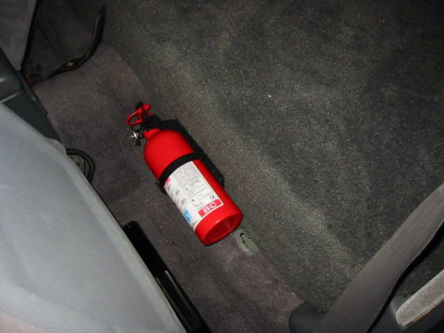

Mine is BC rated. I just mounted it behind the drivers seat, you cant even see it unless the seat if moved forward.

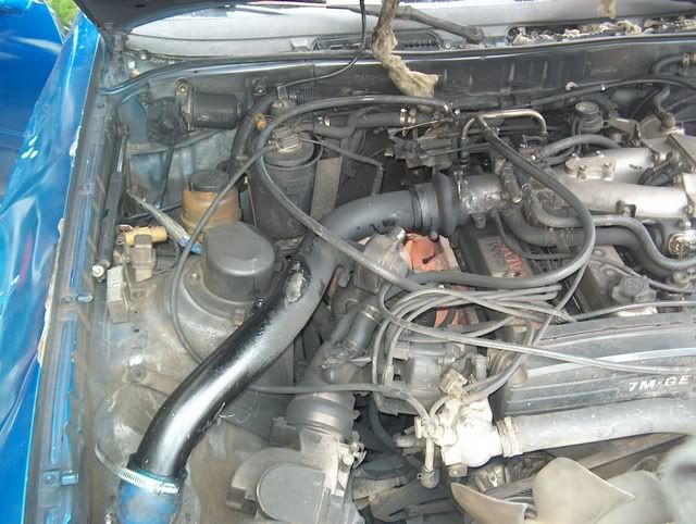

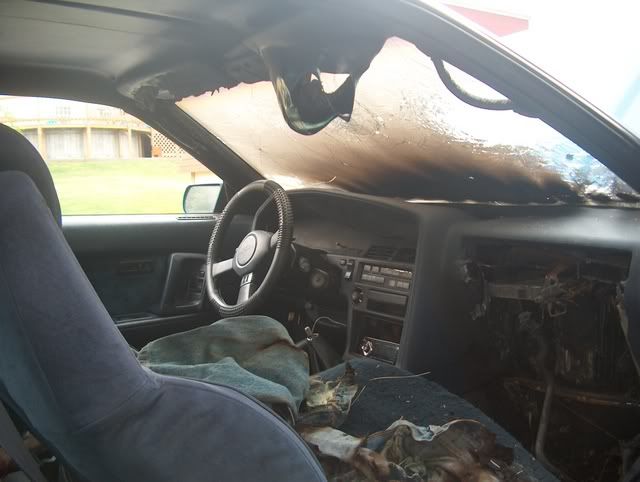

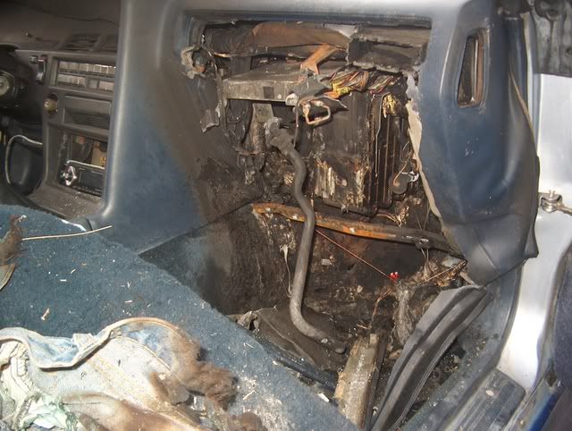

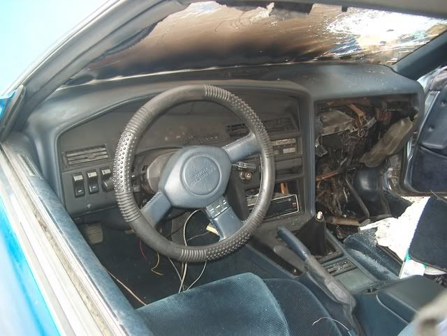

Well i am uploading pics now and will post them soon. I got the motor and tranny about ready to come out. The fire was small and mainly affected the dash on the passengers side. Looks like the downpipe connection to the elbow had came lose and separated about a 1/2 inch and the heat caused the fire.

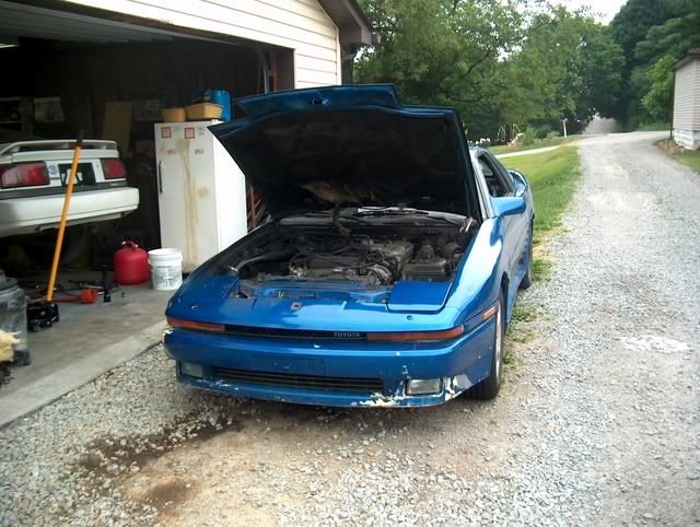

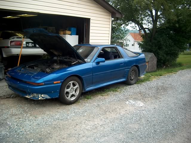

Ok here are the pics i promised

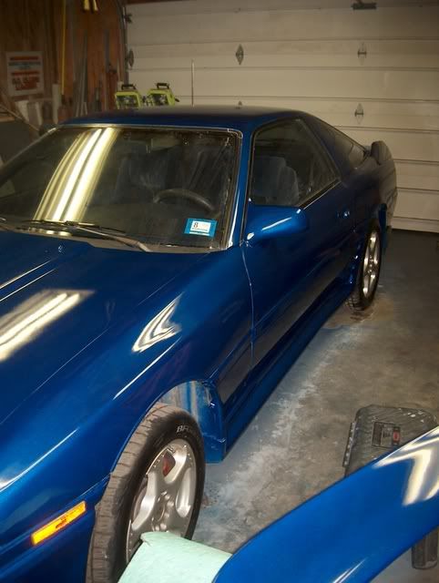

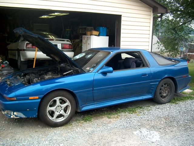

This is what it use to look like.

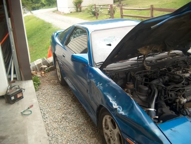

This car is a na -t that was later change to a 7mgte that ran good on na harness, y pipe, na electroncs, hard pipe intake, Reason for fire is the downpipe started to came lose from the elbow and was a 1/2 gap between the two that created to much heat at the firewall and caught the speedo cable first then went from there.

Get another dash, replace carpet and replace the damaged wires and you will be set. I have a NA wire harness and ECU that I will let go for cheap.

Fire extinguishers are an almost mandatory peice on most modded vehicles. The B C rated extinguishers will do a nice job but will leave a white residue that is hell to try and clean up. A halon extinguisher will cost more but will handle more amount of fire puond per pound compared to a B C and not leave the same residue.
