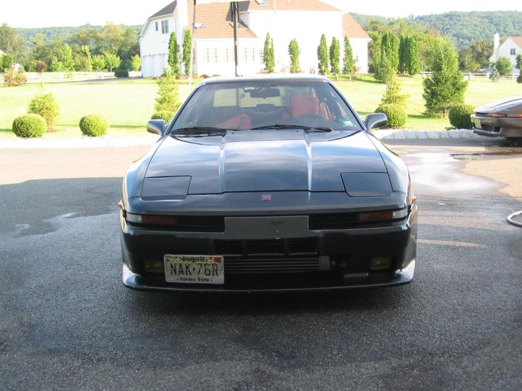

[thumb]http://i610.photobucket.com/albums/tt188/iceberg385/build%20pics/pic041.jpg[/thumb]
[thumb]http://i610.photobucket.com/albums/tt188/iceberg385/build%20pics/pic042.jpg[/thumb]
[thumb]http://i610.photobucket.com/albums/tt188/iceberg385/build%20pics/pic048.jpg[/thumb]

black car specs (off the top of my head):
7M-GE
masterpower 61mm t4 .68 a/r
tubular manifold
tial 44mm wastegate
funkymonkey intake manifold
q45 tb
w58, act clutch, fidanza flywheel
ksport version RR coilovers
wilwood 6 piston bbk
energy suspension bushings all around
hks vpc, gcc, fcon, evc ez 2
denso 550cc injectors, walbro
b&m oil cooler
mocal oil thermostat
socketless oil lines
