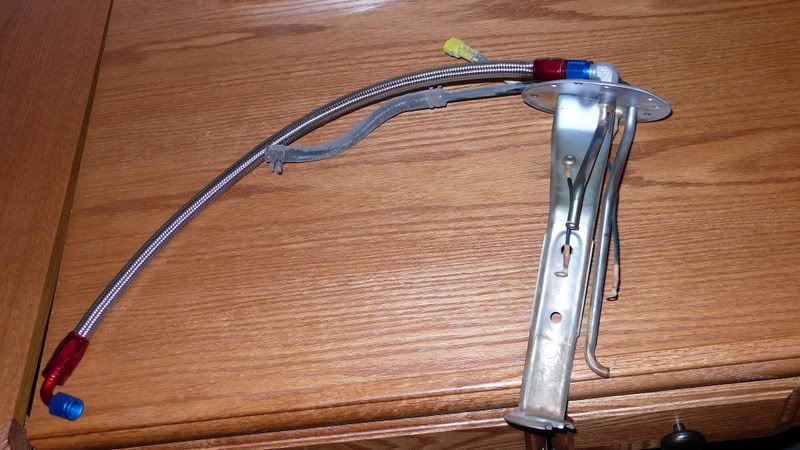

a few freshly manufactured parts:

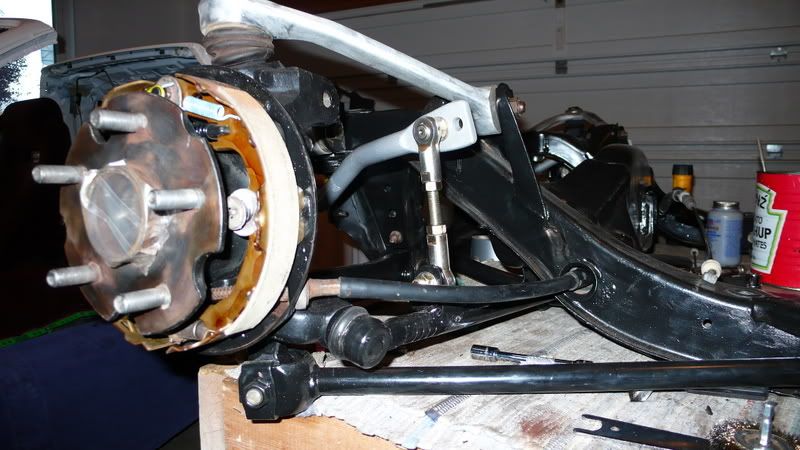

Fuel pump hanger w/ 1/4NPT to -6 fitting brazed to the hardline
Rear suspension endlinks (standard threads FTL)

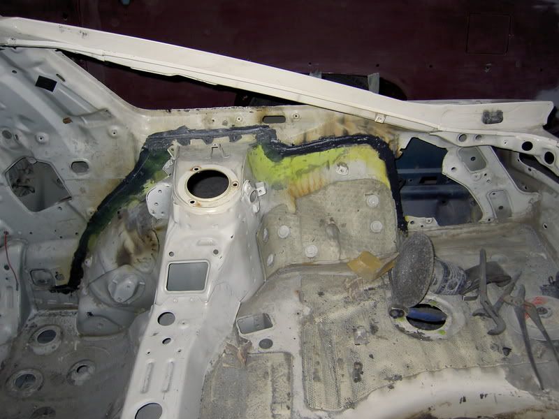

additional sheet metal, welds, and body filler (the outer fender well was brand new, so it provided a good surface to weld to.)

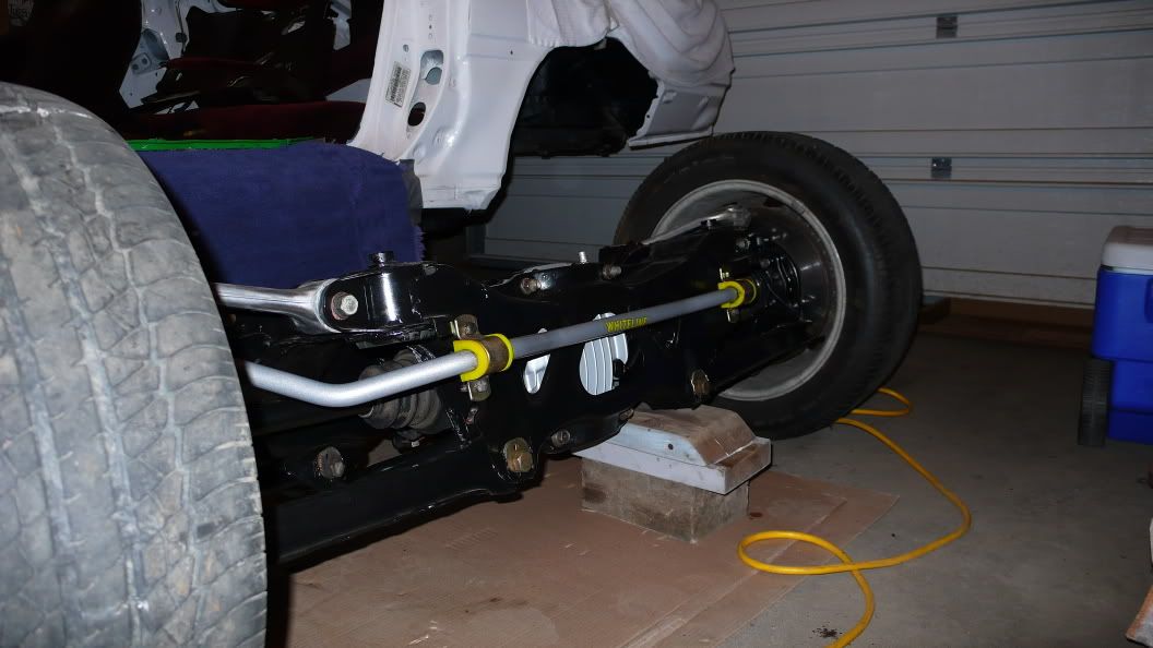

that is one sweeet rear end....
all ready to bolt on to the car - I just have to finish a bit of undercoating and on she goes.
