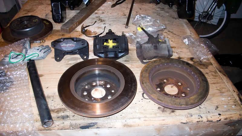

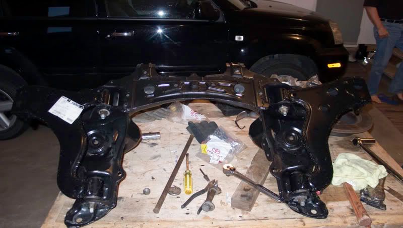

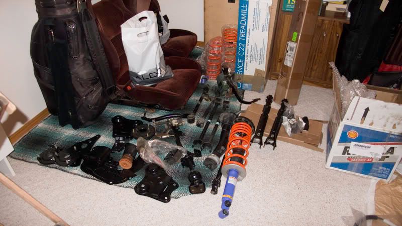

a few pictures from today:
re-finished front subframe w/new lower control arms
more control arm
mk4 rear vs mk3 rear brakes
the new parts room (unimpressive, yes...many parts are boxed)

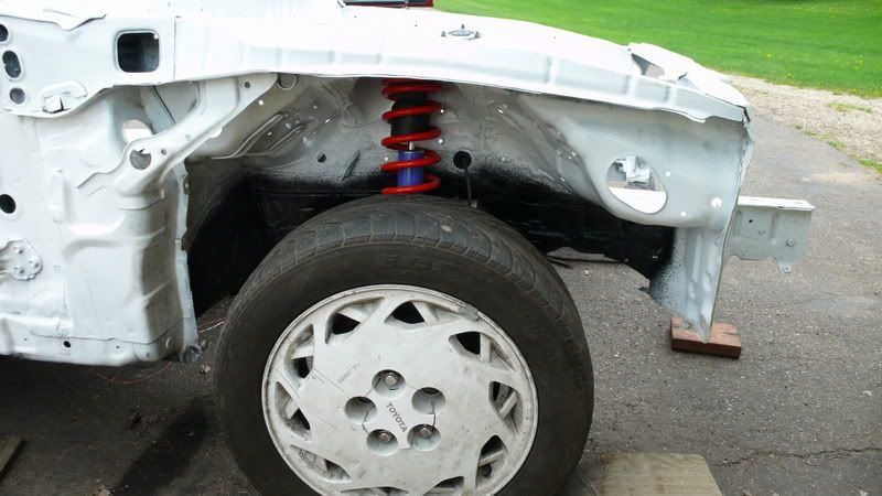

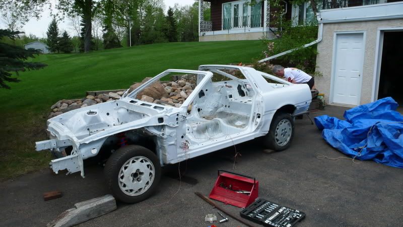

temp install of old subframes to get the car home. Pretty much just whoring these pics as I haven't really done much to the car so far. Big progress should start soon.
new springs/shocks

update: the car is sitting in my garage right now, and after some pressure washing, on go the brake and fuel lines, as well as a crap-load of wiring. Hopefully i took enough pictures when disassembling the car to know where everything goes...you forget a lot in one year.
