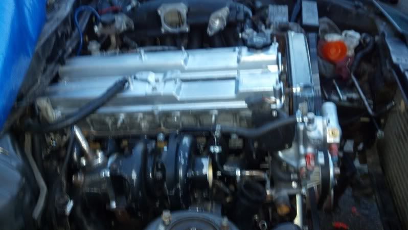

It all started with me swapping a 7mgte into a 89 cressida,
In school we had a engine rebuild course which i took the time to fully rebuild the motor myself
Polished and balanced oem crankshaft
Eagle Rods
CP pistons .20 over
All ARP hardware
Greddy metal headgasket
Brian Crower stage 2 cams with springs and retainers
3 Angle valve job
Aeromotive FPR
RC 550cc injectors
Lexus AFM
Stock Ct26

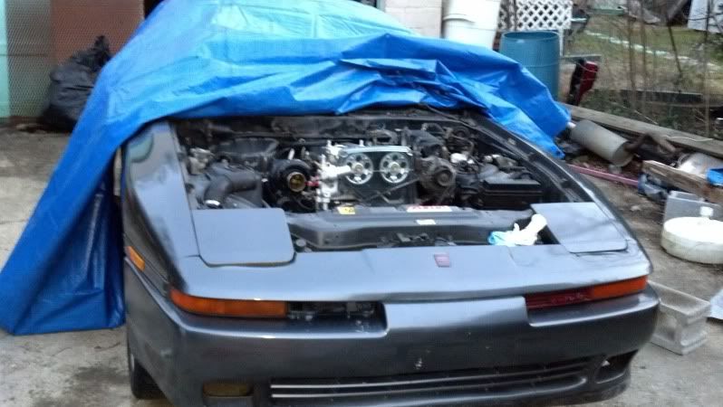

Here is how it looked about 6 months ago.
fast forward to this year:
so i ran into a couple problems, got fed up with the wiring process which i still think is really simple but i really suck at wiring. so i found a deal that i couldnt pass up. i found a 89 supra fully restored with only 60k miles for 1500

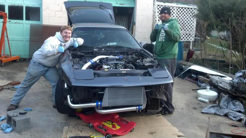

got it just about done, driftmotion intercooler installed, still waitin on my blitz exhaust, wont get here till end of march, but i guess its gonna be worth it

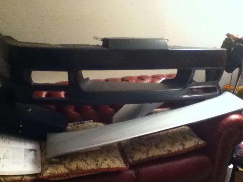

SAP Spec G bumper is gonna look good on that Supra br0. Keep them updates coming! Looks great and promising.
