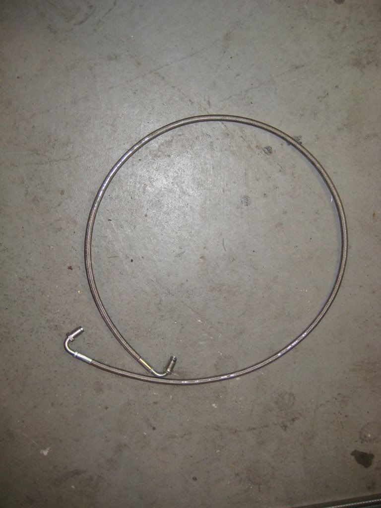

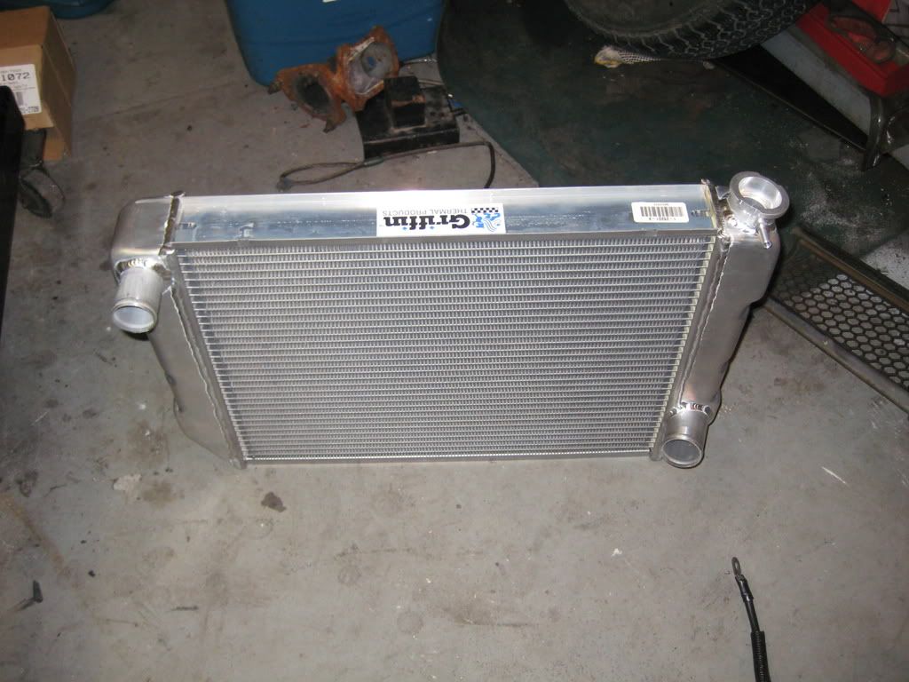

I got some cool shit in the mail yesterday
3" thick aluminum radiator(summit), braided and coated stainless steel full legnth clutch line(driftmotion), intercooler pipe reducers (driftmotion), OEM oil filter, and a few other random things.
The radiator fits pretty good, But I will definently still have to do come cutting and customizing to get it to fit right.

3" aluminum radiator
Driftmotion stainless clutch line

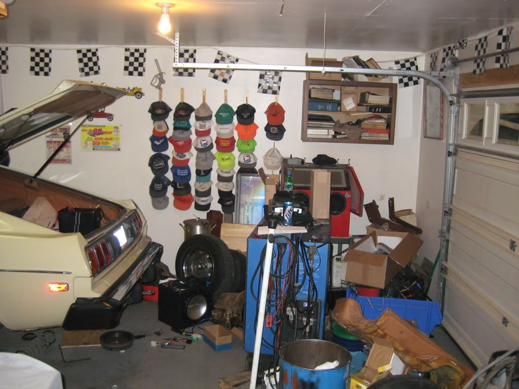

messy
relocated
mess
sfifter location worked out pretty good
