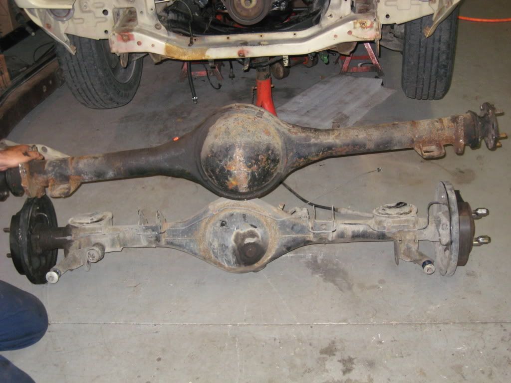

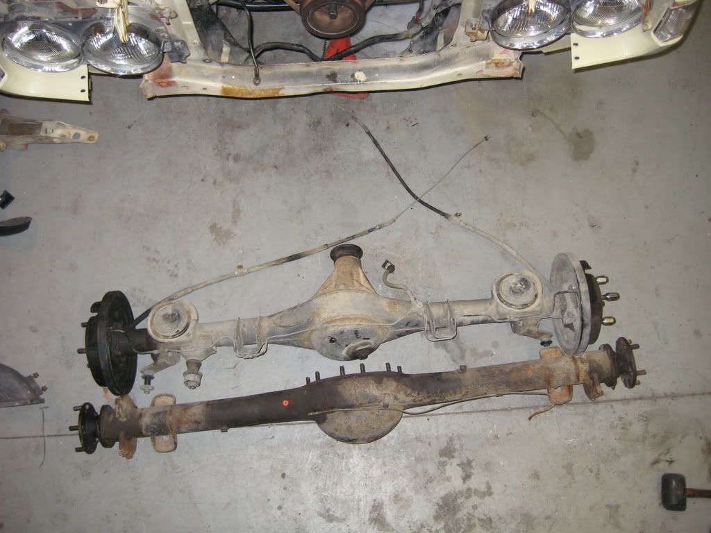

Here is a side by side of the two axles
Wish me luck swapping all those damn brackets over!
I am sure you can guess which axle is which.

Im still unsure of why you chose such a complicated route on the rear end. There are toyota alternatives that Im fairly confident would have stood up to your power goals. The F series axle from the mk1 supra (MA46) could be had with limited slip and was set up with disk brakes and 4-link. The same F series was used in the hilux/pickup as well so availability should be pretty decent. Granted it is still wider than the celica rear, but I think would have been easy to swap.
I know you had this one laying around, but all the extra work to make it compatible isnt worth it imho.
Im no expert, but I looked into buick v6 swaps into RA chassis' some years ago and this seemed like the best route to me.

I know I am making it more difficult than it could be, and I would jump on a supra or truck rear end if I had the chance at a deacent price.
Problem with living in Michigan is that all of the old toyotas have been long since been crushed or have just simply rotted away.
I could have an axle shipped from elsewhere but shipping on an axle would be redicilous let alone finding one that doesnt have a million miles.
I just keep telling myself that this axle will be worth it once I upgrade to more horsepower and bigger tires in the future.
anyone have an axle for me though?? lol
