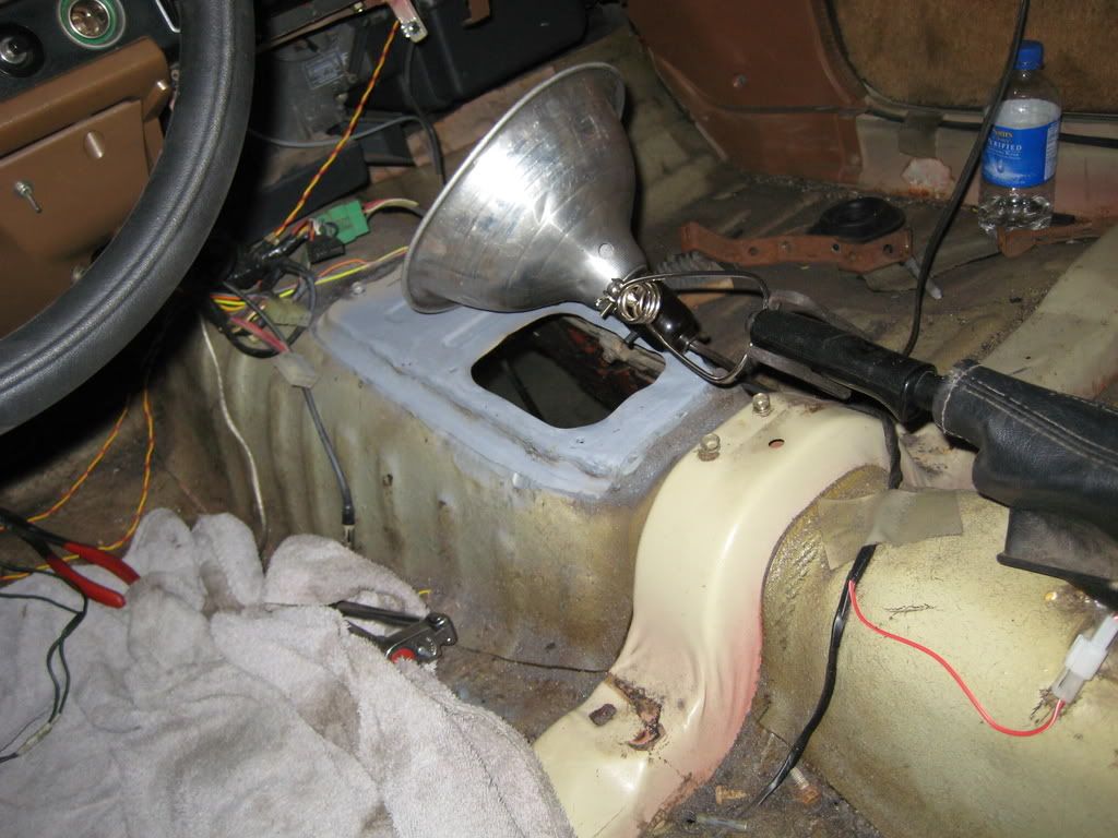

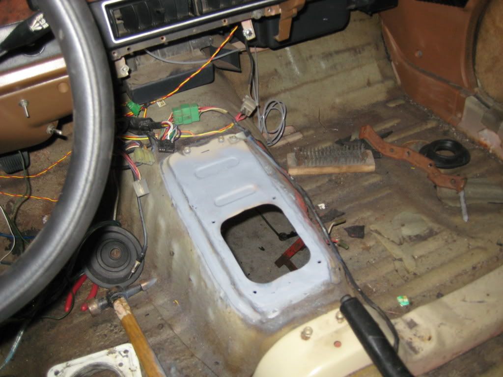

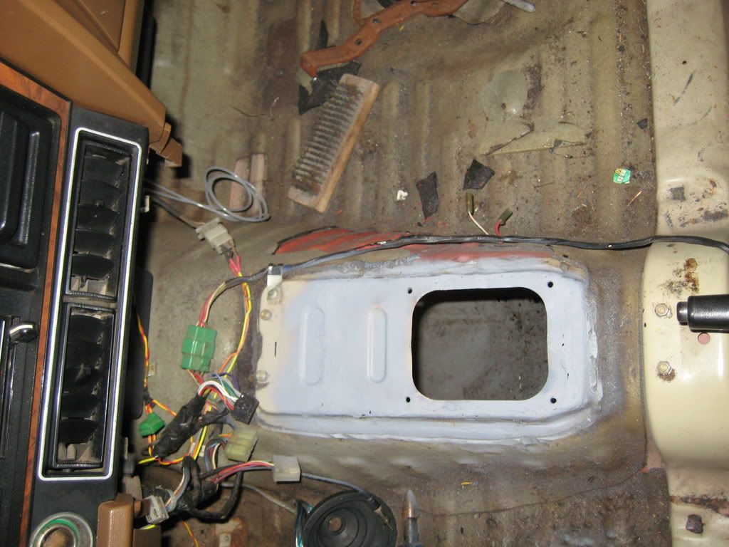

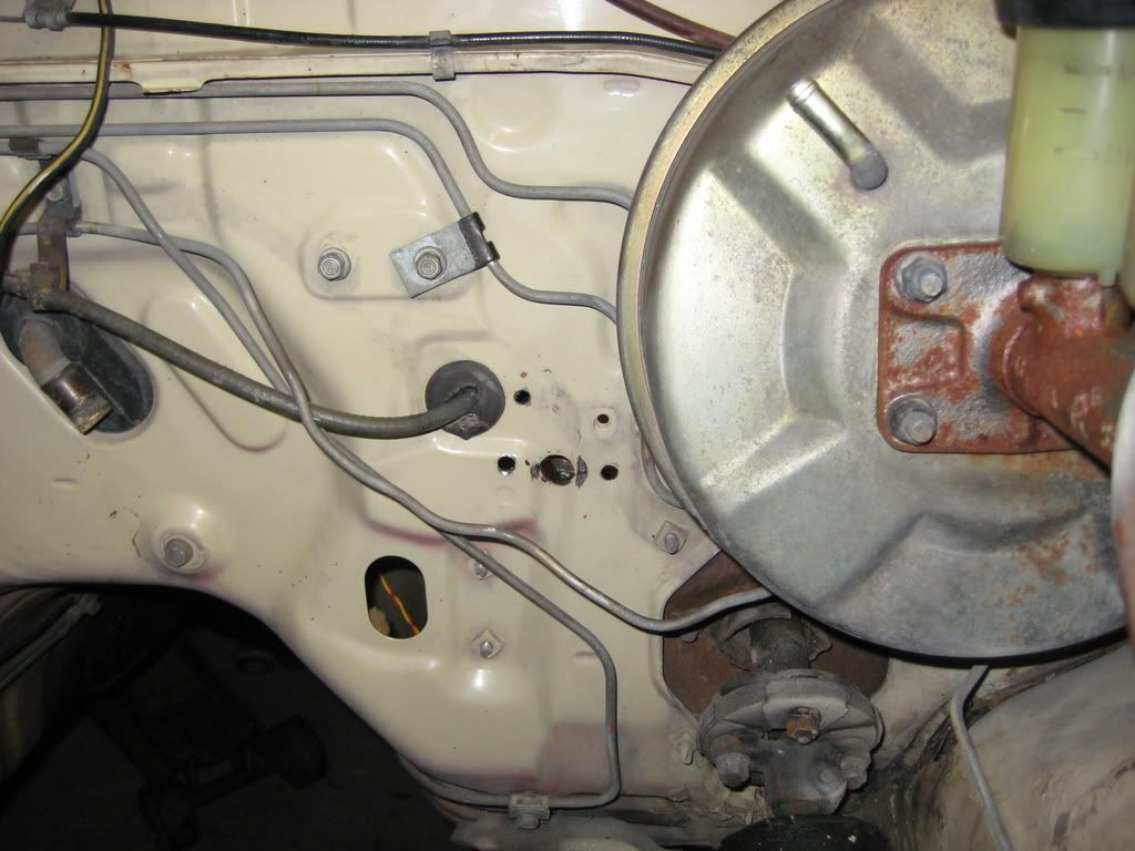

Welded the top of the trans tunnel back in for shifter location difference. And primered.

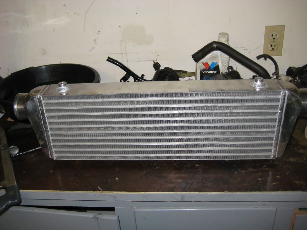

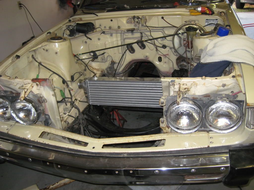

I got my intercooler.
I think its 28x8x2.5 and 2.5 in and out
It will be a really tight fit if i can get it behind that damn ugly bumper

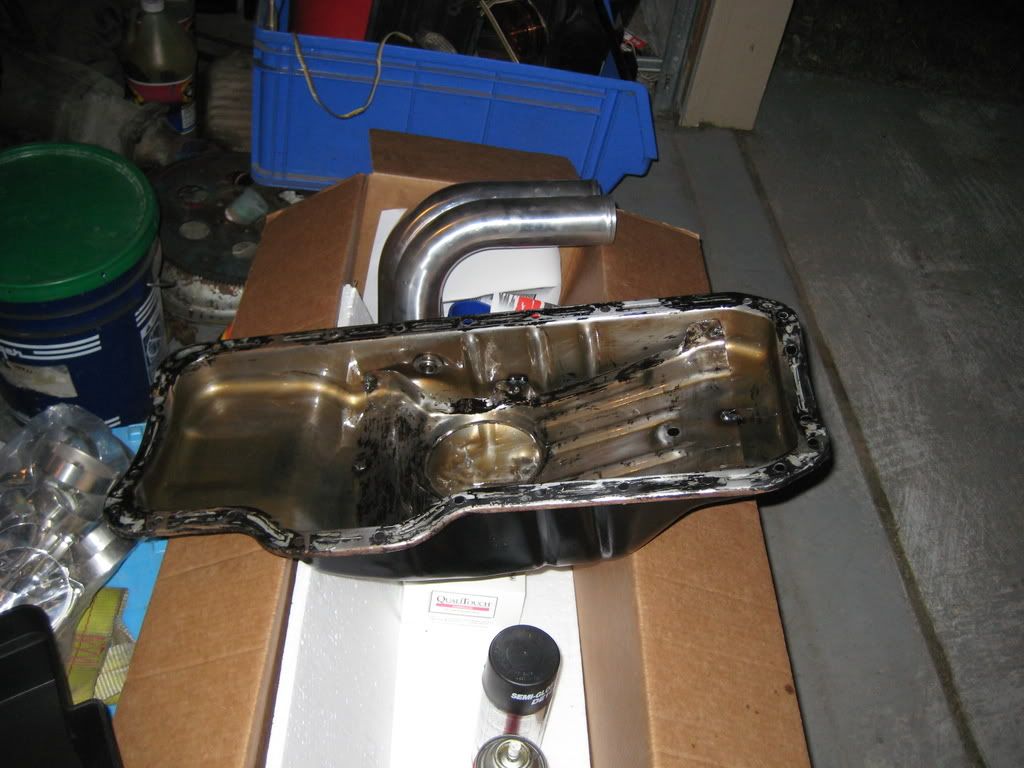

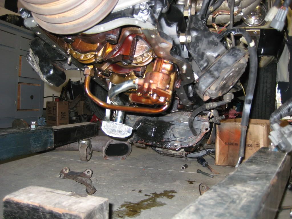

new oil pump pickup
Did some repair work on the oil pan, then welded the baffle back in and painted

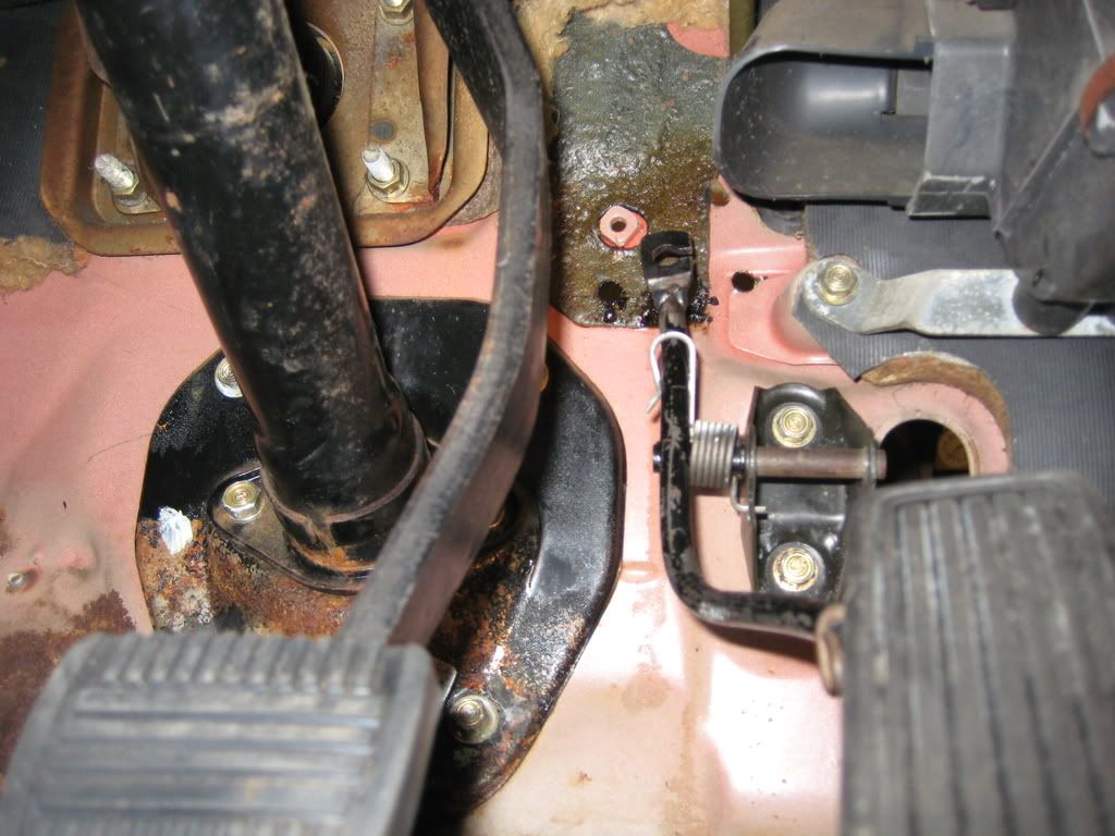

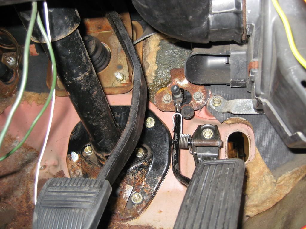

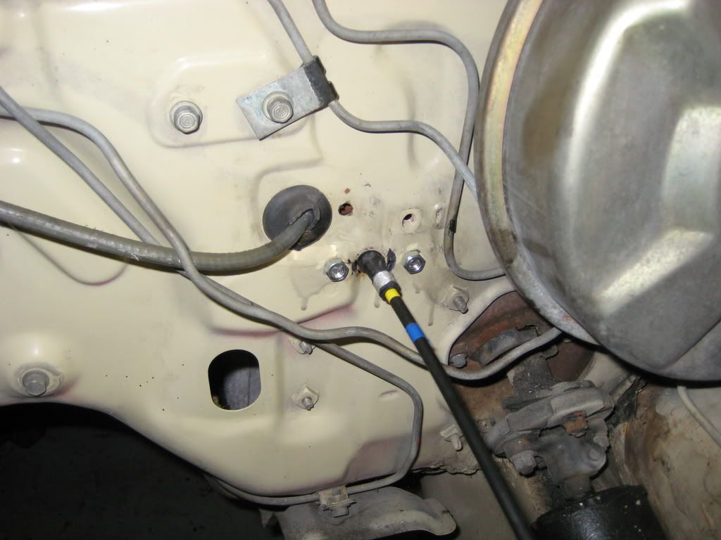

I set up the throttle cable and new gas pedal, had to cut out about 4 inches off of the supra pedal becasue the throw was too long after being bent to fit in the car.
works pretty good

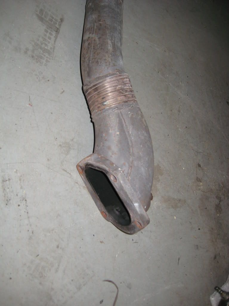

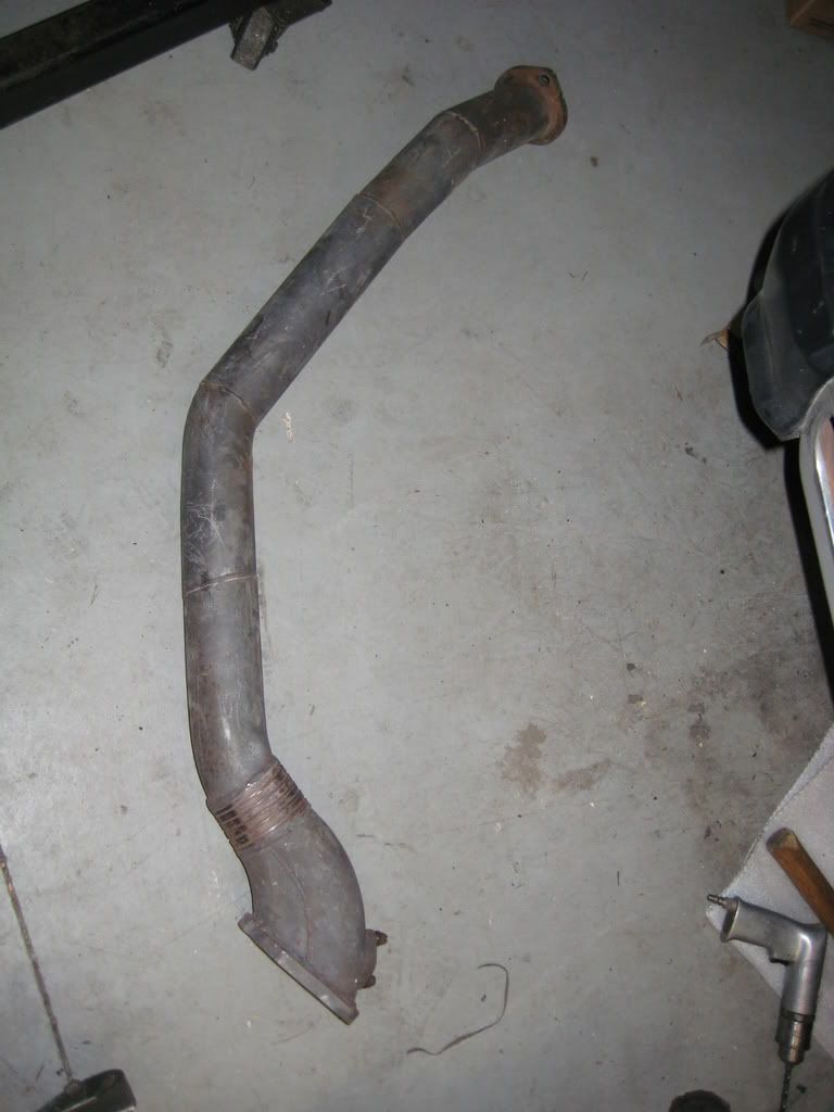

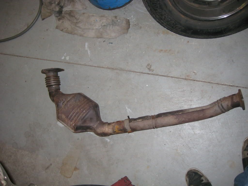

I purchased an aftermarket Cooleeze Downpipe from a member on another site.
Here is a comparision from the stock to the aftermarket, it fits wayyyy better than the stocker did.
stock
Cooleeze

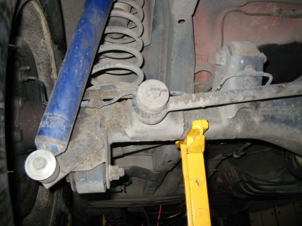

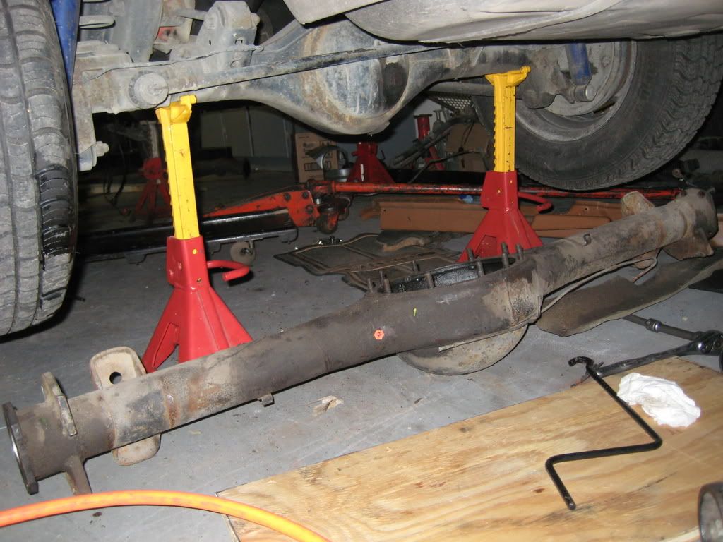

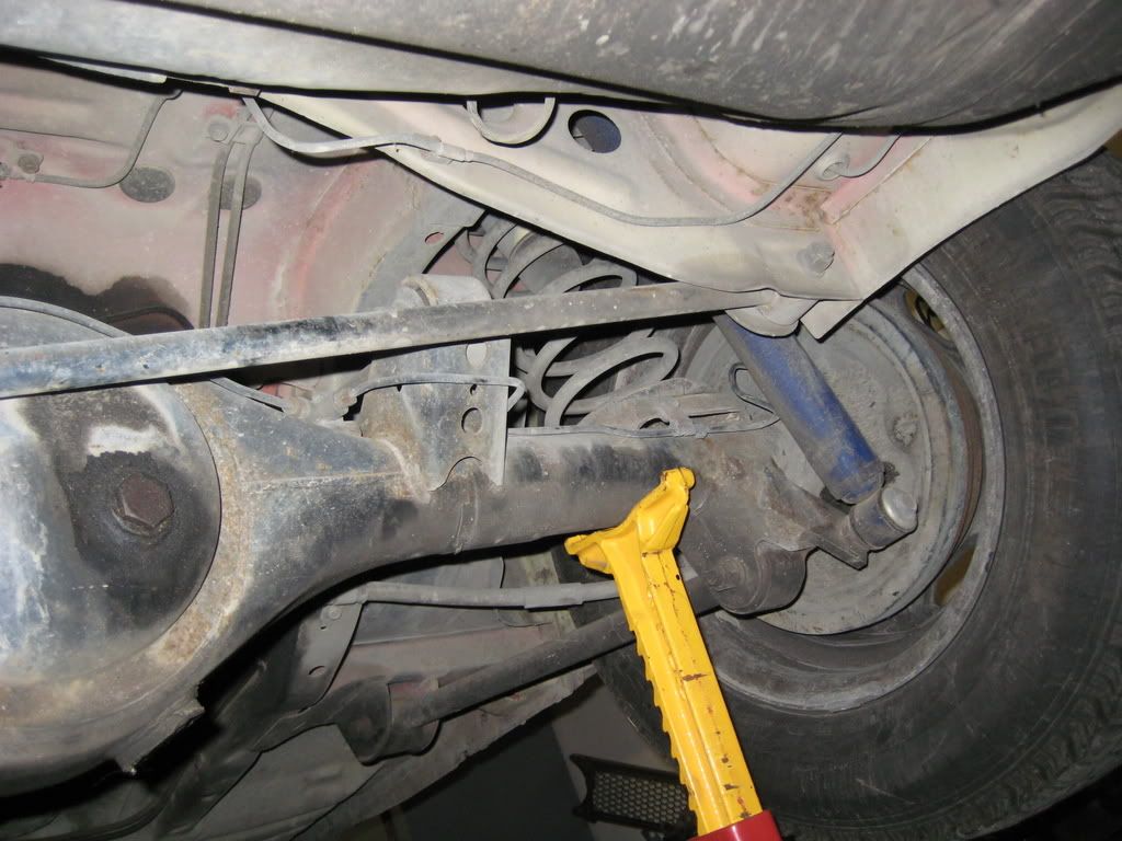

I am getting ready to pull the axle and starting to do some cutting on the brackets. there are a SHITLOAD of them, yes, yes it is going to suck
The replacement going in is sitting under the car.
